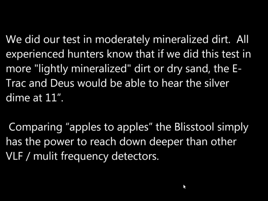

  • Daniel, I just got a Deus a week ago. I'm not concerned about which is best between Bliss and Deus. I only got into this discussion based on what I considered an improper comment of detector theory. But I have some concerns about your friends settings on the Deus.
    First I have found in my "mild" soil that G-Maxx and Relic modes are deeper than GM Power.
    I would have liked to see how it performed with Tx power at 3 and running at 8khz.
    I don't know if it would improve the results but I'm not sure the Deus was given an opportunity to perform at its best. Also the sensitivity could have been set higher but it can get chatty at those levels.
    All this said, maybe someone can explain how this thread for the Blisstool V3 become a comparison to the Deus?
    I think they are like comparing apples and oranges.
    Thank you for that great video.
    • I'm the one that wasn't that educated on programming the Deus. My buddy has had it since it came out in the US, and before that, he ran the GMP detector from XP. Our soil here in certain places, is not mild by any means. What works well in mild to benign soil, usually doesn't work well here. We did try the different frequencies though to see if it made much of a difference, and didn't really see one.
      The video wasn't done to put the Bliss against the Deus. This was actually to see how the Deus and Minelab CTX 3030 handled the hot soil. We were supposed to have another guy show up with a machine we all knew very well...to be used as a flagging detector....one that would go ahead and mark signals that we felt confident were bullets...and then to break out the new machines to see if we could set them up to achieve a signal on the targets before we dug them. It rained all the night before, and was raining when I left that morning as well. We waited out the rain showers and went hunting. Our flagger guy didn't want to come due to the rain and thus I brought the Blisstool along.
      We couldn't get the CTX to acknowledge a single bullet in our testing...despite both of us having extensive experience on the Explorer-eTrac platform. We got it to read all iron on one of the shallower bullets but most of the time nothing...running open screens in disc pattern and such.
      The Deus was then the one of interest...I was truly impressed with it, although being a specific use machine for me....i.e. the extremely loaded with iron sites, where depth is not a major concern. Just it having the bonus ability to work decent in hot soil was a major plus for it.

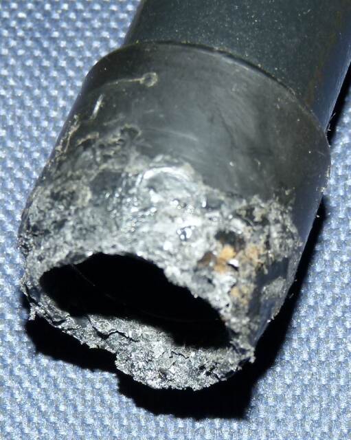

        In the last week the plastic-connector finally broke off, and any other Blisstool may get the same problem sometimes.
        Now I "soldered" it completly together - no problem just to stick the alu-pole directly into that connection-hole. If it doesn't fit tight enough solder some gum or rubber into the hole or use glue or doubleside-sticking tape. This upper plastic-screw is completly overfluous anyway.

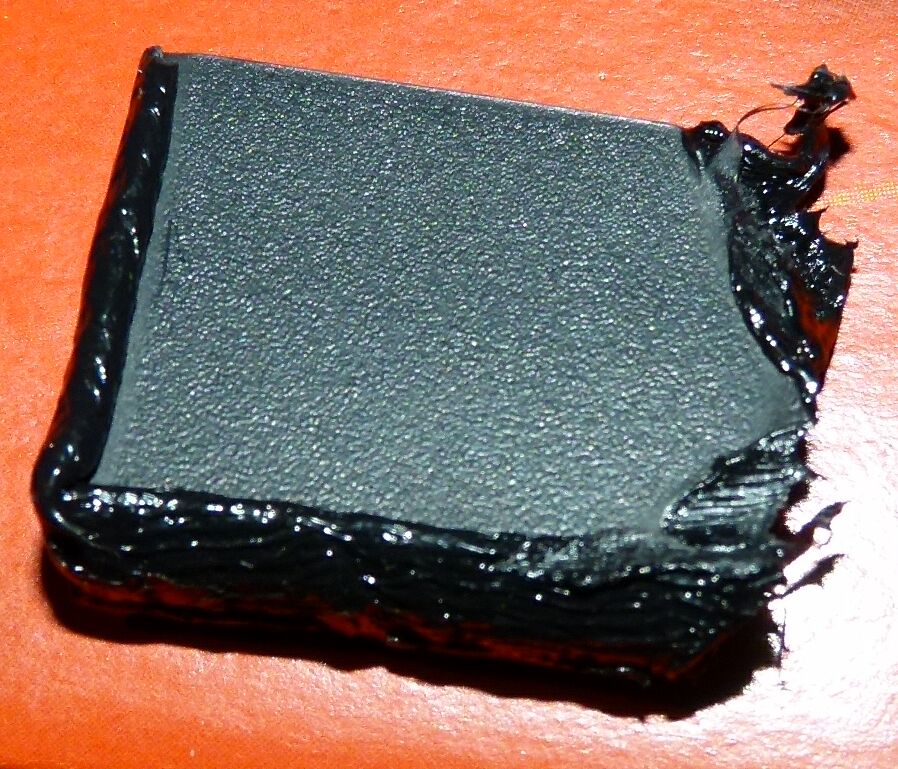

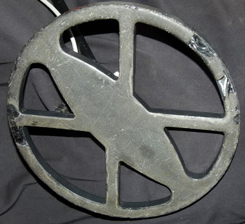

        • coil issue
          No more replies?
          OK fine, but I have a new one:

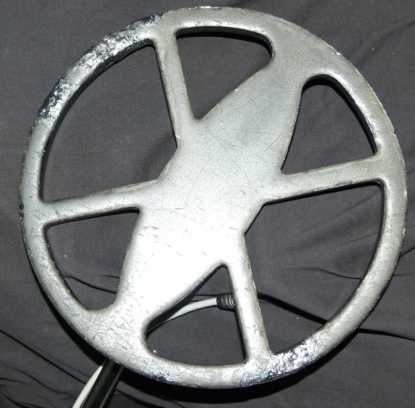

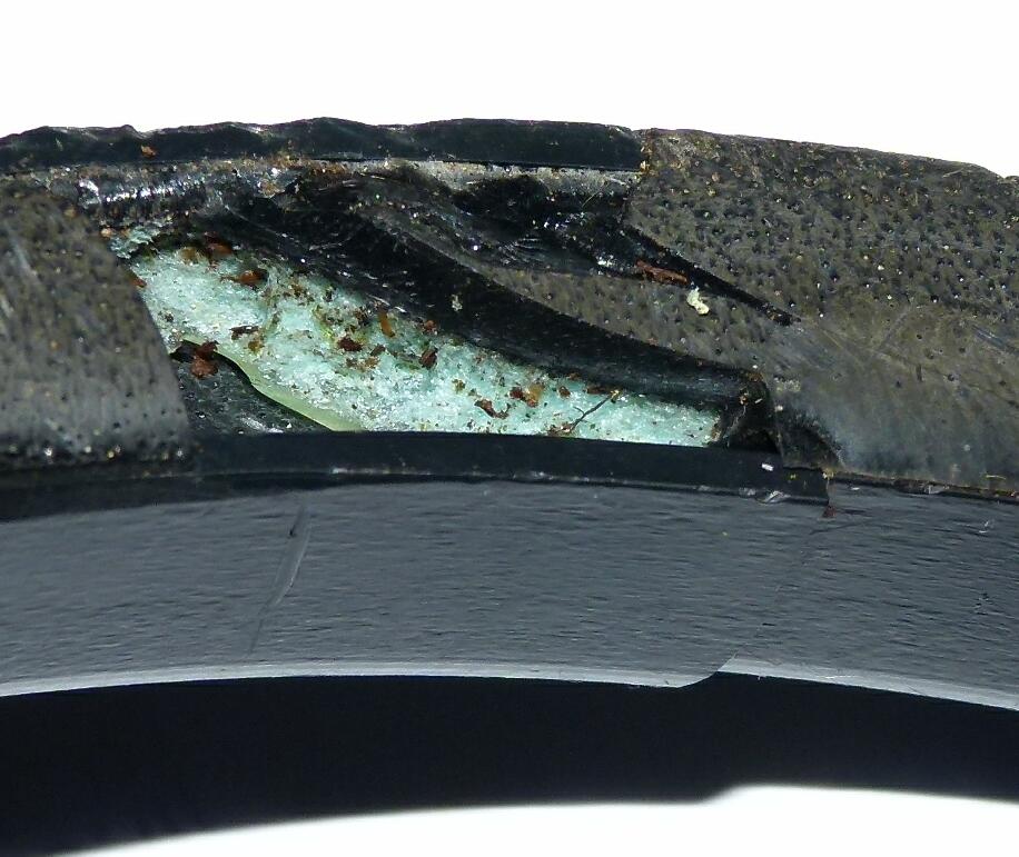

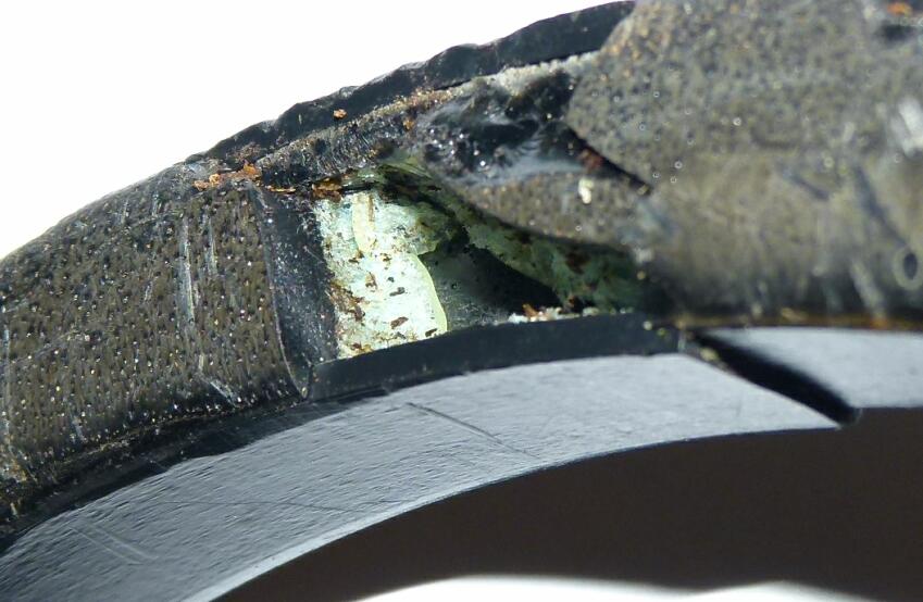

          If you ever wanted to look inside the Blisstools coil - here you go!
          All of a sudden it got a crack - perhaps I hit a rock or something.
          Anyway - it's not fully broken, just cracked on one side with a
          little hole in the bottom that doesn't reach the coil-wires.
          The windings are located ca. 1cm above the bottom -
          a waste of sensitivity. There is some layer of blue foam gum
          to save the more expensive epoxy inbetween.
          I don't give you this information for stupid statements like:
          "Hahaha, I always knew the Blisstool is crap" etc. but to
          show an authentic and realistic picture with all facettes.
          And coils of good detectors also can get damages.
          The coils-housing plastic always is a compromise:
          If it's too brittle, it will break more easily, if it's to soft,
          the coil starts to give failure signals while even softly touching
          something (as it is at the moment the case with the Blisstool).
          The best solution is using hitec syntetic material and no cheap
          china poison plastic mixture but of course this will cost extra.
          Plastic is not plastic - there exists many differences.
          At least Blisstool should provide a fitting coil cover and construct
          this coil in a way so there is not amost 10mm of distance lost.
          I thought already to upside down this coil but it's not worth
          the effort to change the pole connector, the coil-cable etc.
          For me this crack-breaking is no problem - even hunted yesterday
          the half day in that condition. Melting with soldering iron the
          plastic together and fill the hole also with plastic and perhaps using
          some windings of duct-tape or whatever and the coil will be fixed.
          But of course it is work, it is annoying and for persons without
          technical skills it may lead to alot frustration or even to the loss of
          a functioning detector.
          So as a precaution tip better at least wrap some rounds of strong
          tear-resisting tape over that coil.

            • Thx barryny for your generous offer but it is really no problem.
              This is the 11'' coil (28cm) from 2010 (or perhaps 2009) and
              material wears out after some time of heavy use.
              You can say it was my own fault and so I also will fix it.
              I guess I have still some warranty time left but I won't need it.
              The coil wasn't used very cosy and the box was already opened
              for the additional accu-pack mod you can see here:

              • everything fixed!
                I like plastic-surgery!
                And the soldering iron has the perfect temperature for this...
                But such things really must be done in well ventilated rooms.
                And use the right plastic material - it must mix and stick well
                together with the stuff you wanna repair, close or whatever.
                Therefore save all kind of plastic garbage in a little box -
                sometimes it could be of real good use.

                            • Here my newest very small Blisstool find - 3mm nail at 8cm (4cm wet earth and grass-roots and 4cm plants above) with 28cm coil.
                              The coil repair was a full success and I found this "nugget" at a location with even medium strong electro-smog nearby.
