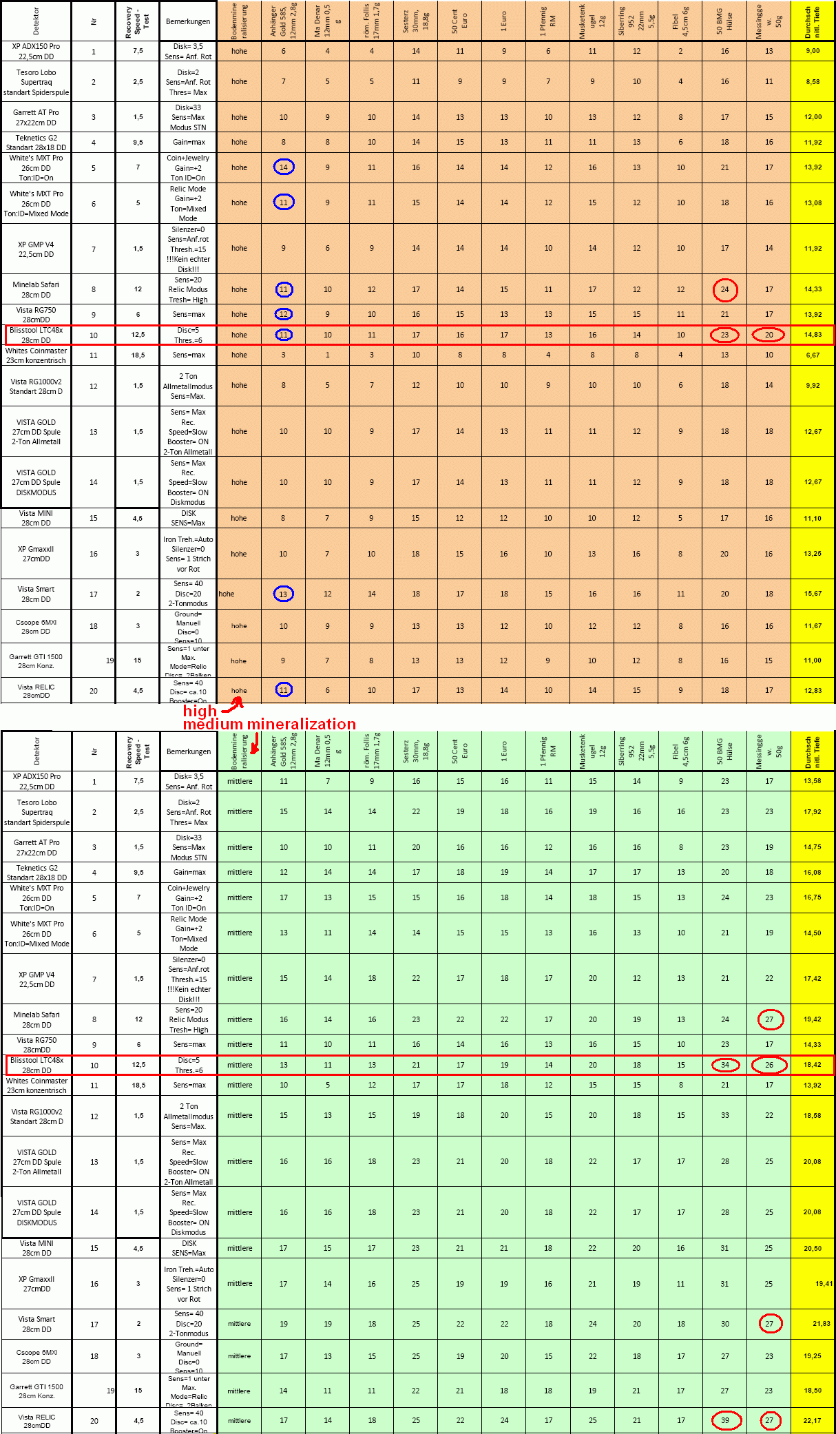

  • Here's a new good test from Germany done by trustworthy persons
    and under realistic conditions.
    Of course the Blisstool with the not small 28cm coil is only average to
    detect the little golden pendant (left side) but it has very good or even
    the best depths with a 50mm round from WW2 and the 50g brass weight.
    The setting was Disc 5, Threshold 6 but this is just around 50% of full power.

        (Above) the 3mm iron nugget info - without high voltage line depth would have been alot better.
        The video with my little stuff Blisstool airtest should be earlier somewhere in this thread - but there
        was also alot electro-smog around. The new test-chart above shows the Blisstool performs well
        or better in heavy mineralization compared with other detectors.
        The "röm. follis" (little roman folli copper coin) above is the best item to compare with a gold nugget.
        The "Ma Denar" (medieval Denar) is even smaller but I don't know the metal, perhaps it's silver.
        btw. I see the Garrett GTI 1500 with standard coil (28cm, too) has almost the same little stuff depth
        as the Blisstool as long as it is medium mineralized soil, not in high mineralized soil. Another proof
        the Garrett will do a good job in gold prospecting as long as it uses a small enough coil and
        without electrosmog and hot ground! I have this standard coil too, but never used it so far.
        And the new Garrett Euro Ace for 300 Euro with 28cm DD coil also will detect very small things -
        under good site conditions - I found allready some piece of thin wire 1cm lenght at 5cm depth.

            • The big advance of the Blisstool is the possibility to create a huge contrast factor near the ground
              elimination level where also the low conductive nature gold is (as long as it's not a gold-silver electrum mixture)
              That's why it performs so good in high mineralized soil, too, compared with "fixed" detectors.
              For a 28cm coil the 1gram gold tests are absolutly astonishing - the LTC 64 v3 is really a big improvement.
              Of course for the much smaller Garrett AT Gold PROformance coil such 15mm gold pendant
              looks much bigger than for an almost 30cm coil and we must not forget that a smaller coil is
              much more safe from interferences of all kind. As example the 10cm Garret sniper coil creates
              no e-smog beeps at all, at full sens and very close to strong erratic-noise-sources. Nothing.
              This is important to understand that smaller coils are much more stable and therefore sensitive
              to detect even very tiny stuff compared with larger coils. Static circuits also remain almost
              completly stable and without noise compared to all those motion-circuits, but the later are
              more sensitive and easy to handle at sites with bushes, grass, stones and other stuff.

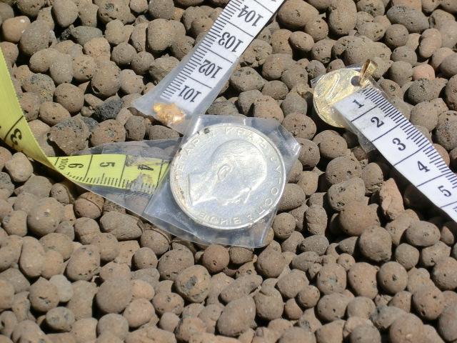

              If the test was made inside of that big plant-pot I'm not shure if those mineralized stone stuff
              there is realistic enough. Ground usually is much tighter and includes some level of moisture.
              Guess the granules are made from clay so it may work as medium mineralized soil substitute
              because of all the air inbetween.

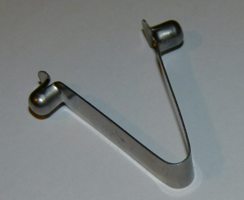

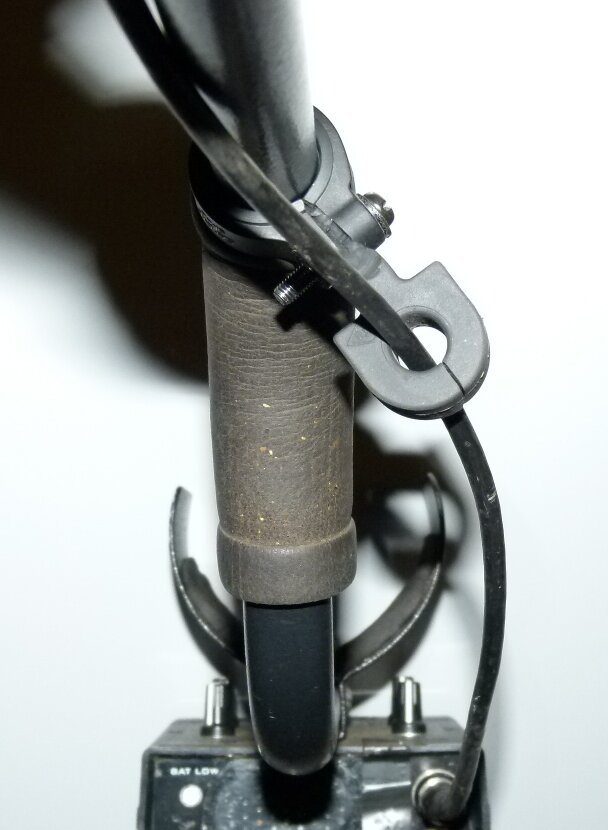

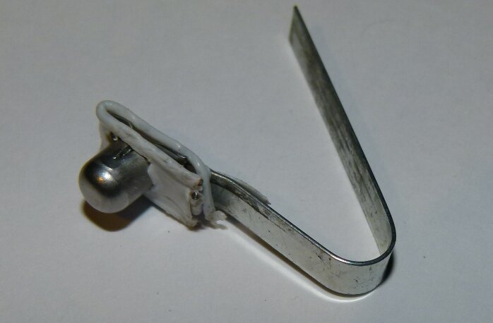

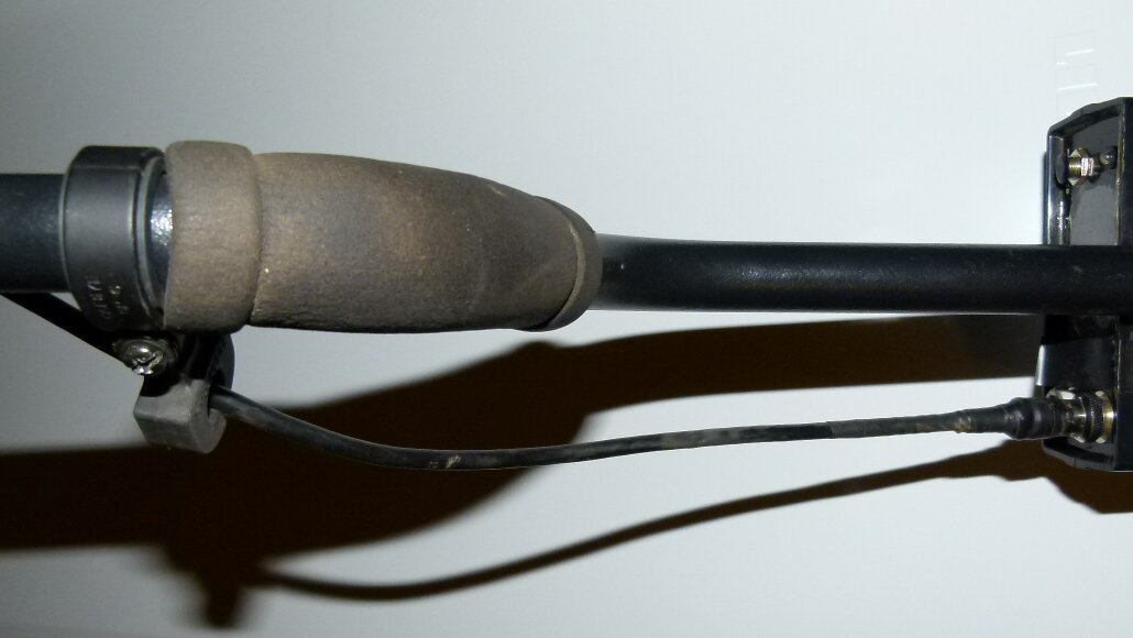

                  Another important and easy to realize improvement is the coil-cable distancer.
                  The full thread is here:
                  Here's the final solution and it's much better now than without that distancer:

                              • Today tested, the new positioned coil cable distancer works perfect
                                and every Blisstool should be equiped with it.
                                I hope this is now the final "repair" but it was necessary:

                                Below you see the Garrett snaper - it will not break.
                                For the lower part of the stem you have to nip off
                                one of the round thingies otherwise it doesn't fit into the hole.
                                And: I'm using now also a second snaper in the upper
                                part of the stem - this gives much better stability.
