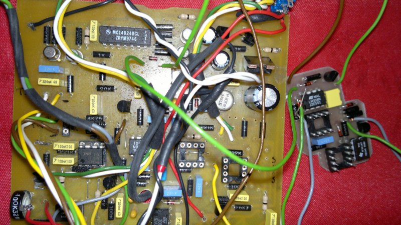

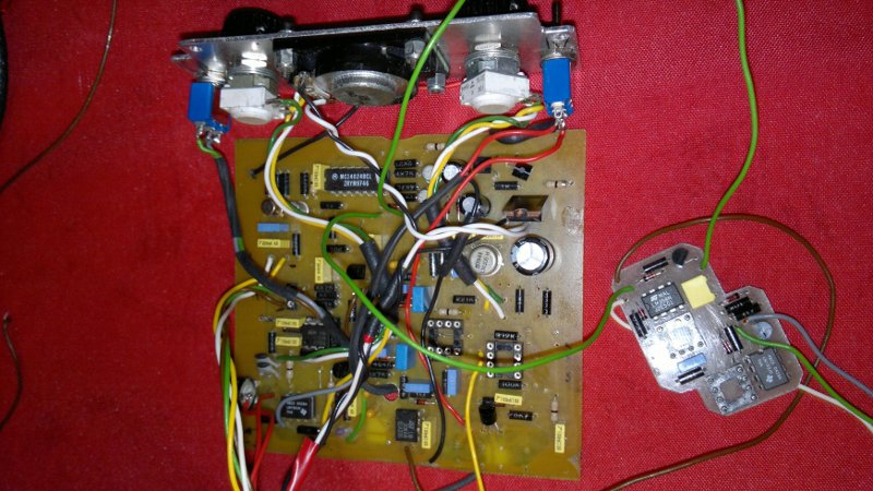

      • Hi, I tried the version reverse since the standalone version still does not work and result even failure. When I switched to the right or to the left I have a permanent tone or silence. the all metal switch / discrimination is cable as originally and is put in position all metals when I do the test . help
        • Hi, I think I will remove the card and restore all the original on my TGSL components. the multi-tons mode is not air to operate either in standalone version or the other version, my malfunction persist despite that I think my cabling is correct. That being said a small doubt on point B to be connected on the switch and the 2 cards. Damage this additional service me interested strongly.But my limits of convenience store are right for me and I am apparently not able to find why I have this defect.
          • You have to see if your circuit TGSL without the 2-tone module is working. If everything is correct, you add the module of 2 tones.
              without the card tgsl my work properly. I tried with two types of multi-toned card and it creates me the same failure. multi-tone and nothing at all metals constant beeping.
              • I think the problem comes from improper connection of the switch. one terminal of the switch is not connected. Or some letters are not connecting to the right place.

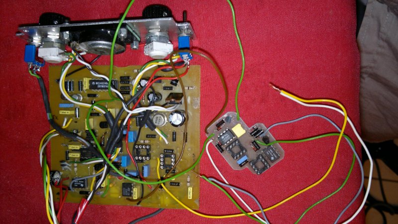

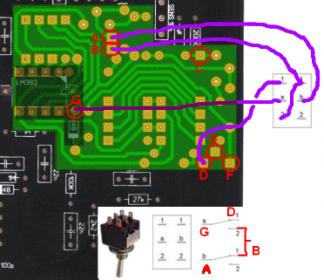

                • Hello, es so that someone can confirm that the cabblage are good, because it makes 2 times that I cable and a failure every time. Unless it add or remove wires on the motherboard.
                  hello, are what someone can confirm that cabblage points are correct on this mod. because this time I made ​​two cable this little card on the tgsl and it does not work. are there any son has line-out on the main motherboard? thank you

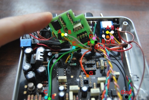

                  • Here is a picture of my (very well working) detector.
                    I have labeled and colored the wires.
                    I can't be more accurate.
                    Have you noticed that the addon board is mounted upside down ?
                    Hugo
                    • hello, yes I did see that the card was upside down. points are identical. what I was wired. double switch for me has two positions, then AB and GD GB 2 other points being in a vacuum. I have removed the components red cross 9 total. by cons I have no shunt below the motherboard.

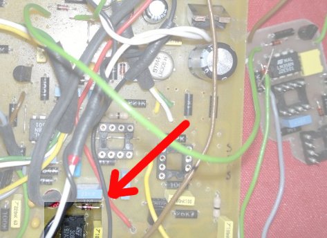

                          • @Nico:
                            Can you confirm this AOP is a LM308 ?
                            If so put the 100pF capacitor back or use a TL081 instead.
                            Wrong, G point is connected either to point B either to point D.
                            Right, with the piggyback board, you don't need no more link.
                            regards,
                            Hugo
                            • by returning the capacitor 100p a part of the detector operates again by switching the position inrrupteur AB and GD connected connected the detector works but I have only one tone and some discrimination no longer seems to work. When in position and connected GB A and D in a vacuum I have no sound.

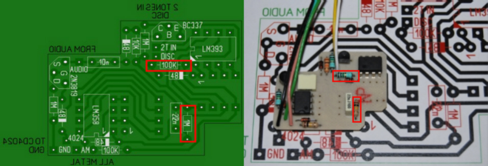

                                Hello, I want your opinion on the photo below we see that two resistors are reversed on the picture from the pcb, or is the error? on the pcb? or on the picture?
