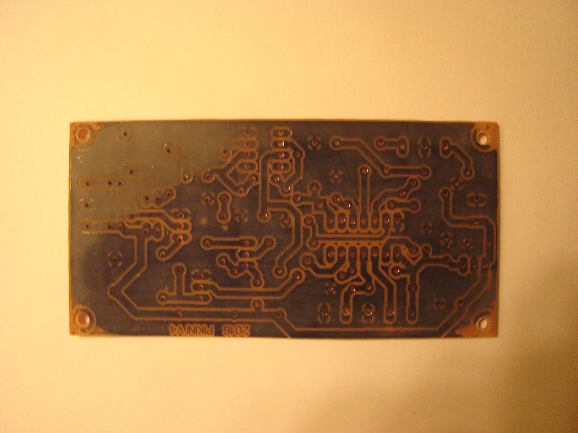

        • This is my Pcb.........Thanxs Mister F117

                  • Look your photo...............
                    And Look My photo..
                    • Ya arionas thats a joined track, pin 8 and 9, its similar with yours.

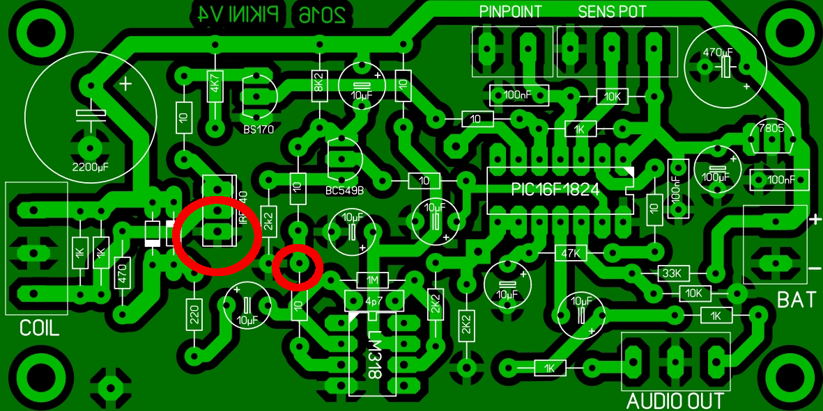

                      • There are a number of points in your PCB layout where the ground plane is almost touching other points:
Name:	pikini v4 2.JPG
                        Do you have a flyback pulse every 2 ms ? Check that the IRF740 is not shorted at the points indicated.

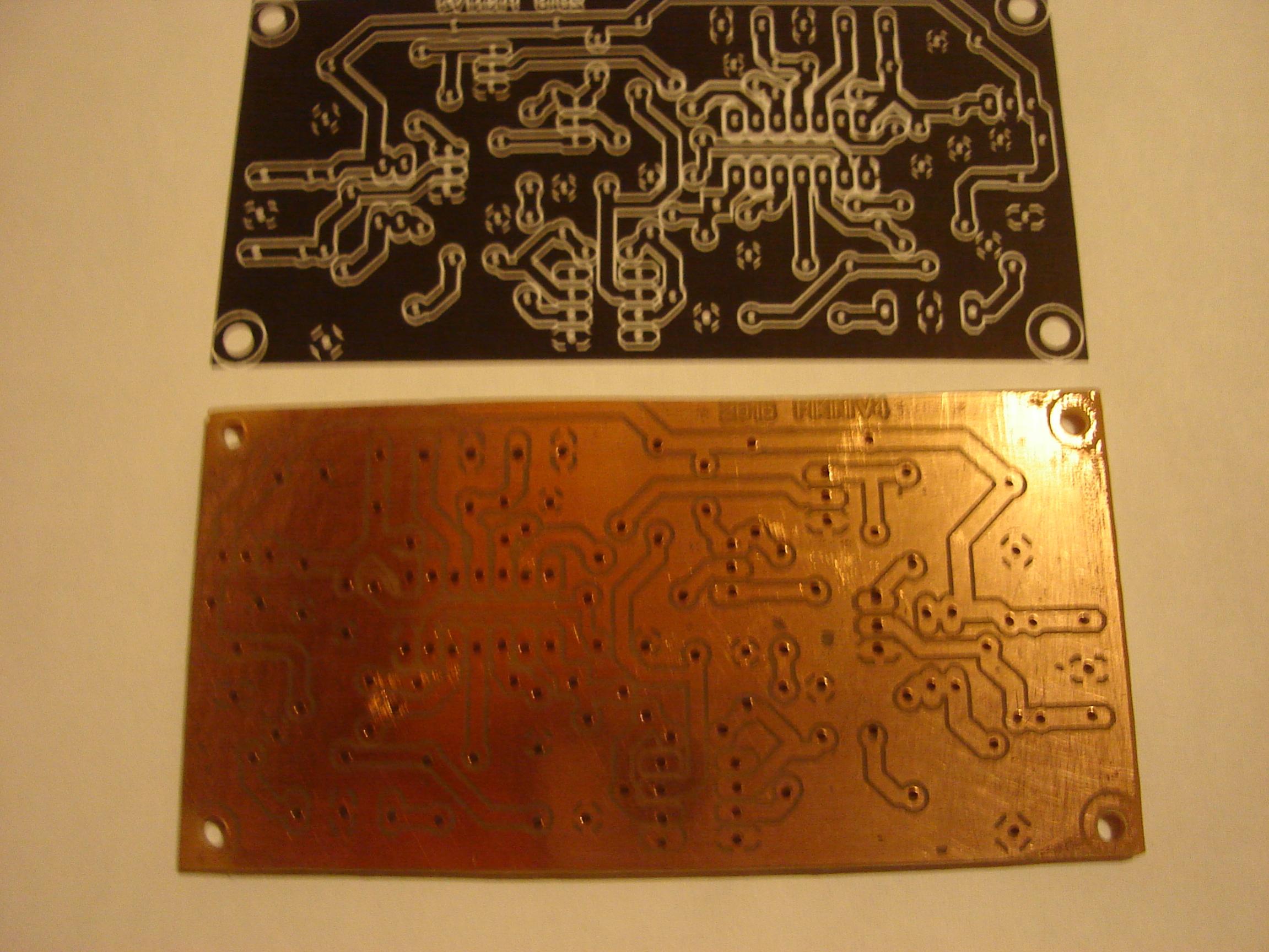

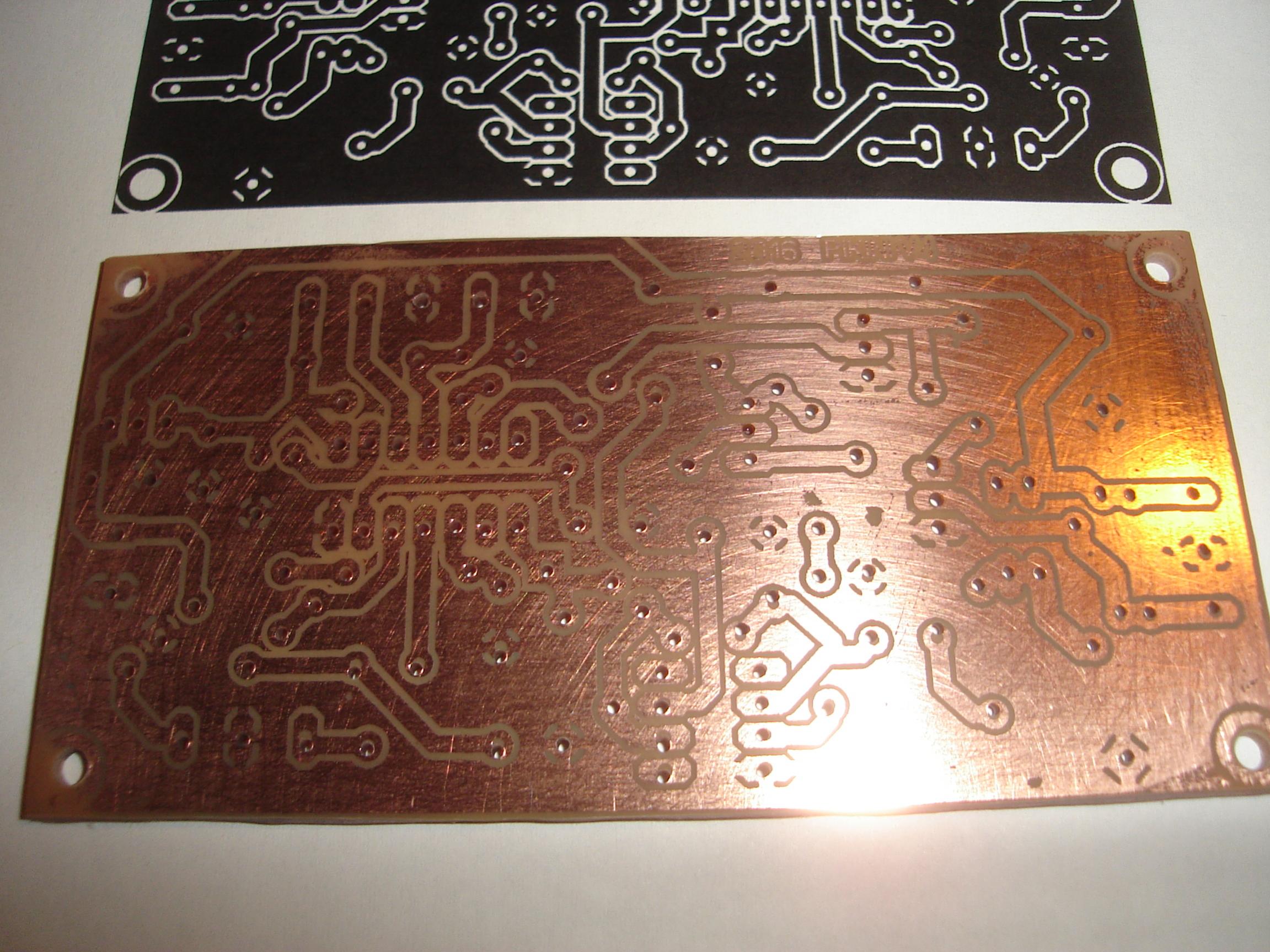

                        • My attempt at pickini V4
                          Anxious to get workin on this project, still waiting on some parts and my chips but in the mean time got my board done and ready to go. Not to bad for my first try at doing my own board... Great thread and lookin like a great project...
Name:	1 Pickini V4.jpg
Name:	2 Pickini V4.jpg
Name:	3 Pickini V4.jpg
                          Sorry, not tryin to hijack the thread, just interested in this project so figured to post in here.

                          • Originally posted by F117 View Post
                            [ATTACH]37818[/ATTACH]
                            No short at all, here is the hi res pcb back, im messing my pcb with full tin, but not get work either. How to check i have flyback?

                            Nice & clean board, but i think you need to short pin 8 and 9 pic legs

                              • Originally posted by ripsdevala View Post
                                Hey thank you. Yep, I caught the pin 8 & 9 short so will do it when I solder the socket, thanks for the heads up though, much appreciated.
