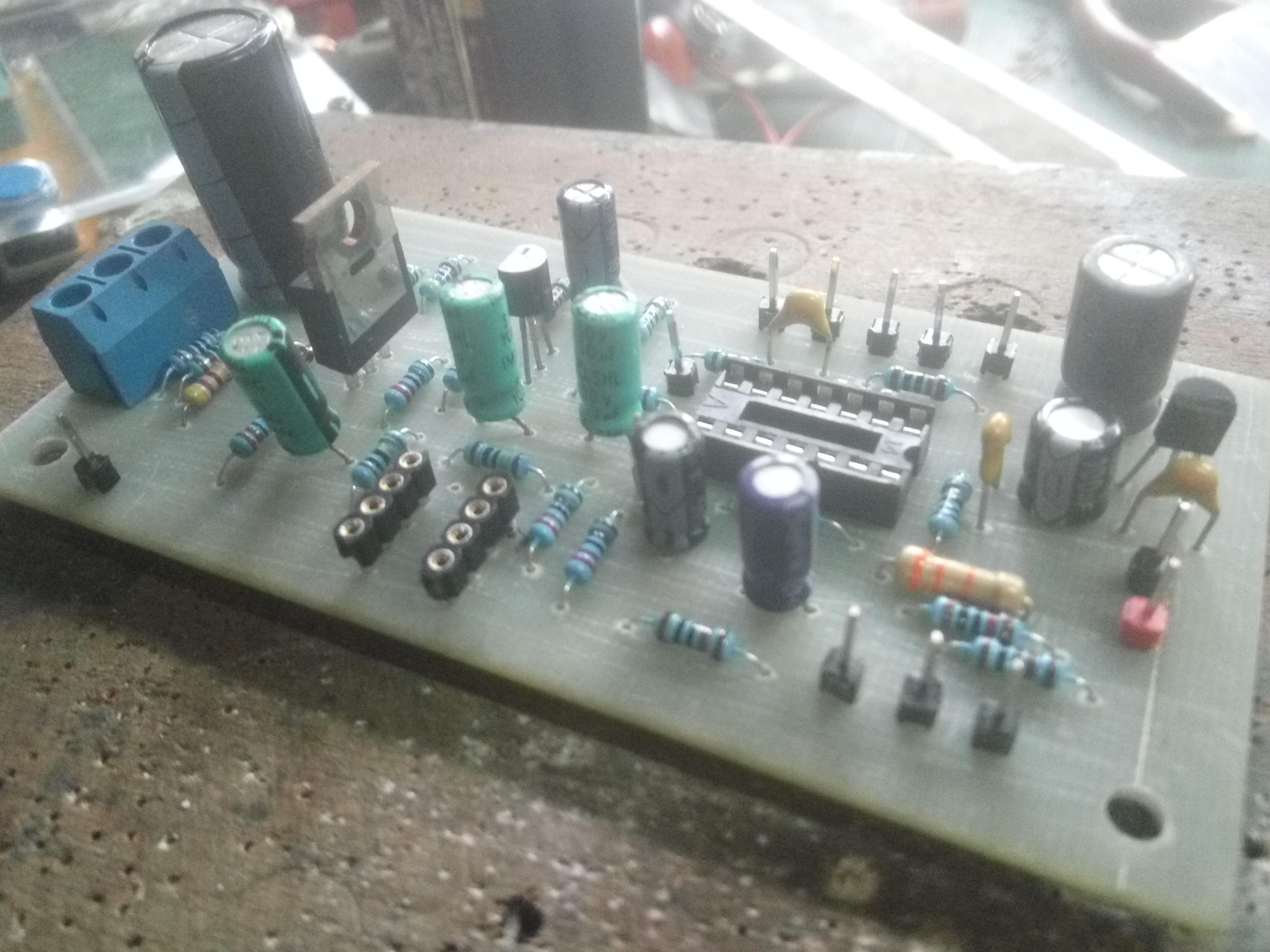

              3 parts remaining
              • Nice work, keep us informed about test results !

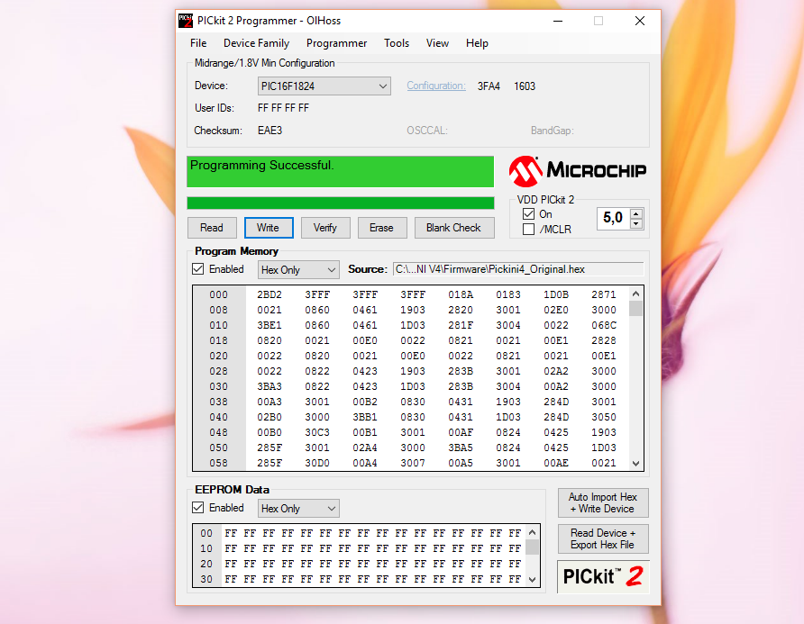

                • So I've got all parts but the Pickit3 programmer. Didn't want to wait so I used Pickit2 to program the chip.
                  Since the PIC16F1824 was missing from the list of supported devices I tried to update the list (here is the new file list).
                  Pasted it as C:\Program Files (x86)\Microchip\PICkit 2 v2\PK2DeviceFile.dat (keep the original one too, just in case).
                  And it worked!
                  • Nice hack / reverse engineering, Eclipse

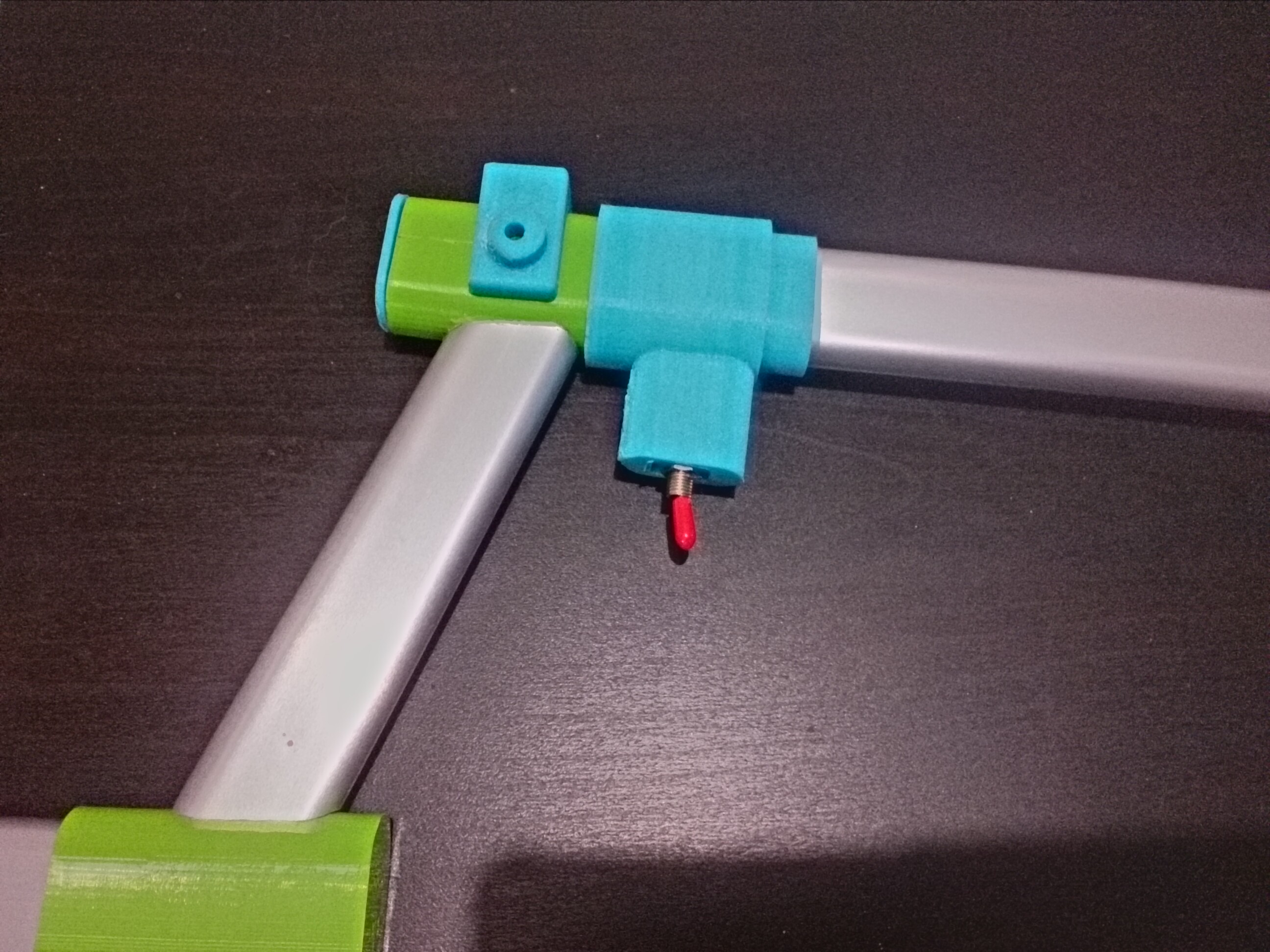

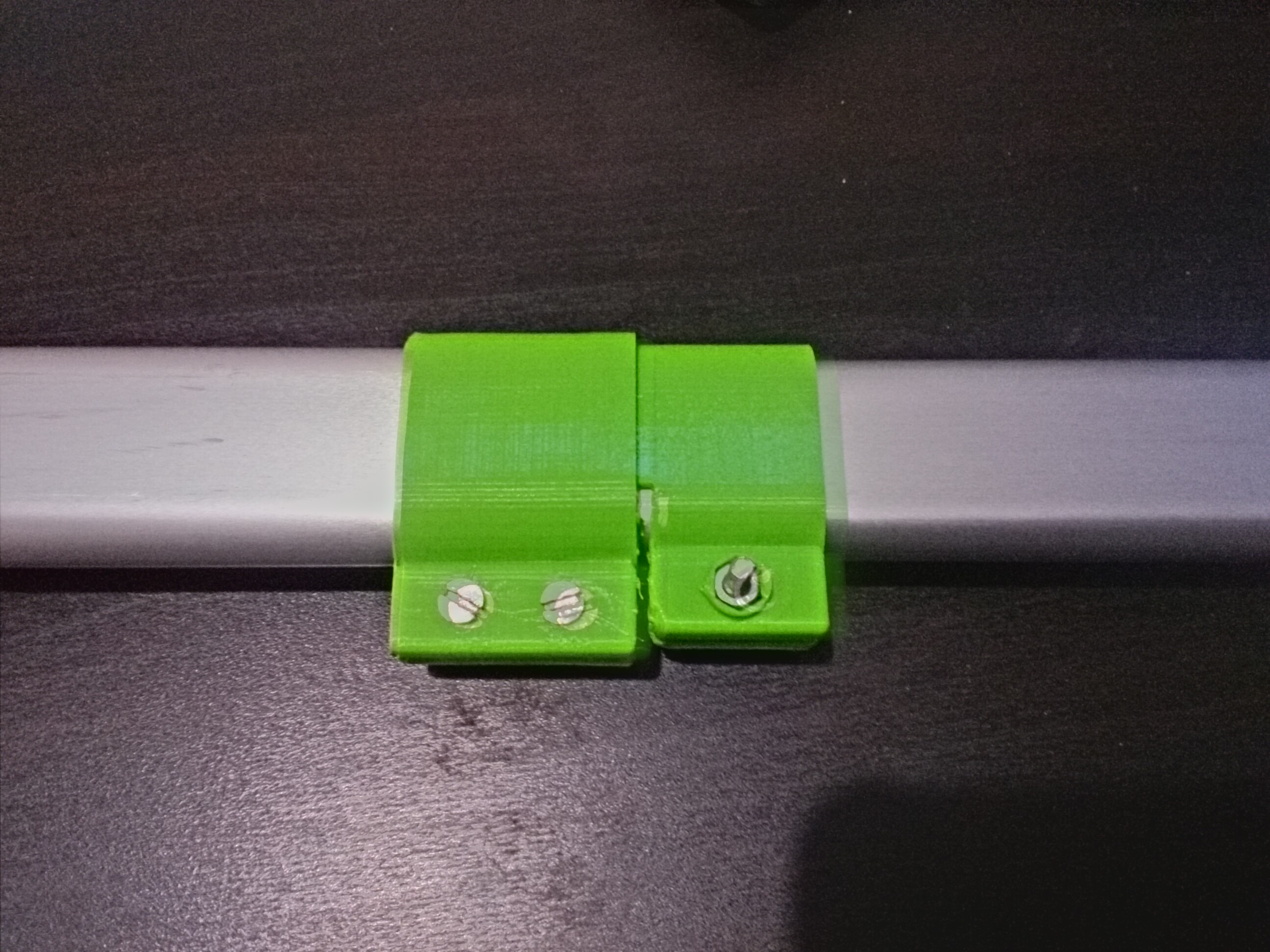

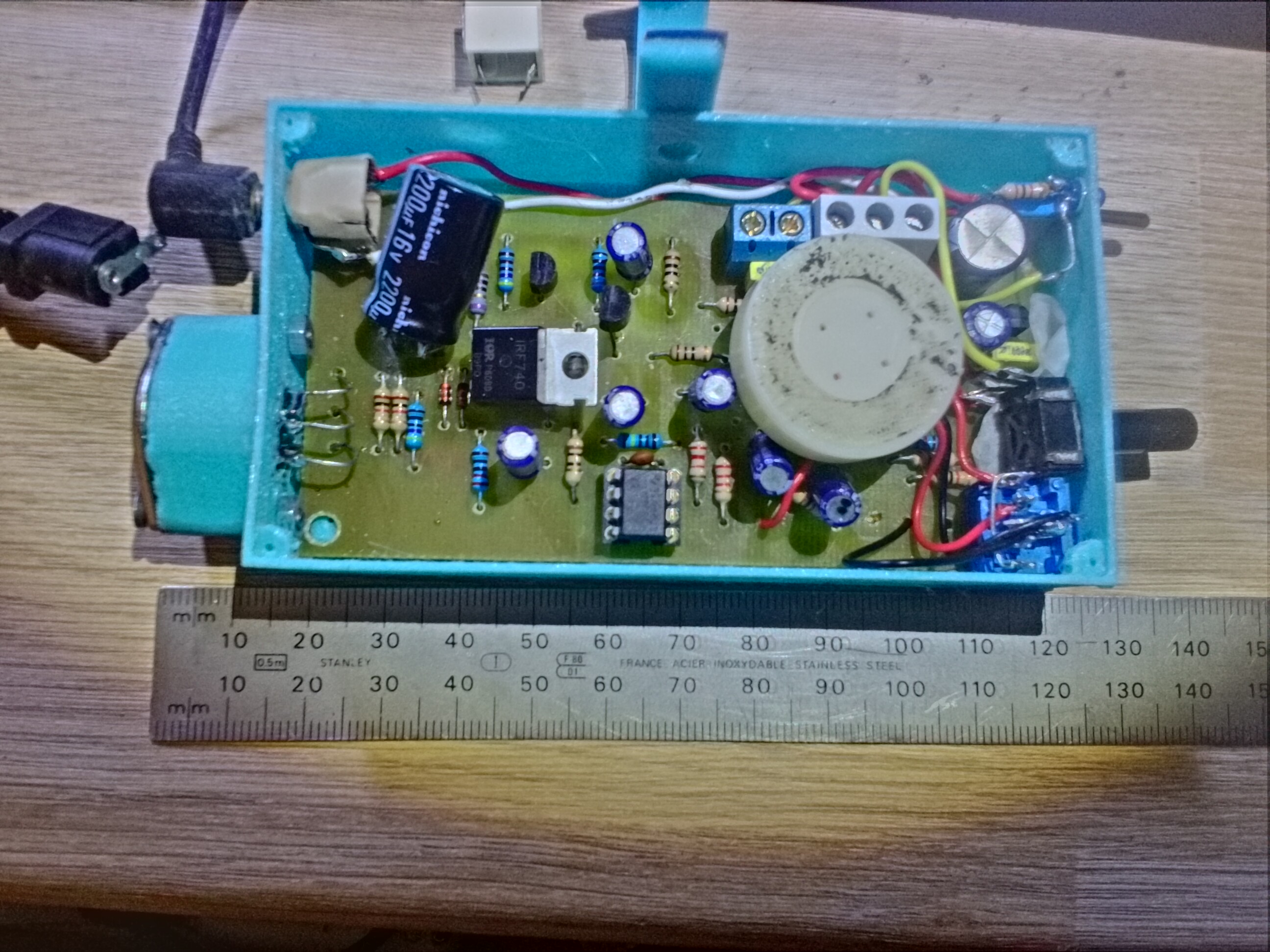

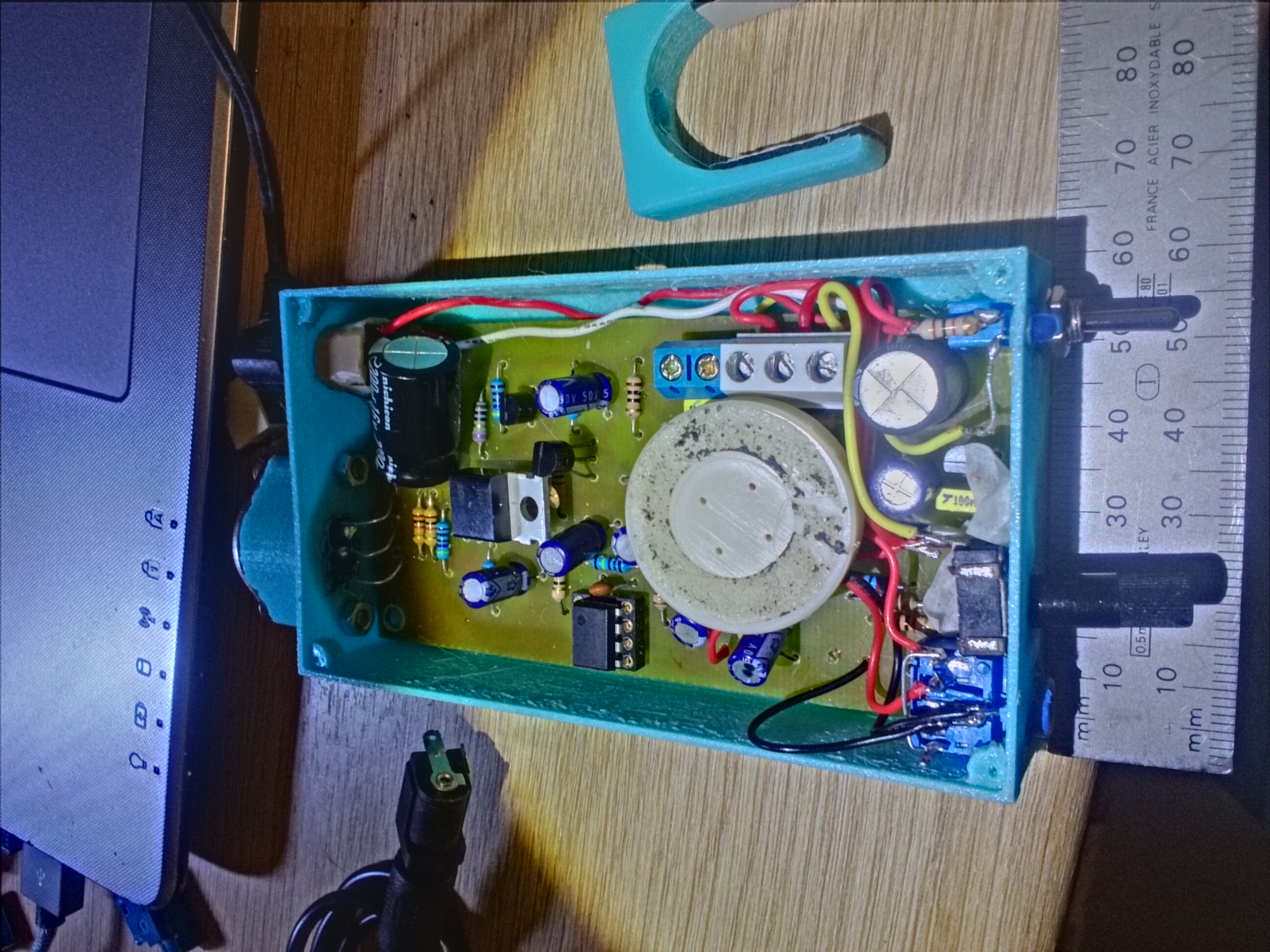

                      Hi all
                      Hi Bernard
                      Hère s my not finished pikini rod ans enclosure .
                      As you can see i have to connect battery pack plug at the back side(near pinpoint switch plug)
                      In front side on\off switch,led,sens pot,ear jack.(ear phone volume set by pot allready incorporate on wire headphone)
                      Thé rod Weight is aprox 200-300 gr (rod only! Without battery pack , pikini box ans coil)
                      Tell me what you think about this (sorry for the color of rod pièces this was old 3d printer wire left) i can ,maybe ,do sôme improvement?? Give me sôme idea please.
                      Thank you all
                      • Nice work
                        Consider mounting the battery pack under the arm cuff as counter weight for the coil => better balance.
                        Avoid any metal at least 40 cm from the coil - consider a carbon fiber lower stem e.g. cheap fishing pole...
                        Using the arm cuff profiles opposite as detector stand is a nice touch
                        I assume the round thing on top of the PCB is a piezo buzzer ?
                        Best regards,
                        - Bernard

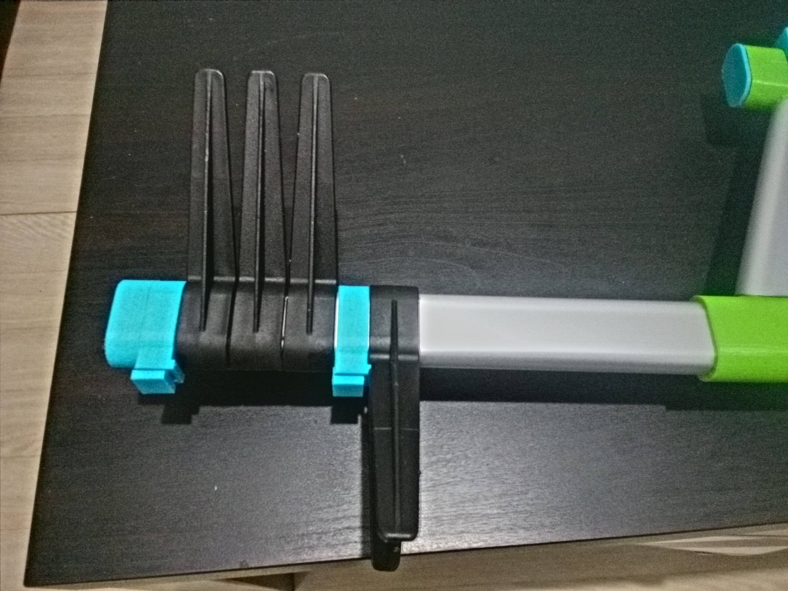

                        • Hi all
                          Hi bernard
                          Yes battery pack will be under thé arm cuff,touching thé opposite arm cuff,battery will be mounted on slidders so you can take it off to charge it
                          Thé lower stem will be carbone tube now i have to finish my coil!!!(hard thing to do for me!!!!!)
                          Thé round thing is effectively a speaker but not a piezzo ,it Côme from home telephone
                          Sending foto nearly
                          Ar
                          • I think home telephone speaker not loud enough to use with, i use medium buzzer like this one
