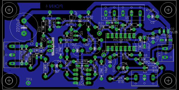

                        • small amp
                          what do you think about that?
                          pcb 20x20x5mm
                          found lm386 smd on micro wave oven pcb and some smd capacitor too ,so i think that it could be adapt for free for pickini.
                          i made this pcb from web scheme,do you think it is correct?
                          thanks
                          • Nick,
                            Most headphones have an impedance > 20 ohms.
                            If you connect them to the Pickini4 PCB, the sound is good / loud. You could decrease the 2 series resistors of 1K ( R16 and R17) in the original schematic, to have an even louder sound.
                            To me, with the headphones I normally use, the 1K resistor is a tradeoff between going deaf and hearing the beep.
                            Normally, you would not need an extra amplifier. The beep is digital: beep = 1kHz and dig, or no beep / the 1 Hz idle tick.
                            - Bernard

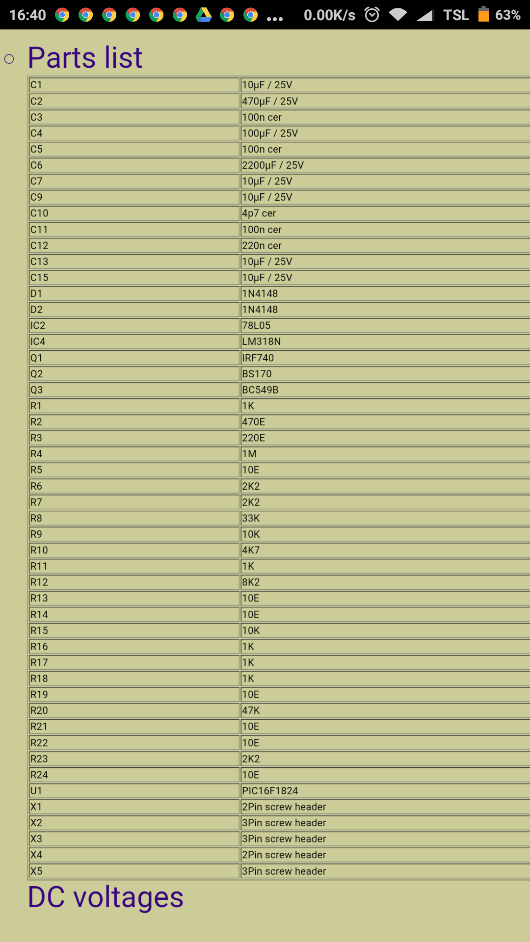

                            • The part list and pcb on c12 is not same
                              Please check
                              Pcb Click image for larger version
                              Part list Click image for larger version
                              • C12 should be 10 microfarad.
                                I adapted the parts list here:
                                Thanks for pointing this out
