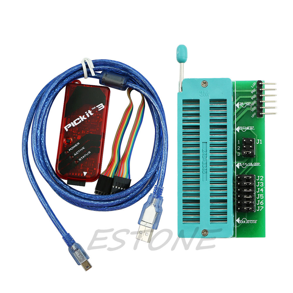

        This is the kit I got 6666. Correct me if I'm wrong, but J1 jumper needs to be across position2 for 16F's ? Bloody confusing, as the destructions say positionB (ABC not 123).
        Jumpers J2-J7 are in place.
        Thanks eclipse, going back there for a look now. Is that MPLAB IDE 8.92 thingy something separate to the 20v3.10 thing, or just a latest version of it?
        I had to plug the pickit into usb port to get the download to complete, so I presume it updated then- the lights were flashing..

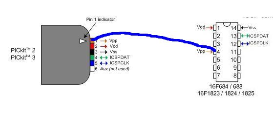

          • #95
            Do you have a schematic for the icsp ?
            programming with mplab is easy and only takes a few steps, one of the important ones is to turn on the 5v power in the menu
            however the icsp needs to have correct jumpers as well, I have an icsp similar to yours which I dont use
            but it came with a cct to get the jumpers right, google the chip you want to program and you will see what pins are required.
            a 16F1824 is 14 pins so icsp has to be wired for a 14 pin pic. you can check with mutlimeter,
            take notice of the white triangle on the pickit. thats pin1 VPP, mplab should start from shortcut and talk to icsp, but you have to select it in hardware
            http://picprojects.org/projects/prog...incon_rev2.jpg
            • #96
              Ah I think the little drawing on the right side of the icsp is showing the notch in the chip and the chip should be inserted at that point in the icsp
              check with a meter.
              7chips go in one direction and 1 chip goes in the other way round
              so if thats correct, plug the 1824 into the pin thats says 8/14/18/20
              • #97
                Very good 6666 8/14/18/20, yes, I was wrong thinking the 16F57 position. I will check before powering up, but I am afraid I have much to learn blindly...So , it's after midnight here now. Tomorrow I will position and check the chip in the icsp-I have the lead worked out-plug it in, fire it up, and see what screens come up.
                Baby steps, but in the right direction. Thanks matey.

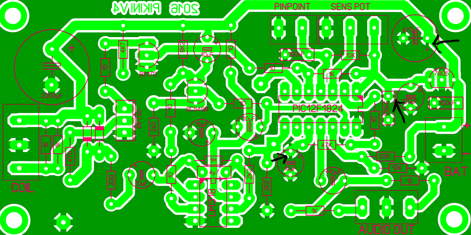

                  Hello Nick Holas
                  please check your Sprint Layout Settings, look pictures attached
                  risk of damage, caused by Thermal Pad connection
                  @ Tim
                  look at bottom side
                  there is diagram
                  it say for dip8/14
                  set jumper 1 to pos. B
                  jumper 2 to pos. 2+3
                  jumper 3 to pos. 2+3
                  place chip as shown on bottom
                  i have ordered same socket, at first i looked like a pig in the clockwork, because it searched some resistor or so
                  but this thing it realy easy and it work also for pic16f876

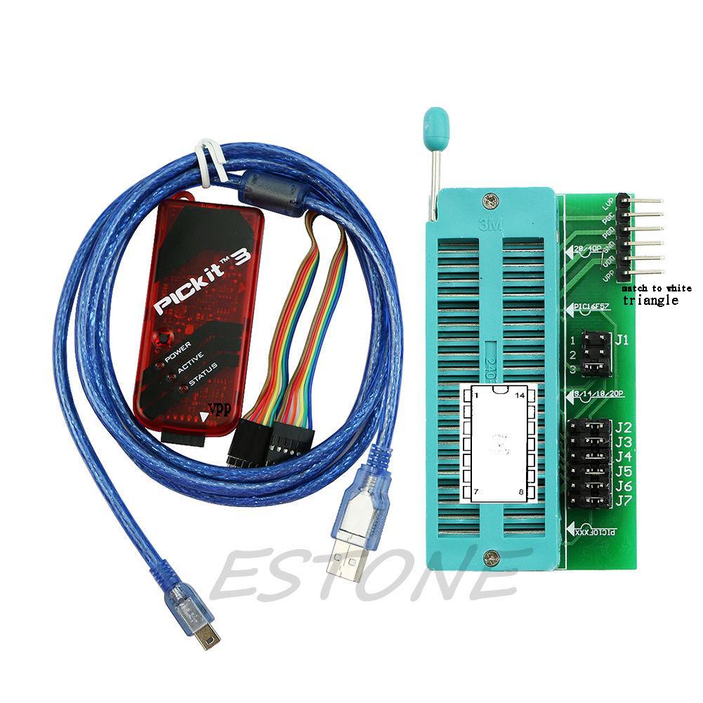

                    • I have made some pictures to try and help, buzz with meter before you plug into laptop
                      if all buzz's ok
                      the chip i think should plug in where shown you will get the idea
                      next connect the ribbon cable so vpp lines up with say the blue wire on pickit and iscp, thats matching the white triangle
                      the ribbon cable only plugs in 2 ways
                      if it buzz's ok next plug the pickit cable into usb
                      start mplab I use v8.76
                      in configure select chip
                      in programmer select pickit
                      then in programmer - then settings select power and tick "power target circuit"
                      at this point you may get a message saying that some software needs to be downloaded to pickit, select yes
                      if all is well you should see an ID come back from chip in OUTPUT WINDOW
                      now go to file, then import and navigate to folder where you have the hex file, select the file
                      on the right of the top line of program you will see 7-8 little symbols, as you move your mouse over each one it will tell you the function of each one
                      such as program and erase
                      I always erase the chip first
                      so hit erase
                      you should see some actiivity in the OUTPUT screen window
                      if all good chip should erase
                      then hit program, you should see some activity in the OUTPUT screen window
                      if all good you should get a message saying done or complete something like that
                      hope this helps and I have it all correct good luck
                      • Great help thanks 6666. That is a very helpful format of instruction for me. Very much appreciated. Hopefully I will get to it later today.
                        Thanks Bernte- I didn't even look at that. Yes, mine too has the outlines and tracings on the back, and I now notice about A/B positions on J2-J7.
                        Thank you both very much!

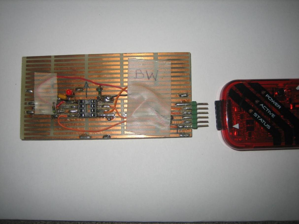

                        • I have been using a simple 8 pin socket on a piece of breadboard as the interface to the PICKit3 for years now, with different sorts of PICs.
                          The 8 pin devices simply go into the socket, the 14 pin devices have their top 8 pins inserted - pin 1 = VCC and pin 14 = GND.
                          Pinout to the PICKit 3 controller ( with pin 1 of PICKit = triangle )
                          PICKit --------- socket
                          1 -------------->4
                          2 -------------->1
                          3--------------->8
                          4--------------->7
                          5 -------------->6
                          6 NC
                          • Needless to say, this contraption needs a new IC socket now and again...
                            The LED is just an indication that power is provided from the PICKit programmer.
