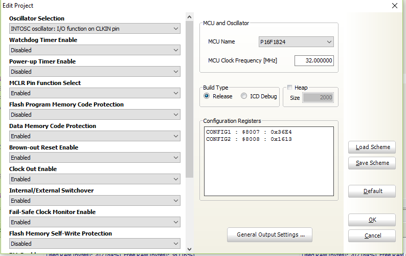

              While waiting for the parts to arrive I tried to play with the firmware a bit.
              I used MikroC 6.6.3 (latest) to compile the source. It compiles without errors however the hex file is not the same as the original.
              Perhaps some setting in Project/Edit Project Menu is different?
              • #82
                • #83
                  Errr... I'm pretty sure cracking the software won't make a difference.
                  It's probably due to different project settings.

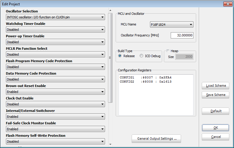

                  • #84
                    Here are my project settings:
                    • #85
                      That helps a lot Bernard!
                      I made my configuration registers match yours.
                      Still hex has some differences but I loaded in Proteus and looks to be working fine.
                      Probably some internal compiler differences (maybe?!) give somewhat different results.

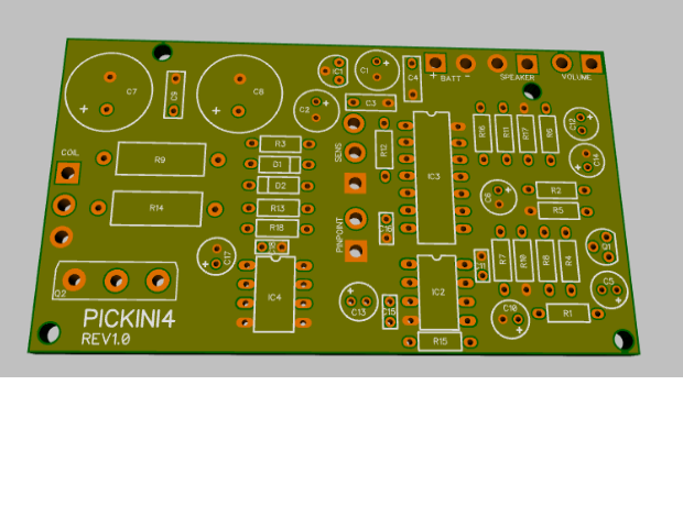

                        • #87
                          I wanted to make few changes (inverse TX polarity, slightly increase pulse width).
                          With the help of the correct project settings I'm sure the changed hex will be working just fine.
                          Here's my board. It's 80x45 in size, few cosmetic changes here and there to fit parts I already have.
                          • #88
                            Nice work !
                            I assume that the extra chip IC4 is a FET driver ?
                            Looking forward to seeing the complete stuffed board in action.
                            - Bernard
                            • #89
                              Yes instead of the BS170 & 3 resistors there (I kept R13/10R) I will have MCP1407, since I have those from previous builds.
                              I needed to inverse the TX signal because otherwise I would need to use inverting chip which I don't have.
