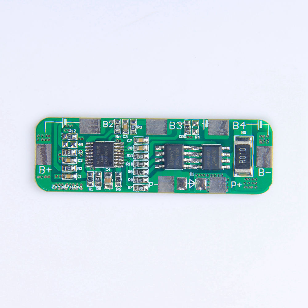

                  I see, any idea how to charge 3 series LiLon with auto discharge and battery protection?

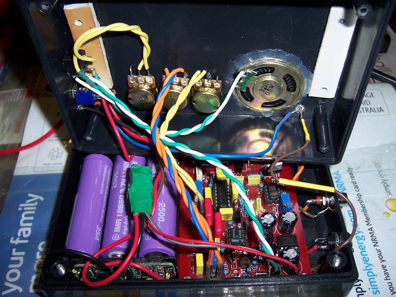

                    • Originally posted by ripsdevala View Post
                      Here's a couple of options ripdevala. I use the one off Ebay. Bat+Bat2Bat3 Neg(miss Bat4). P+andP- go to charger. I use a 1.5w 12v solar panel mounted on stem, or you can charge from any un-regulated 12v supply. No fancy expensive chargers needed.
                      4amp, so you can also hook P+/P- to circuit. (The reg in green tape was omitted once I changed 7660 for 1054).
