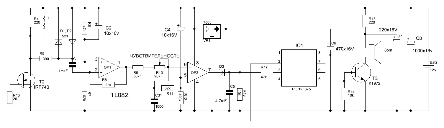

  • I also think making a different coil might be answer to problem.
    • Try making other coil as was suggested.

        • Pickini cant work in most of housing area in my place, even with shielding, bring it far from the house area and it will work.... And change ur coil as spec.
          • in fact, it is not needed there. When printing it turned out separately from the common bus, but it converges already at the bottom. this is not a problem.
            minus, he and in Africa minus
            • Comment
              • Also your chips are standing far away from pcb, which could be problem, each leg conductor acting as antenna, inducing emi into circuit?
                • here if you assemble a generator for your md, then chuika is much more with small coils ..
                  since the differences from your scheme are not great, then it is insignificant to make changes.

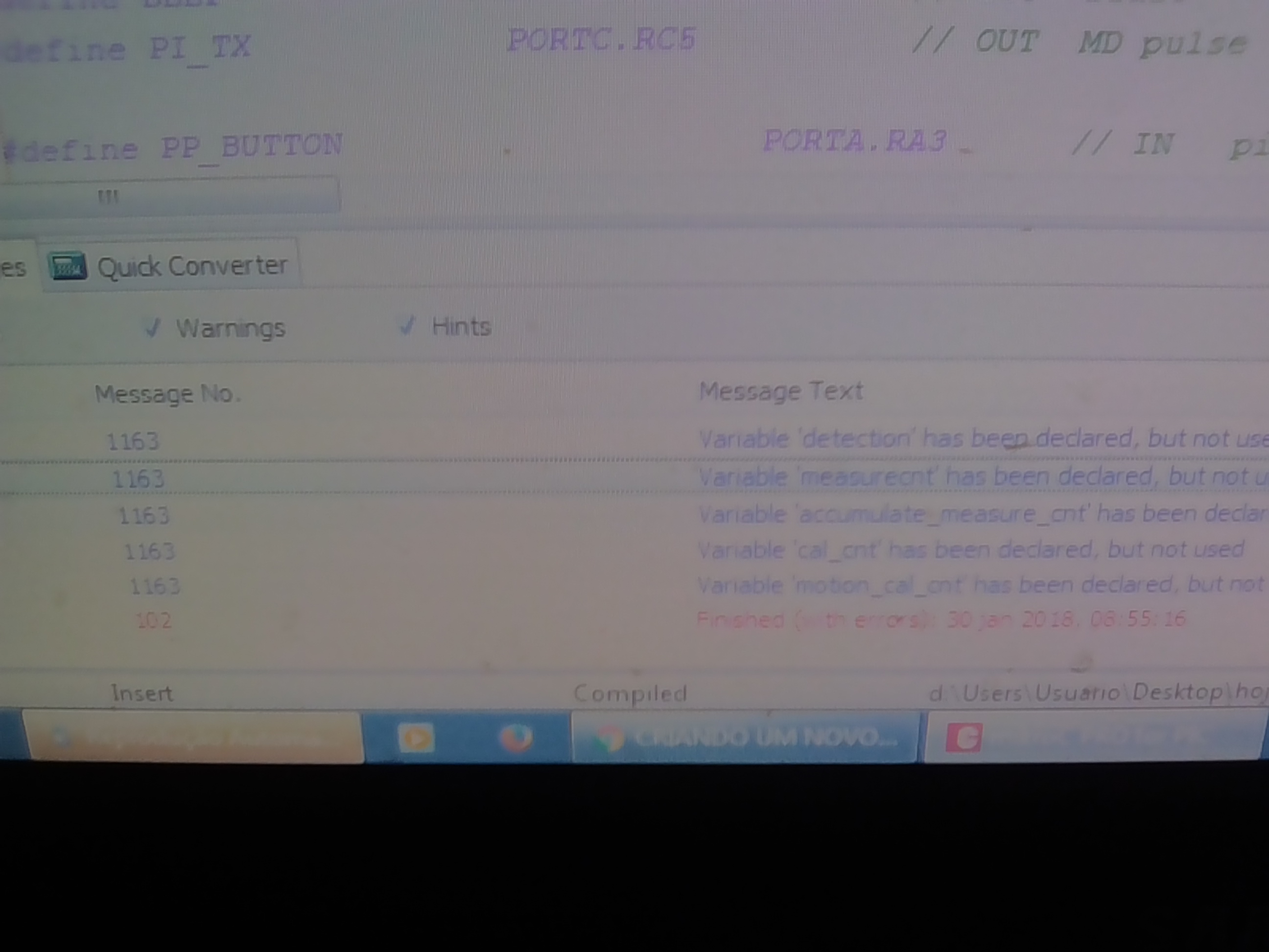

                            someone help me
                            someone help me
                            • I can not generate the hex code pickit 16f616 20 mhz http://users.telenet.be/willaert/MD/pickini/software/Pickini_16F616.c
                              • If you are trying to compile the source code and get these warnings "Variable has been declared but is not used", you can comment out the declaration of this variable.
