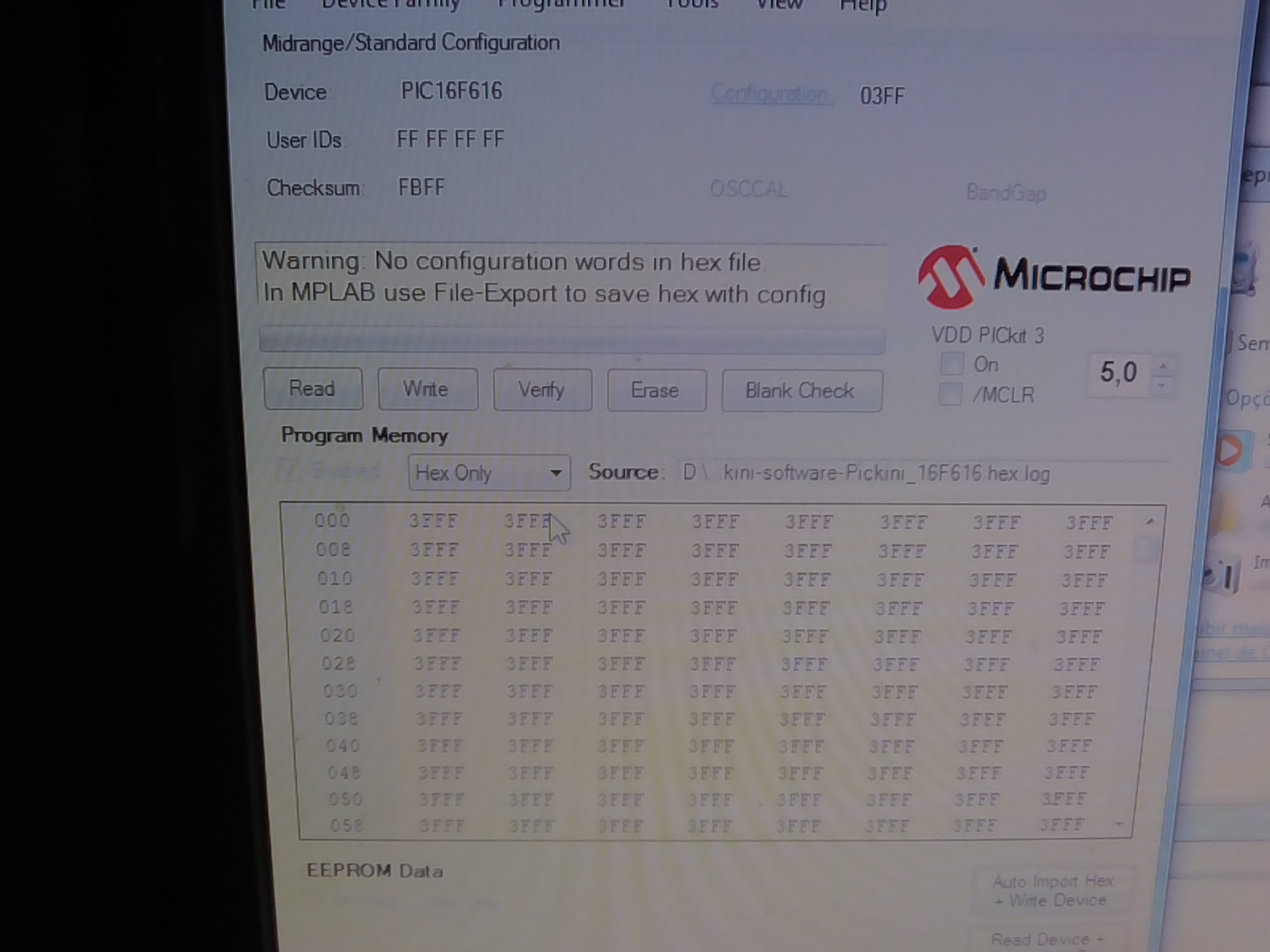

    • I can not copy the hexadecimal codeClick image for larger version
      Não consigo copiar o código hexadecimal

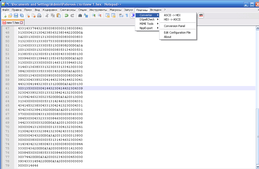

      • you need to create a hex file and enter the hex code into it, save and flash the controller. nor any compilations produced unnecessarily.
        • The problem is, I do not know how to do this.
          • create a text file, open through the notepad https://notepad-plus-plus.org/download/v7.5.4.html enter the code and save it as a hex.

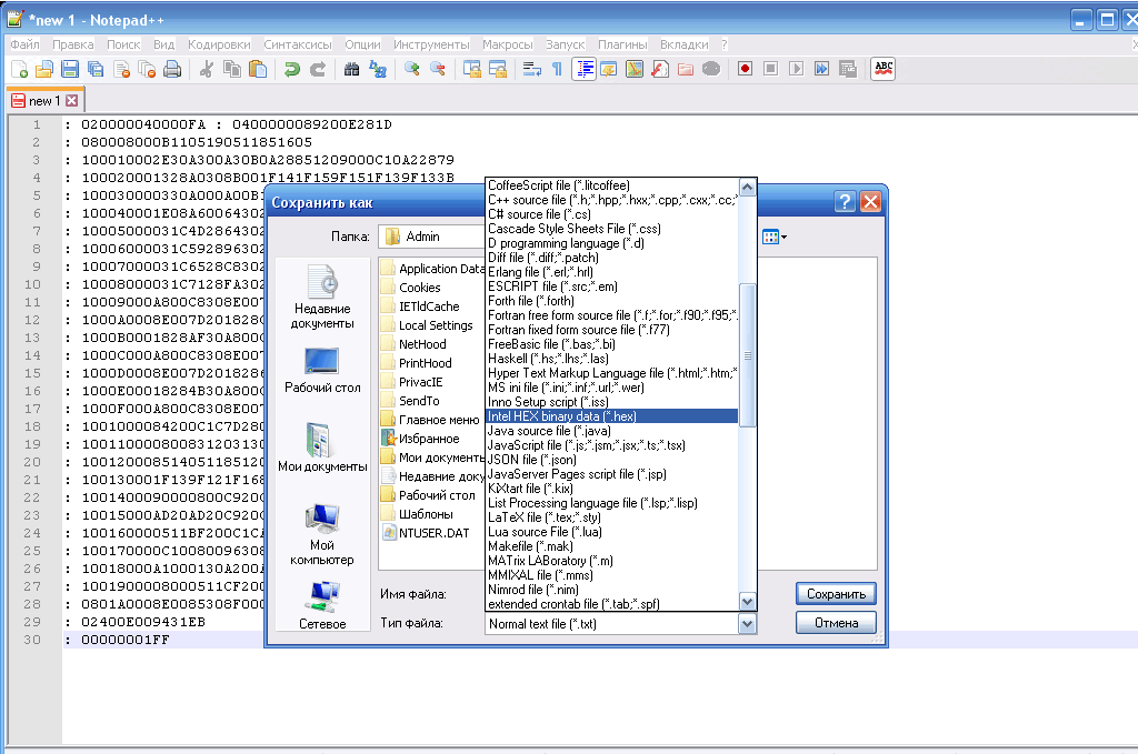

            • and just in case the conversion from one to another
              • Right click -> save as "Pickini_16F616.hex"
                Remember that this is the very first version of Pickini.
                You may want to change to the Pickini v4 with 16F1824 PIC ( embedded oscillator, no need for a crystal + higher resolution: 32 MHz instead of 20 MHz)
                • yes i can say it works just open Notepad, copy hex into empty sheet and save
                  if you save it as v4.txt file you can also rename it into v4.hex it is converted automatic
                  in mplab ide create a new Project, set correct Family of chip design, in the Setting on the top tool bar serch programmer Options for power Setting and set hook on 5V power target from pickit
                  then press run and you should get what you want
                  • t worked. I downloaded the notepad ++program...ok

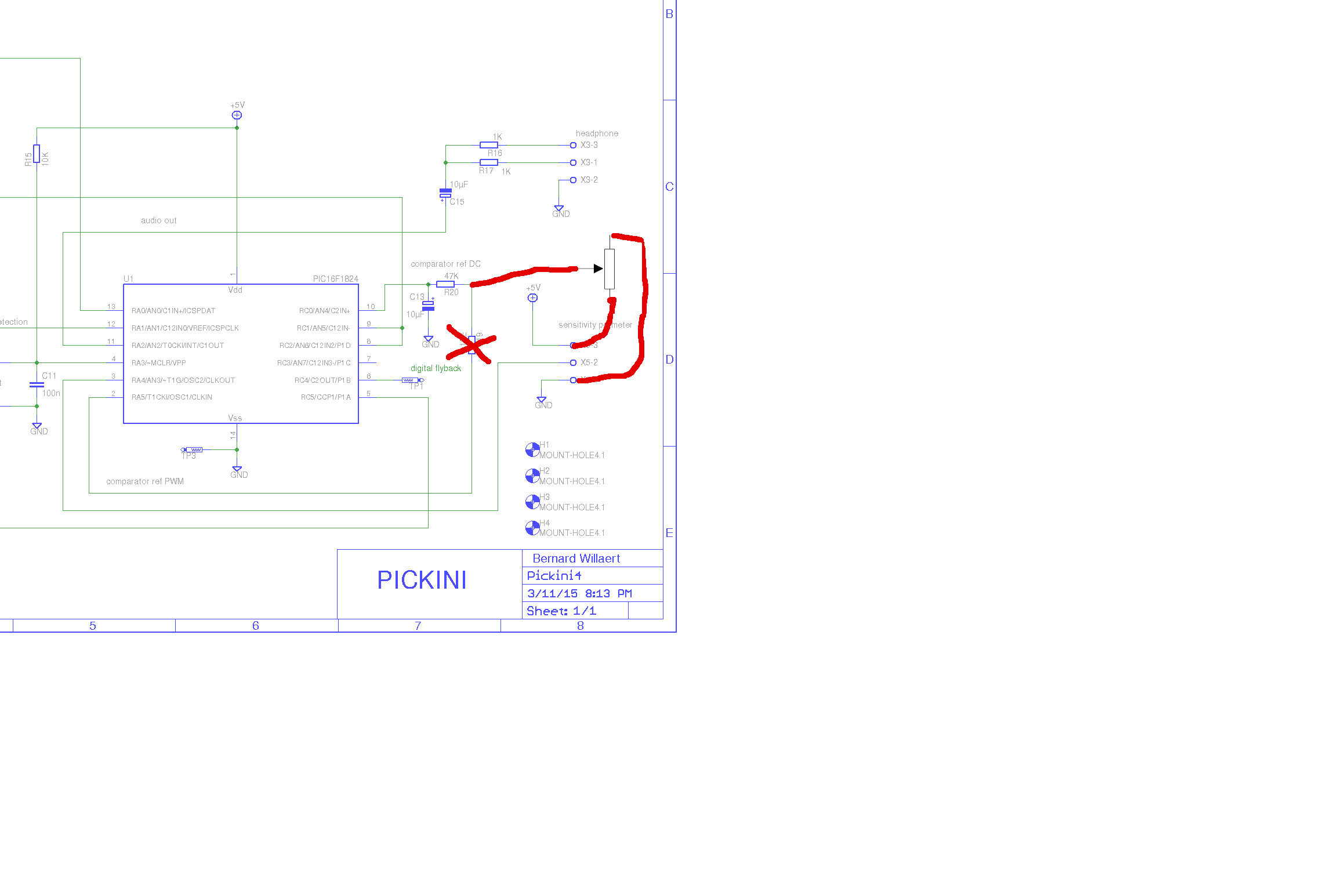

                        • Some people asked me by email if it is possible to manually set the comparator slicing level that determines the flyback pulse width measurement.
                          This hack overrules the automated slicing level set up by a 10bit PWM output.
                          Normally, the automated adjustment will first set up the DC level of the flyback pulse and then set the slicing level to 0.5 V below the DC level after the flyback pulse.
                          This results in a very sensitive setting that works fine in places without any EMI distortion.
                          When you really want to degrade the performance of this detector because some EMI noise source is nearby - especially in-house ( but the use case for in-house appliance of this detector was never considered in the design phase), you can do so, by overruling the automated PWM generated DC level to the comparator pin.
                          This use case is one of the reasons why the DC level was brought outside the PIC.
                          The DC level for the comparator slicing level is generated by PWM output pin 2.
                          Then it is fed into the comparator input via R19 - R20 and C13.
                          The RC filter R20/C13 can remain, but R19 is just a bridge resistor: cut/remove R19 = 10 ohms and connect R20/C13 to the wiper of a 4K7 potmeter between 5V and Gnd.
                          When the DC level is turned outside the 1.5 - 4 V range of the analog flyback pulse, the coil error sound will be heard.
                          A limited realistic range would be 2 to 4.5 V.
                          But again: this detector was intended for the beach, not inside an EMI infested house.
                          Have fun,
                          - Bernard
