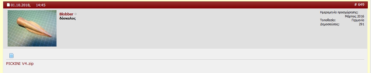

  • 46118[ATTACH]
    post # 649
    • Pickini V4 SMD File
      Thank you for your help
      • SMD layout. Ready to print.
