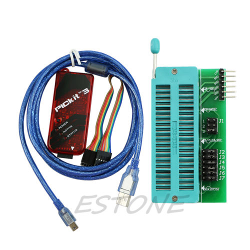

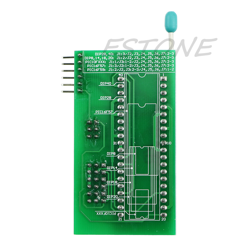

@6666,,,,Thanks for the explanation,,,I'm still struggling with it,,lol,,,I got a pickit3 clone that came with a programmer seat but for the life of me, I cant figure out the jumpers,,,it says for 8/14/18 and 20 pin chips the jumpers are J1:2/J2,J3,J4,J5,J6,J7:2-3,,,,,,,,I cant work out whether j2,j3,j4,j5,j6 are open or the same as j7, 2-3,,,,I'm lost. And I've tried the chip in several positions and I'm getting nowhere fast,,lol. HELP!!!! Can anyone explain an easy way (Maybe pictorial/Diagram) to do this please?,,,I had less trouble programming my Felezjoo chip, only took 2 minutes,,,lol. Thanks in advance. Marty

Ok this is difficult by remote control
not knowing what ICSP (programmer) you have, usually you insert the jumpers for the specified pic
you need to supply a lot more info on your setup to even guess whats wrong,
I bought a cloned pickit 3 it would not work with my bench top PC, but worked fine with my laptop
please explain your setup.
From my rough list of instructions where are you up to ?
Hiya 6666, thanks for the reply. I bought a pickit 3 clone kit off ebay. I downloaded mplab 8.92. It took ages for mplab to finally connect to the pickit 3 but then it said it couldn't find the target board,,,when I was setting the voltage to the board it just kept saying not connected to target. When I used the pickit 3 standalone software it kept saying 'Not responding' and sort of crashing after pressing one or 2 buttons, so I had to keep unplugging then starting again. Also I don't know if I've got the chip in the right orientation or in the right slots,,,though I've followed the diagram on the back of the target board I'm still having no success.

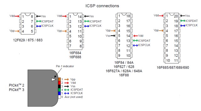

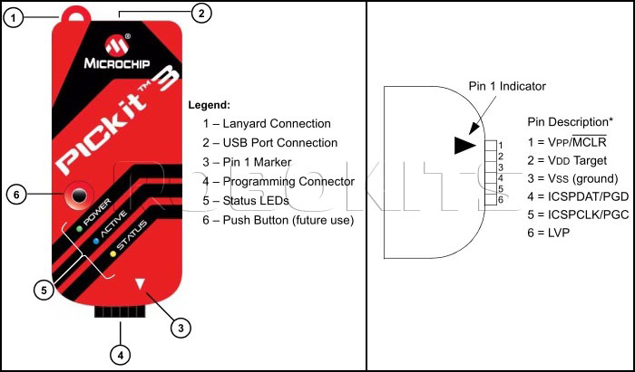

I also use a Pickit3, but there are no jumpers.
To program the PIC16F1824, only the top 8 pins are needed, so I keep using the same 8 pin IC socket that I used for smaller 8 pin devices.
I always use MPLAB as an interface to the programmer
Thanks F117,,,,I feel really stupid but I don't know what you mean by the top 8 pins? It is the 14 pin pic16f1824 I bought. Is there a pcb/device I could make to place this chip on/in to program it? Or a full diagram that I could follow on how to do it? It's just gone 7.15am here and I've been trying to get this to work for the last 16 hours and have had no luck,,,lol. Sorry for looking stupid,,,thanks again for the help,,,,I'm really looking forward to completing your detector design and think it's great what you've done. Thanks again. Marty
