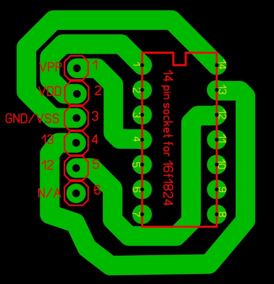

  • With the top 8 pins, I meant pin 1-4 and on the other side 14-11.
    To program the chip you need to make these connections:
    PICKit3 pin------ PIC16F1824 pin
    1 -------------->4 VPP
    2 -------------->1 VDD -- there is a setting in the PicKit software saying: power target from Pickit or something like that. This is the PIC16F1824 power supply = 5V
    3--------------->14 GND/VSS
    4--------------->13 Program data
    5 -------------->12 Program clock
    6 NC
    Make sure the chip gets 5V power supply from the programmer: measure between pin 1 and 14 of the 16F1824.

      • @F117,,,Could you let me know if this drawing I made is correct or not please?,,thanks in advance. Marty

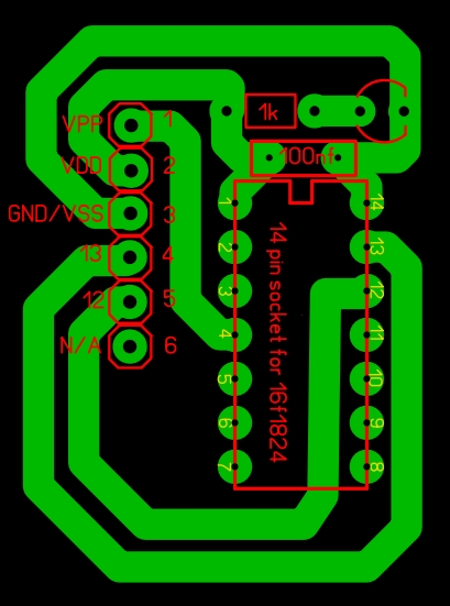

        • Your drawing looks OK to me.
          If you are considering to actually make this PCB, you might want to add:
          - an LED + 1K resistor between VDD and GND to indicate power supply to the PIC
          - a decouping capacitor of 100 nF Cer between VDD and GND
            I'll make a little pcb like you did and give it a try.
            You don't need to make a pcb to do this, as it should be possible to set the jumpers on your programmer board to achieve the same result. The instructions are on the back of the PCB. If you cannot make sense of the instructions, then simply buzz through the connections from the ICSP connector and find the appropriate jumpers that way. Use F117's wiring list in post #571 as a guide.
            Also, you don't need to turn on the power from the PIC software GUI, as it automatically applies power during programming.

                  • Hi all,,,Could someone please check this pcb drawing I did,,,I added the Led/1k/ 100nf,,,,Did I put them in the right place? Thanks in advance. Marty
                    • This looks ok to me, Marty.
                      • Great!,,,Thanks a lot for the reply and help F117,,,,I'll print it off then and get it etched and mount the parts and give it a try,,,,,I'll let you know in a couple of hours if I have any success in programming the chip. Thanks again. Marty
