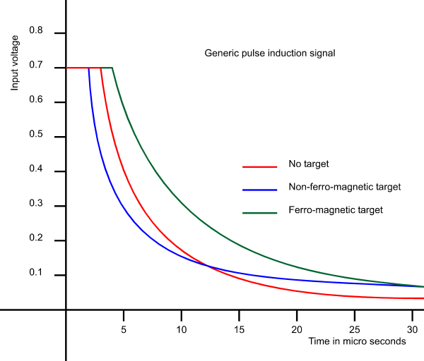

    It seems from the graph I posted, that to reliably detect non-ferrous, you need the pre-amp to come out of saturation within 4us, that means a fast op-amp, which the LM318 is, and also a fast coil. I think with a basket weave coil or a spider weave coil with Litz wire (or equivalent) is the only option to get discrimination ..
    If you don't have all those ducks in a row, it won't be reliable ..

      I am thinking, without too many modifications, it is possible to do simple two tone discrimination, by just some simple code changes (as per the White's PI)
      If you have a look at the attached image, it shows the pulse decay for different metals (ferrous, non-ferrous). If you judiciously choose the slice level (i.e maybe some manual control), then you would get the pulse width "decreasing" for non-ferrous.
      (i.e if you put a line at 0.3v on the graph, then non-ferrous would give you 5us, no target 7us, and ferrous 12us .. as an example)
      If you map that to a different tone (and/or light) we could get some form of discrimination ..
      Let me know what your thoughts are ... I could have a go at the code changes to try it out ...
      You would of course need a fast coil ..
      [ATTACH]49654[/ATTACH]

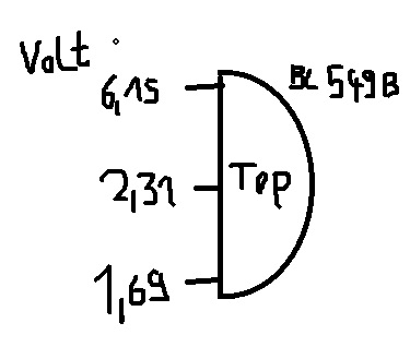

                    • i have no luck - some of the latest pickini i did last years will not work exactly
                      i got very similar problems on the 4 boards laying on my work bench
                      look the voltage diagram, pin 5 of lm318 has one very bad voltage can that be a result of bad bs170??
                      also pin 2,3, and 6 seems a bit off the tolerance
                      voltage from the pic controller looks also not ideal
                      Pic16F1824
                      Pin normal from f117 my result with coil without coil

                      • or problem with bc549B?
                        ok i got some answer in
                        post 227 and 228
                        same problem
                        how can i disbale mclr whule programming with mplab and pickit3?

                          2/ A problem with the DC offset of the opamp:
                          Pin 3 of the opamp is the DC offset that gets adjusted after startup.
                          Pin 5 of the opamp is not connected. The BS170 is not related to this. The BS170 is just a level converter that transforms the 5V pulses to 12V to the gate of the IRF740.
                          Do you get the coil error sound after calibration = continuous low tone ? This indicates that there are no flyback pulses at the input of the microcontroller.
                          I don't see a problem with the BC547: VBE = 0.6V.
                          But the collector voltage in your drawing is 6.15V. this should be equal to the voltage on pin 3 of the opamp, which is 8.3V in your case. In between the collector and the opamp pin 3 there are only 2x 10 ohm resistors in series = jumpers on the PCB.
