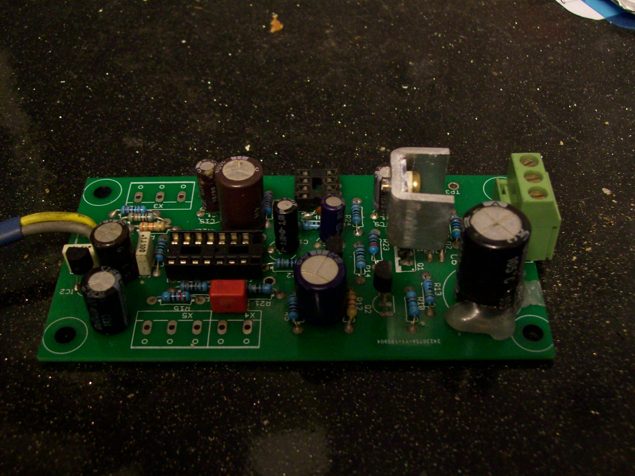

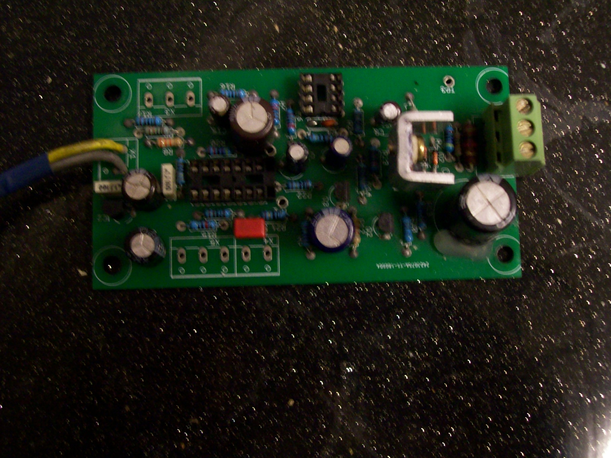

                  hi all, not far off finishing now.
                  aly.
                  • Nice looking board !
                    I can see you used a range of different 100 nF caps. In theory they should all be ceramic, but this most probably won't effect the functionality.
                    I also never placed a heatsink on the MOSFET. With the standard 100 microsecond pulse width, that should not be a problem.
                    - Bernard
                    • thanks bernard, i only use ceramics in really small values, i like box caps in amps and detectors just a personal preference, i once had some bad ceramics that caused oscillations, as for the different types i would have used red wima's in all positions but couldn't find my box of them, by the time i found them i had already built the power supply.
                      as for the heatsink i bought some for a repair i did that used 26 of them and the cheapest way to get a quantity was to buy 100 of them so every mosfet or regulator in that package gets a heatsink just to use them up.
                      aly.

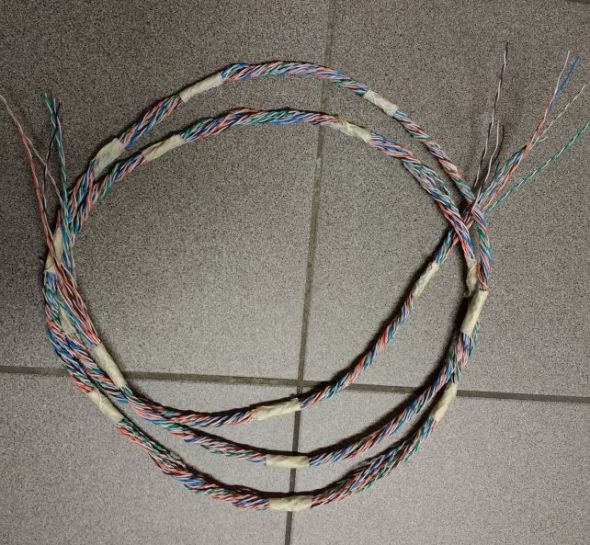

                        • I summarized some popular coil dimensions here:
                          http://users.telenet.be/willaert/MD/...n/V3/coil.html
                          For a 1m coil I usually take 5 twisted pairs from a network cable - 4 m long.
                          In a standard CAT4 cable, there are 4 twisted pairs, so you will need another length of 4 m for the 5th pair.

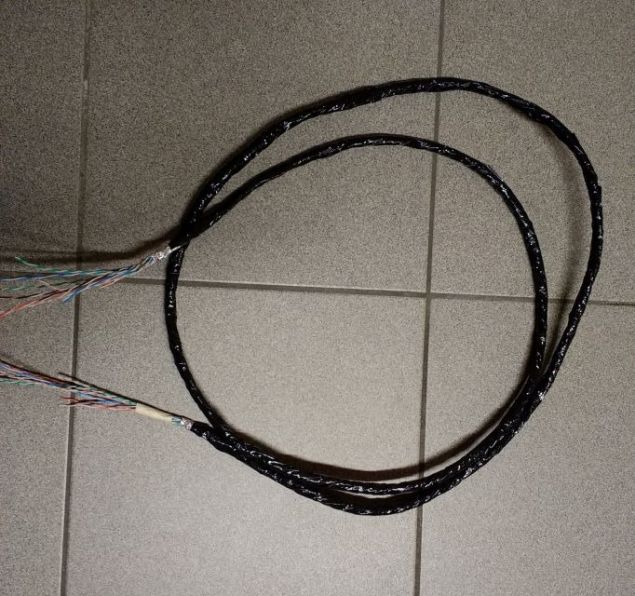

                          Bundlle them together in a new cable by wrapping it with electrical insulation tape:
                          Then a layer of shielding ( alu foil eg ) and then another layer of electrical tape.

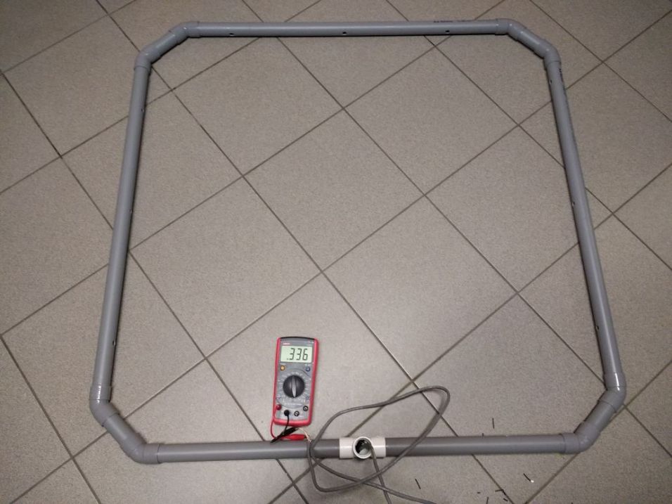

                          You can then place the cable in a PVC drain pipe frame and connect the ends of the wires to have a bundled coil of around 350 microHenry and 2-5 ohm:

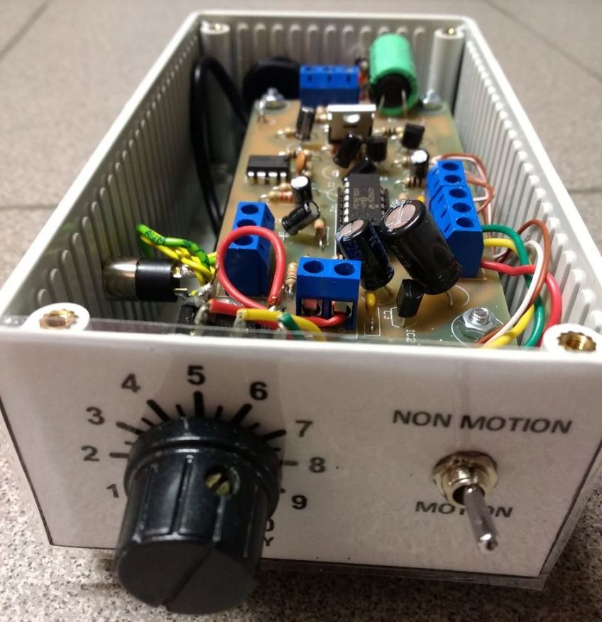

                          Add a control box with batteries:

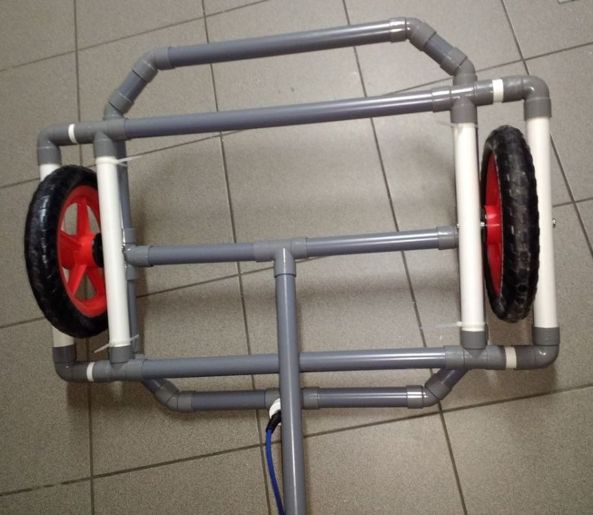

                          Drag it behind you, carry it or mount it on plastic wheels:

                            • That cart is a great idea.
                              • What about cat5 cable, i can't find any stranded cat4 lan cable.
                                Theres a metal rod on the cart wheels, is that okay?
