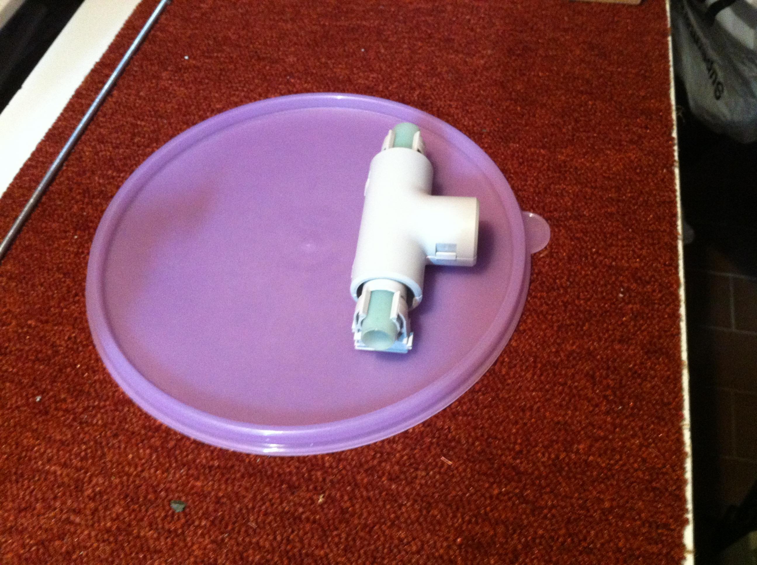

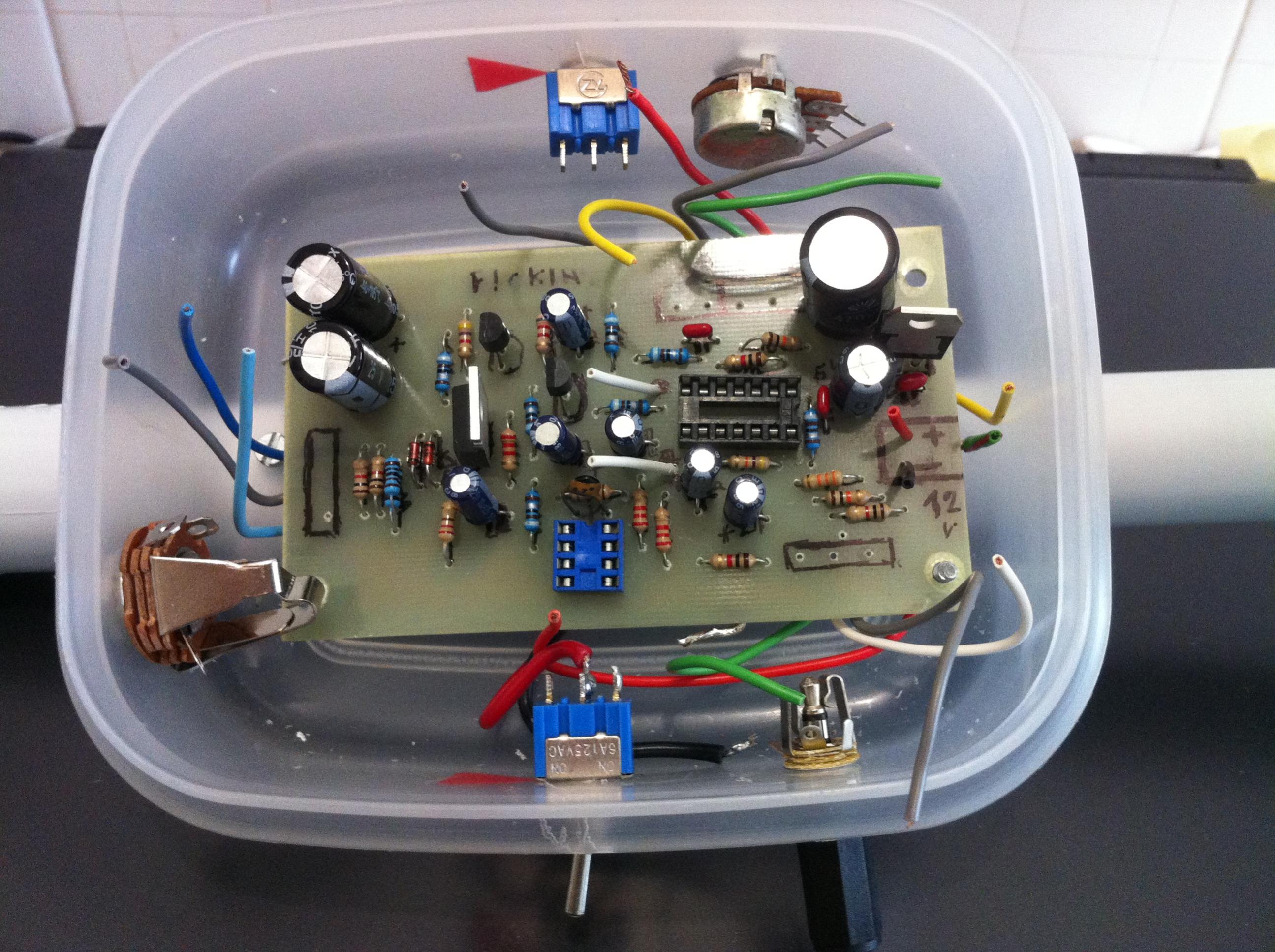

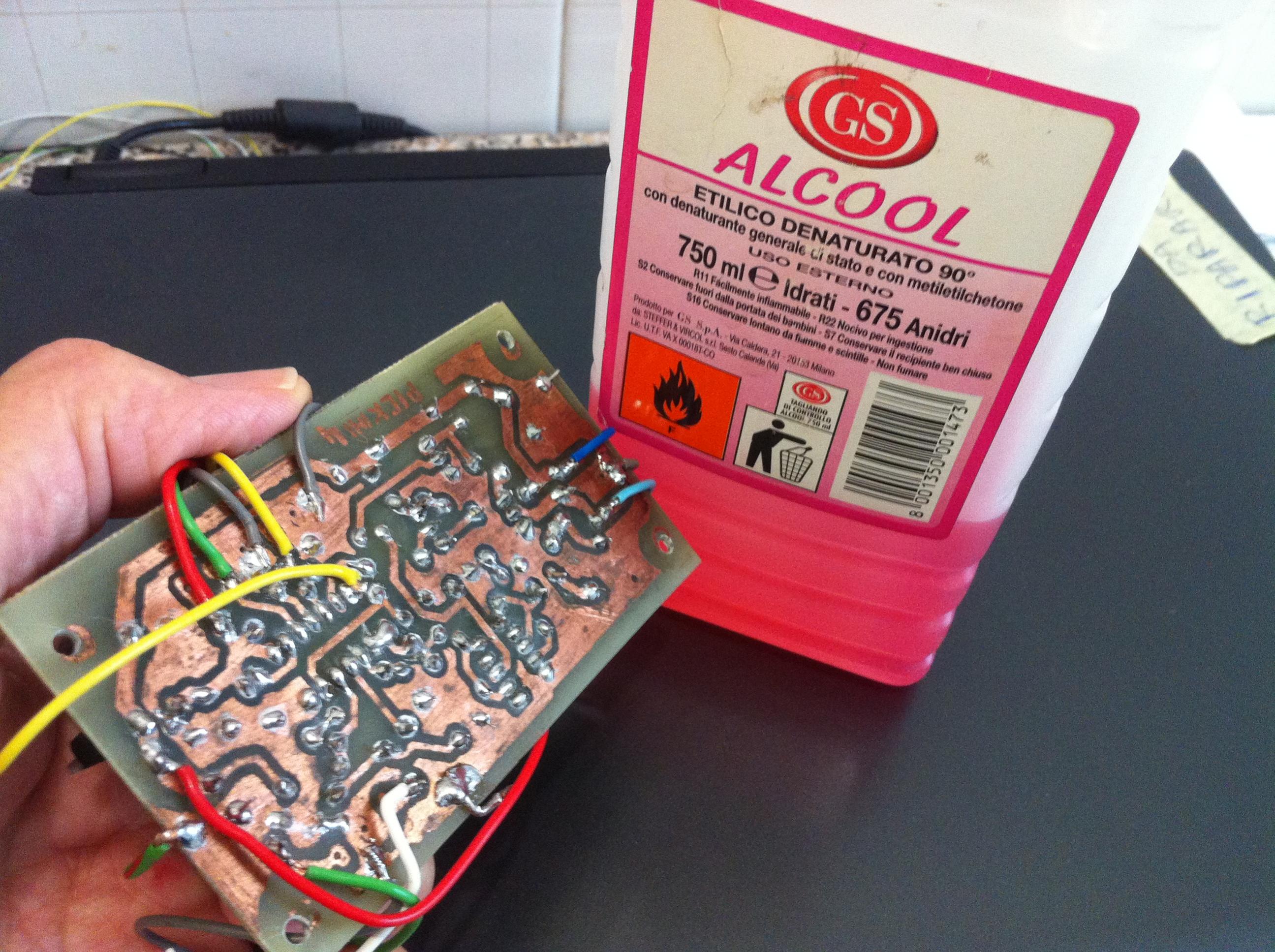

            • other photos of my Pickini 4
              • Originally posted by PIERE View Post
                [ATTACH]47843[/ATTACH][ATTACH]47843[/ATTACH][ATTACH]47843[/ATTACH][ATTACH]47844[/ATTACH][ATTACH]47845[/ATTACH]
                Very inventive, all DIY, very good

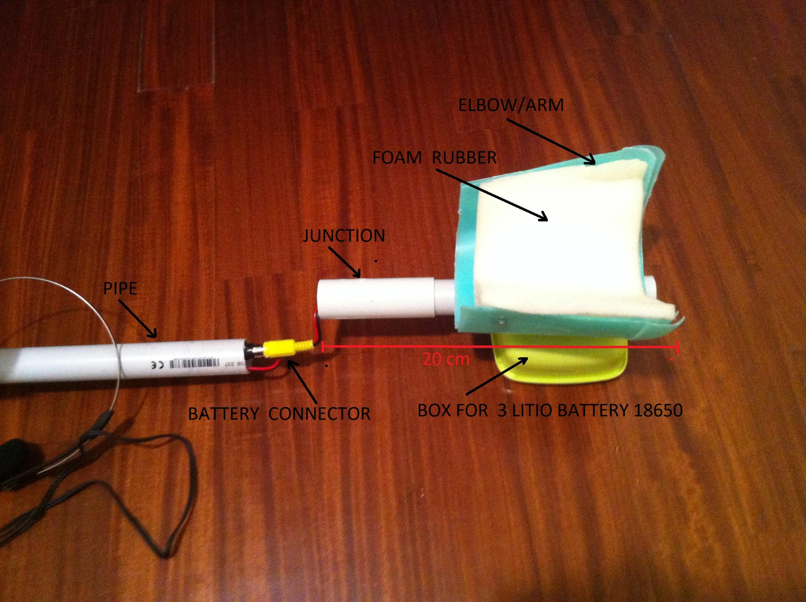

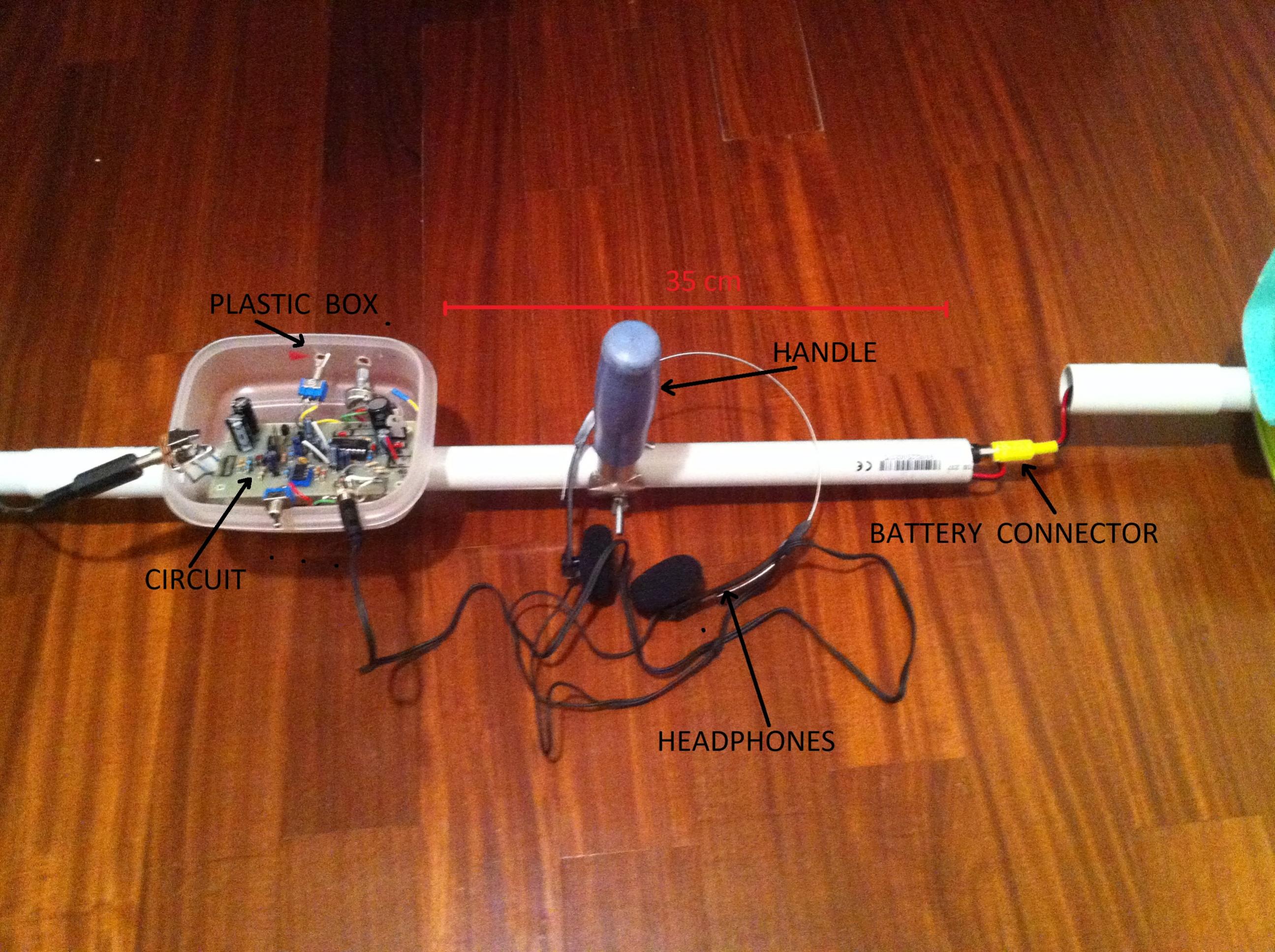

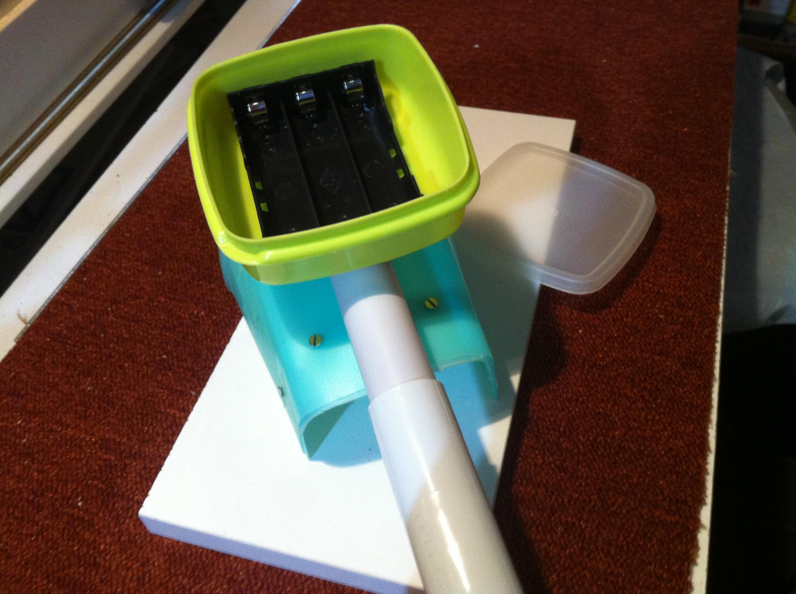

                  Just make sure that the electronics box is not too close to the coil.
                  When you also store the batteries in this box, you may have 2 adverse effects - when close to the coil:
                  - the magnetic field may be "disturbed". Not sure if you will notice anything though...- as long as the box is not moving with respect to the coil.
                  - the balance of the detector will be wrong. In order to save your elbow/arm it is better to move the weight backwards, behind the handle, e.g. under the armrest, to have the detector in balance once the coil is mounted.
                  From my personal experience, I know that swinging a detector that is not properly balanced can be painful afterwards ( for a long time ).
                  Success,
                  - Bernard

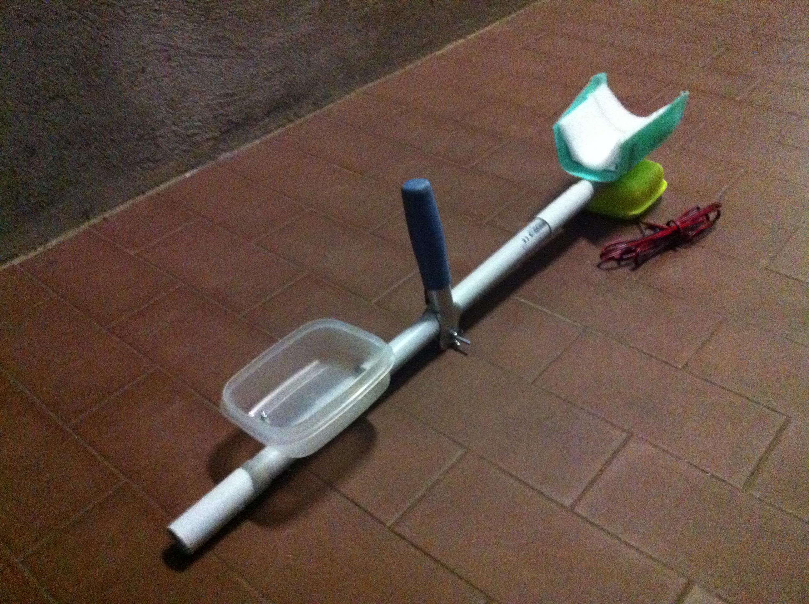

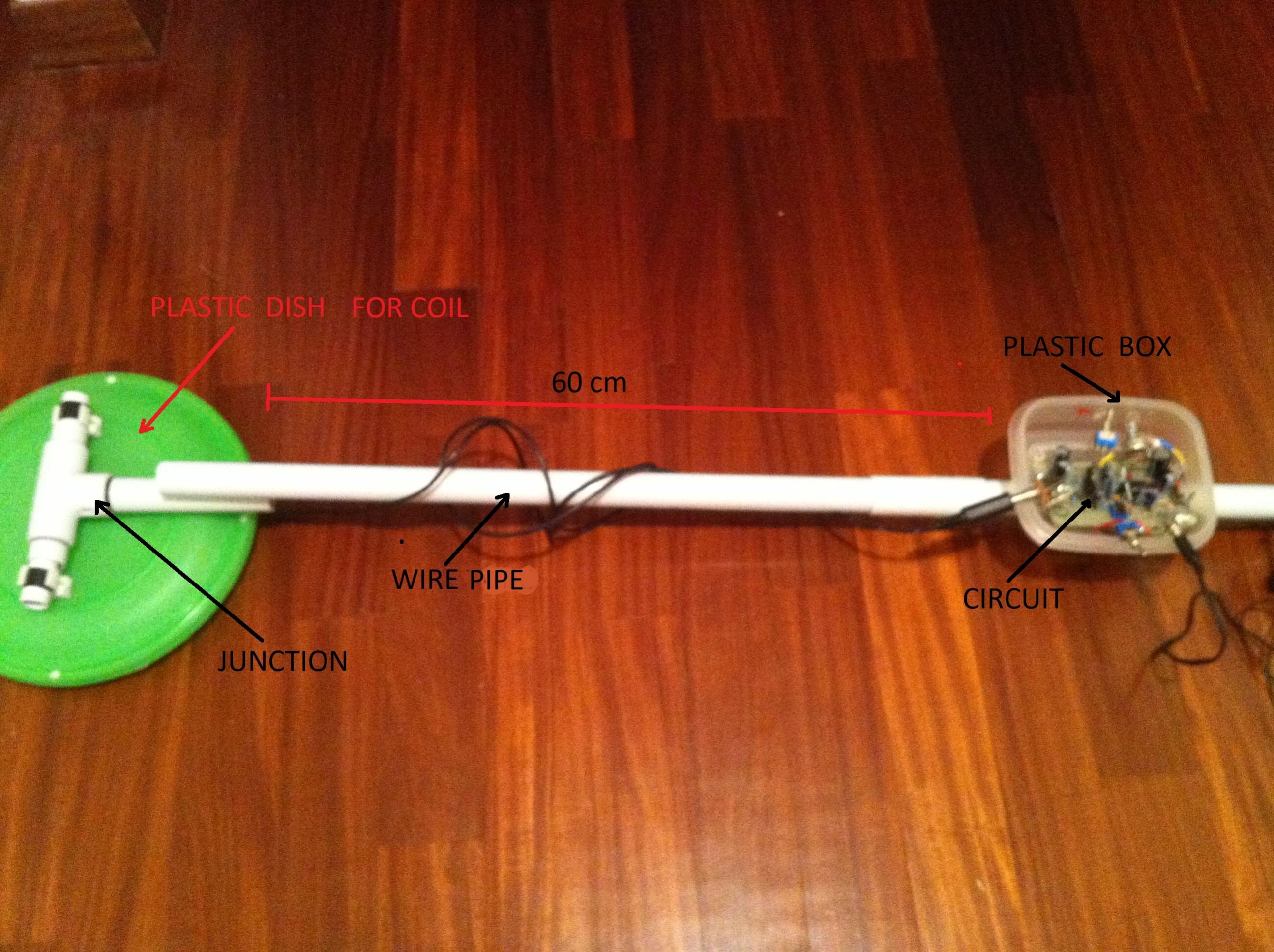

                  • OK for everything Bernard!
                    I have found the hex file for Pickini v4.0- v4.1-v4.2 on the page I indicated.-
                    As soon as possible I try all the versions to find the best one!!
                    NO, the electronics box is not too close to the coil!!.-
                    Now I send you the photos of my construction.-
                    I think that's fine.-
                    Thank you very much Bernard, I will let you know!!.-
                    RegardsClick image for larger version

                      • Photo part 1, battery boxClick image for larger version
ID:	355289Click image for larger version
                        • Nice DIY construction. Thanks for pictures.
