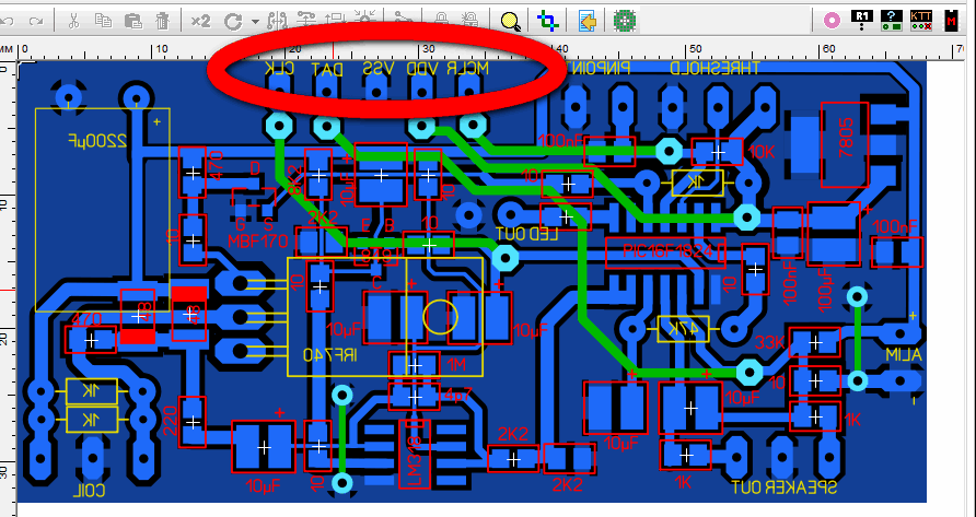

            • for which the data contacts, for which they answer. for what function?Click image for larger version
              • @ POPKA-RU
                They are ICSP contacts for progamming the PIC with PICKIT3/ICD3/or Compatible Universal programmer

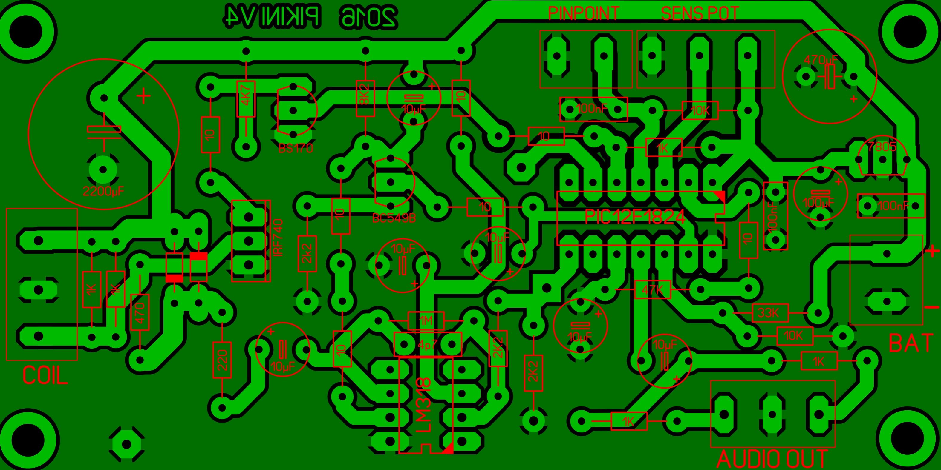

                      • and another question, are there any errors in this print?
                        • The LM318 mask is upside down. The traces around it are OK.
                          Pin 8 and 9 of the PIC16F1824 should be shorted.
                          • Originally posted by F117 View Post
                            So?
                            • Yes, it looks OK now.
                              Have a look at Arionas' layout in post #200 in this thread/
                              • Also, the coupling elco on pin 12 for the audio signal is reverse polarized.
                                Looks like you have an old Arionas layout - before he fixed all the initial errors.
