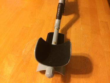

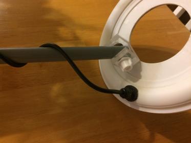

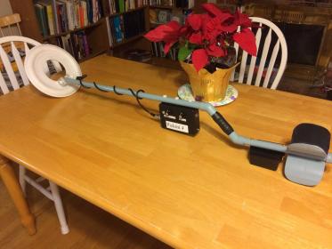

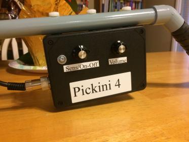

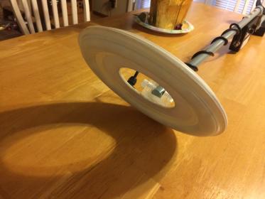

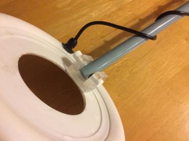

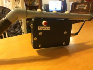

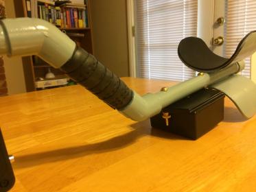

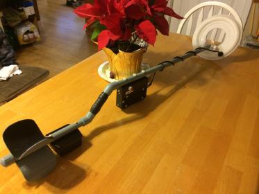

                        • Pics of my completed Pickini
                          Here are some pics of my completed Pickini 4.
                          Pics were posted a little smaller than I anticipated. You can use Ctrl - + to enlarge them.
                          I think I construct my detectors similar to the way most folks do it, but here are some construction details if anyone is interested:
                          1. All body construction is from PVC plumbing fittings. The lower shaft is stiffened with a dowel that I sand to fit inside the 1/2" PVC shaft. All fasteners are nylon, except for the brass screws that connect the battery case.
                          2. The coil housing is made of two (2) 10" styrene ceiling fan medallions glued together. I like the center cut-out that makes marking a find very easy.
                          3. The coil bracket is made from 1/8" acrylic strips laminated together.
                          4. The arm support and bottom support is a 4" PVC coupler cut in half and shaped.
                          5. The coil cable is a 3 conductor computer power cable.
                          6. The hand grip is tennis racket handle wrap.
                          7. The detector housing is spray painted with Rust-Oleum Ultra Cover for plastic.
                          8. The arm support material is from a mouse pad.
                          As soon as it stops raining here in Norcal, i'll do a video of the detector in action.
                          Thanks again to Bernard and all of the contributors.
