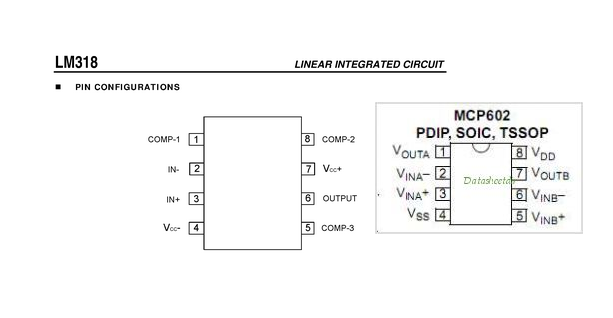

                  • Imposible, sorry
                    • can I use mcp602 instead of LM318 in the schema? and then the characteristics seem to be similar, except for food. I want to use 9v 6f22. that would shove into a smaller body, such as a tube d32-50mm

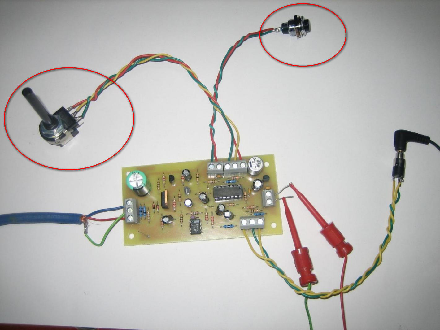

                      • какую роль этот резистор выполняет то, что она должна быть настроена для? и что эта кнопка?Click image for larger version

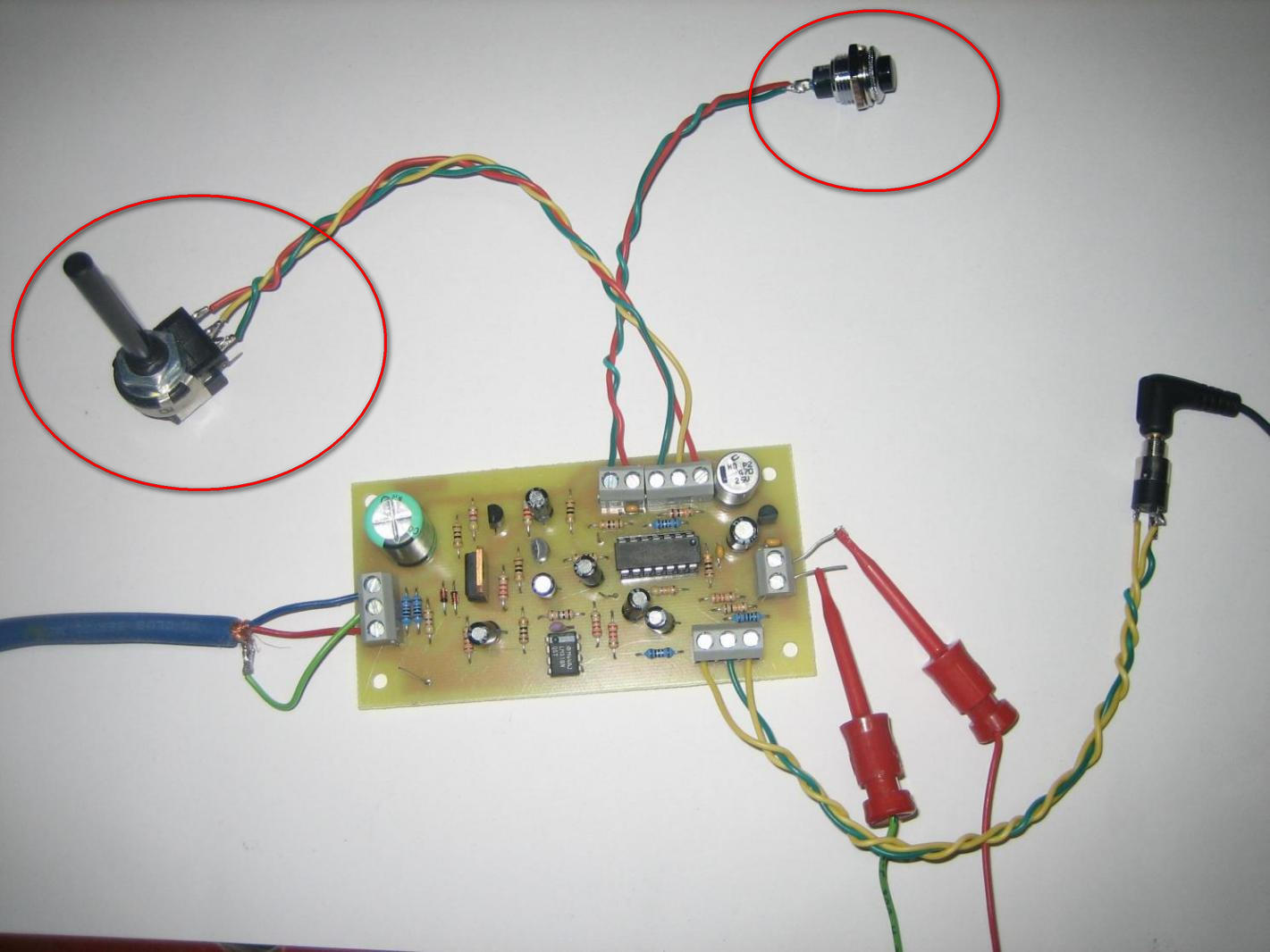

                            • what role does this resistor perform that it needs to be tuned for? and what is this button?Click image for larger version

                              • The potmeter is between 0 and 5V and adjusts the sensitivity of the detector: the higher the voltage, the more sensitive: more samples are accumulated over time.
                                The pushbutton switches the detector in non-motion mode for pinpointing. This allows you to hover over the target to accurately localize it.
