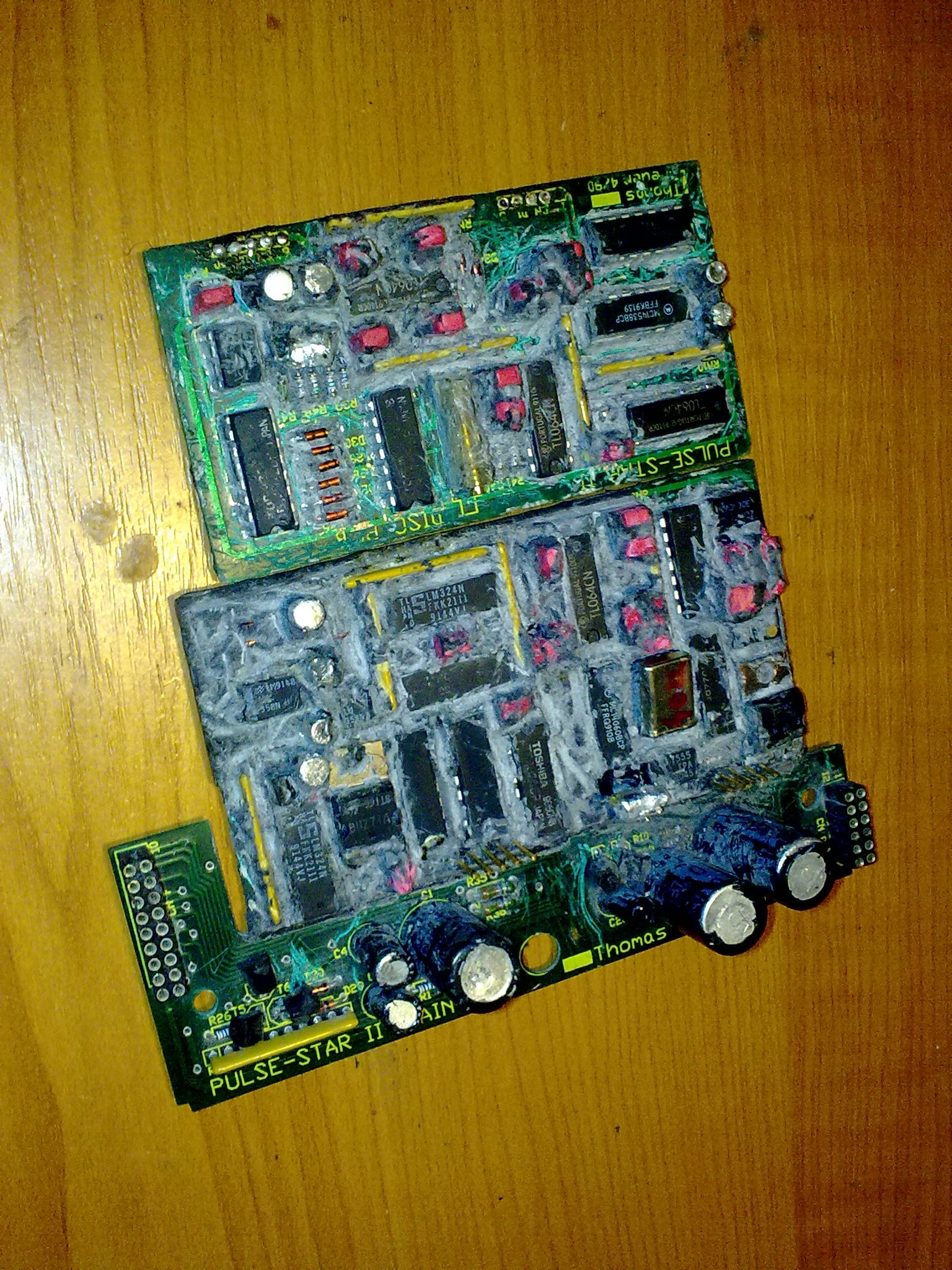

Pulse Star II (first analog version)
  • Same PCB. I think apulse is better.

      pulse star II
      • Don't go to the trouble of reverse engineering the photos.
        The original pcb has "traps".
        Without the original pcb it is not possible to succeed.

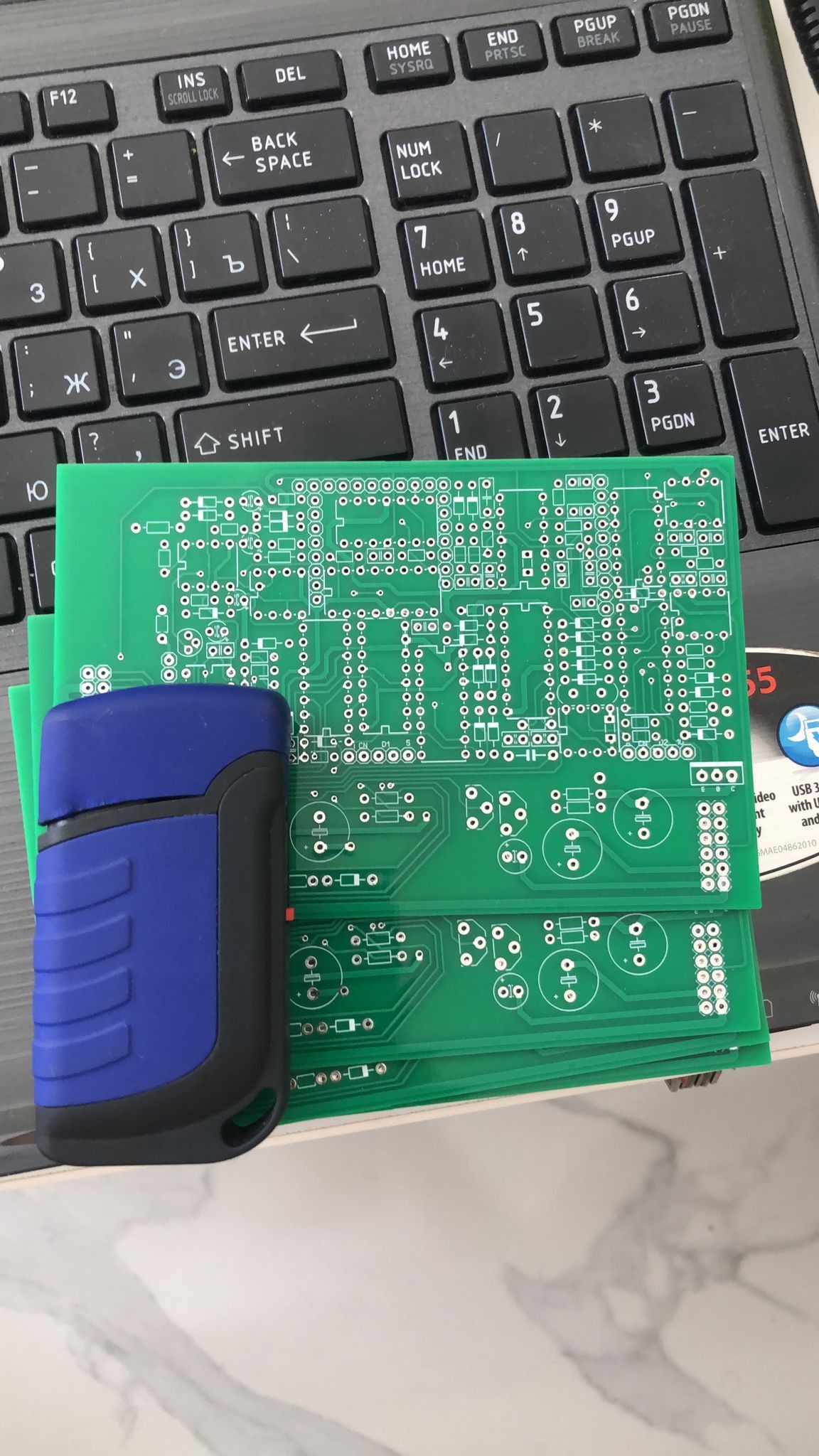

          You are quite right. I look forward to this.
          I came very close though. I must admit, it is a fun hobby.
          • Yes, I've been working at Srpint Layout for years doing various photo based tracing.
            It became a hobby in itself and a good training for attention and noticing details.
            I have so many drafts that I never materialized and probably never will.
            But the "game" is an goal and point in itself.
            • worked

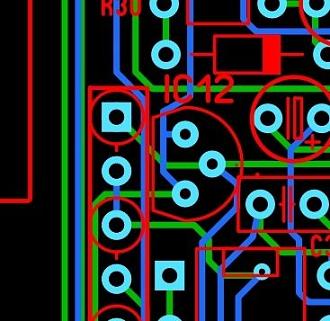

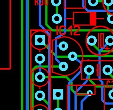

                • Click image for larger version  Name:	latest.jpg Views:	0 Size:	404.9 KB ID:	427877 I need this area in white box for completion

                      • Thanks star.
                        Labeled as IC12, TL431 maybe?
                        • pin 1 and 3 tied together. It's the only thing I can think of at the moment.
                              • As far as I remember, TL 431 was not used.
