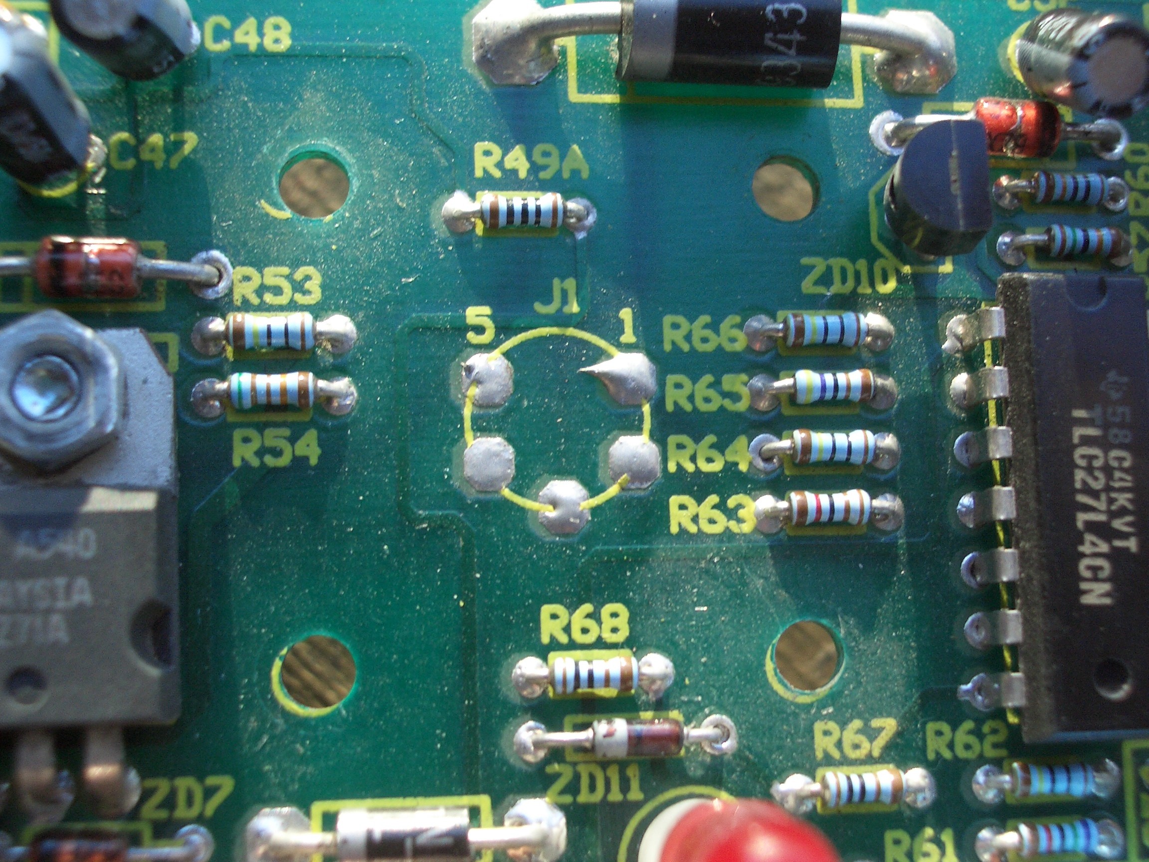

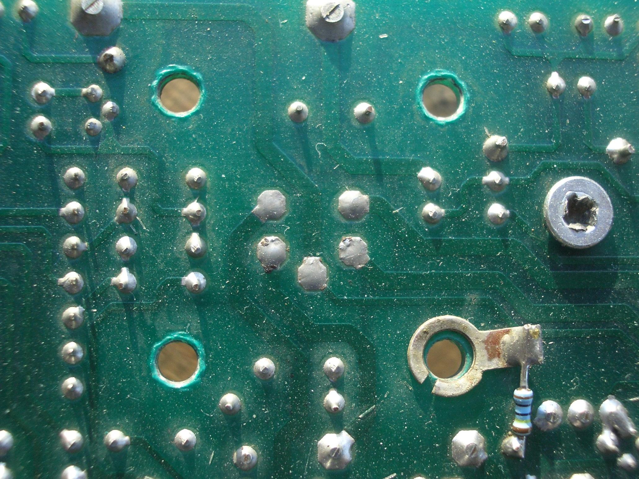

ID:	411073 коллеги, прошу вас дать распиновку разъема катушки - каие пины для заряда, пины для катушки?
      Colleagues, I ask you to give the pinout of the coil connector - what are the pins for the batt charge, the pins for the coil?
      HELP.
      • 5,4 = Coil
        1,3 = Charger Gnd
        2 = Charger Plus
        ​Click image for larger version  Name:	image.png Views:	0 Size:	73.2 KB ID:	411095​
        • thank you! i googled and found this for PS II Pro https://www.tb-electronic.de/downloa...or_assy_v3.pdf
          does it fit PS II too?
          • All Pulse Star models are compatible, sharing the same coils, chargers and pin assignments.
            So the answer is yes it does.
            • dear friends, if anyone has the schematic of the Pulse Star II device, can they send it to [email protected]?
              • thank you much amigos. face now.
                • no reaction there if i use 4 and 5 pins. then i connected 5 pin with 3, as i see in the manual 'for coils 1x1 and 2x2 meters'.
                  and got a reaction... a sound reminder me delta pulse...
                  • did a test. https://www.youtube.com/watch?v=5PT2cMsIQXM
                      • Good!
                        It is working alright!
                        Yes pin 3. is probably common ground.
                        I never had to check it so I couldn't tell.
                        Now you make larger coil, ~0.68mH and test it with it.
                        Keep the resistance of coil not bellow 1.5 ohms.
                        Just in any case. Although stock coils can vary from that.
                        I remember I have measured some coils and range is 1.5 -2.5 ohms.
                        • Yes pin 3. is probably common ground.
                          in my opinion small coils have overdamping resistors inside them. then just 4 and 5 pin used. but 1x1 and 2x2 meter coils have not.
                          3 pin is following to the resistor at pcb - ?
                          have not time to research deeply and must be back device to owner.
                          thank you.
