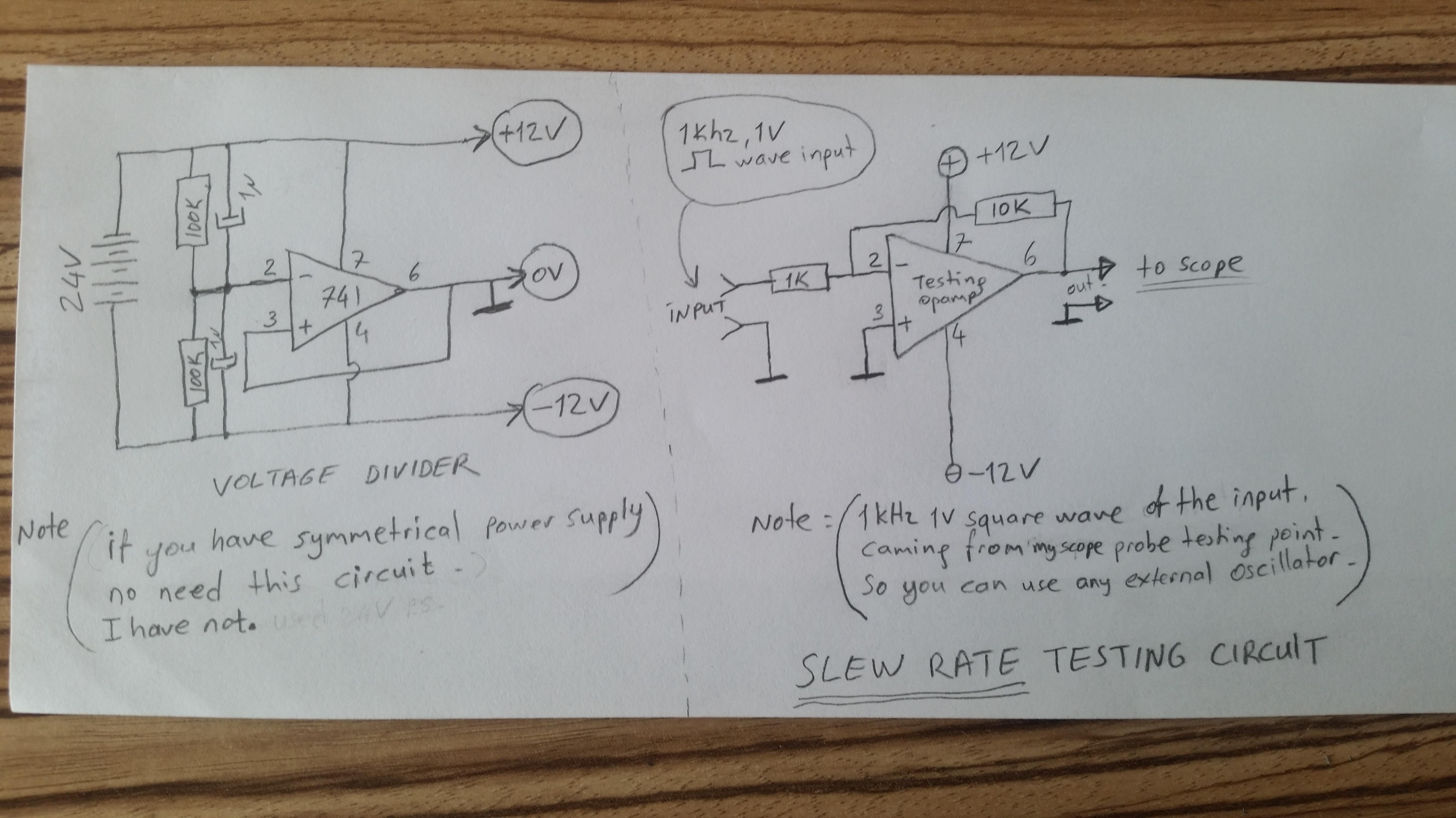

    What setup did you have for testing ?
    So it's very easy. If you have got oscilloscope and power supply.
    My test configuration is like attached picture.
    Regards.

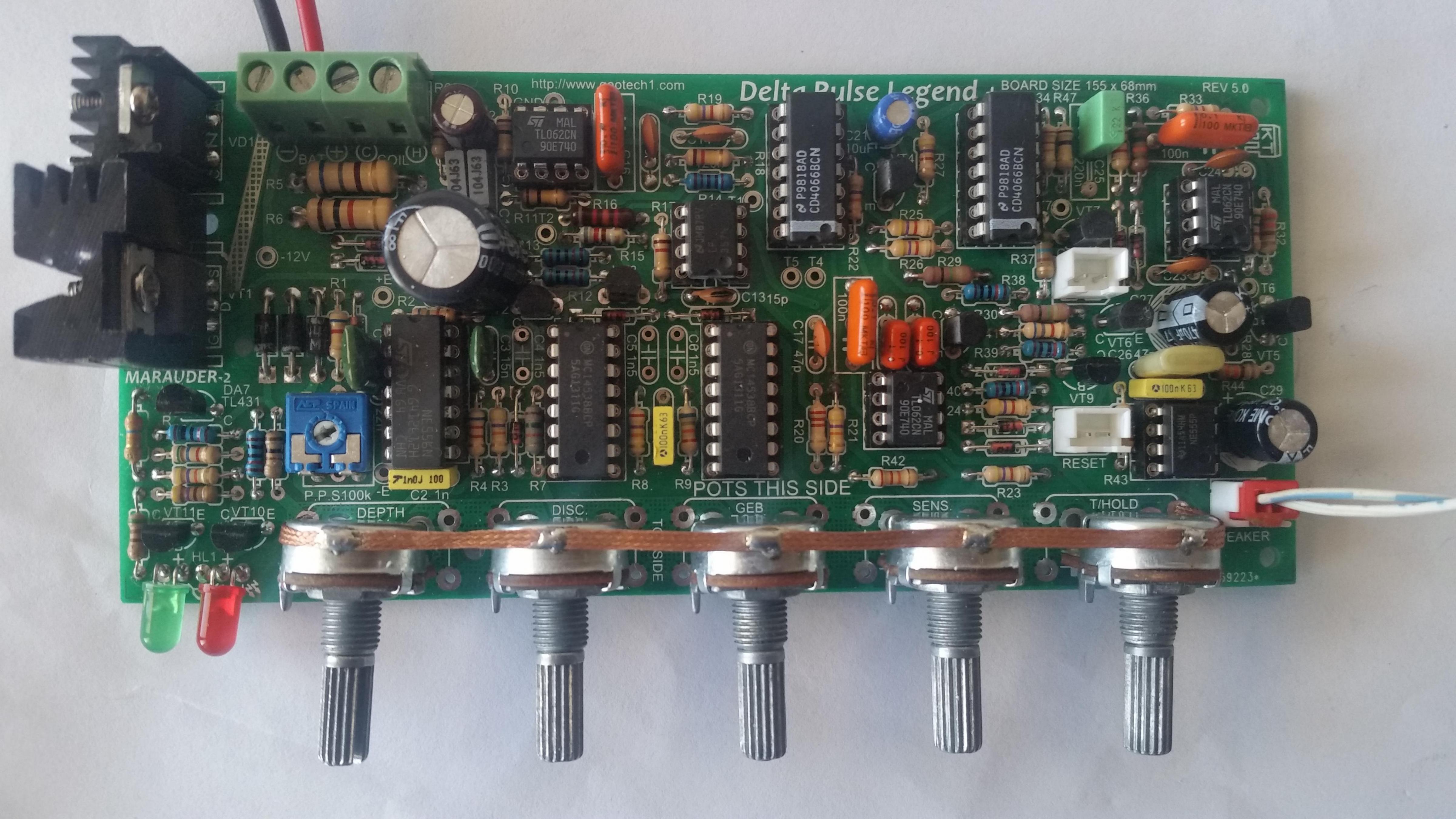

    • Hi guys,anyone have this pcb file,lay and BOM?Click image for larger version
ID:	357592Thank you very much!

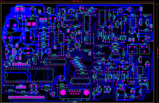

      • thank you for attention to my layout. yes, its best, no doubts. i suggest you to do turkish layout that onesided and free.
        russians do turkish and sell.
        in price of my board is laid my constant consultation. sometimes it's at huge nerves wasted, as with the pakistani. that part, consultations,
        is unfortunately invisible for outsiders but really engages 80% of the price.
        pleasure

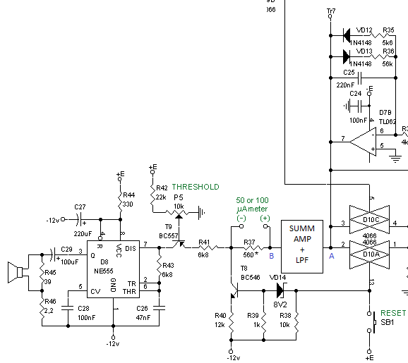

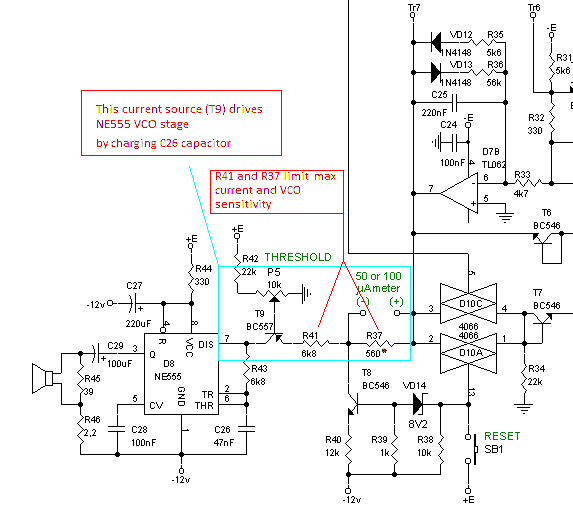

          • Can anyone provide a very sensitive voltage-frequency conversion circuit? Higher accuracy than 555
            • Originally posted by jeep6789 View Post
              VCO on 555 working good https://www.youtube.com/watch?v=1mo_khvsSvg
              do not see a reason to rego on PIC based VCO.

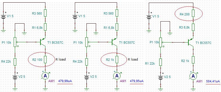

                You can increase VCO sensitivity just only by lowering R37 resistance to 100-200 Ohm. As variant place aditional 200-470 Ohm resistor in paralell with R37 - this will increase current wich produced by current source on T9 transistor (look circuit)
                I already do this in my DP unit.
Name:	Delta Pulse_NE555_VCO _Sensitivity.png
Name:	Transistor current source.png

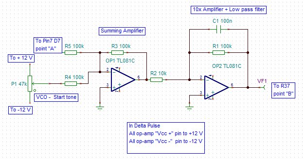

                • I have done a test, ne555 needs to increase by 10mv, the audio output has a slight change, but I want to increase its voltage by 1mv, the output frequency will change, which is conducive to improving sensitivity
                    If you want to experiment, you can add amplifier with 10 x gain + filter and finaly drive VCO.
                    This idea not mine it was already posted here on forum. Here is my re-drawing.
Name:	Delta Pulse + Summing amplifier & LPF.png
Name:	Delta Pulse_Summing Amplifier + LPF+10 x Gain.png

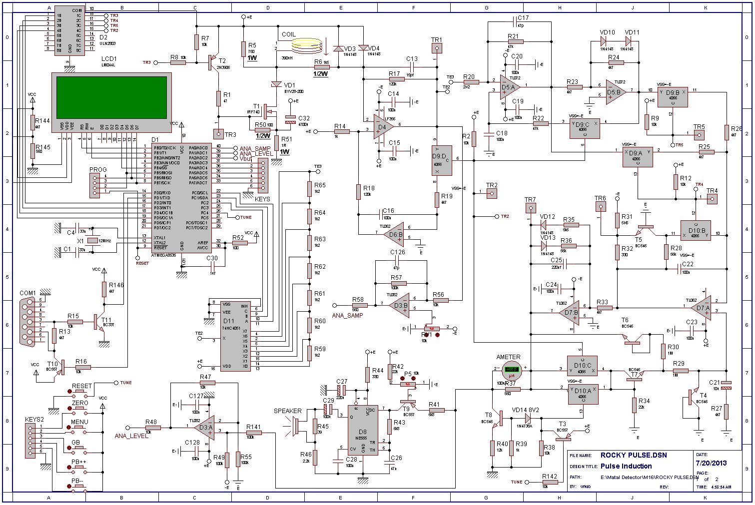

                        • Hi KT315
                          Where is roky pulse file?
                          Are you have proteus file ?
                            see rocky pulse
                            Hi KT315
                            • just some pics. no proteus. no free code. no gerber. zero point.
                                Ok . thus again delta pulse is number 1.
                                Some design must be test but delta pulse is also perfect
