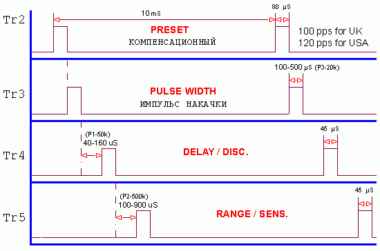

  • I do not see the delay even on your pic. No delay. you can line an abscissa axis Y where you want at the diagram. either going into a pause or into a pulse.
    NO matter. without a reference to signals. TR2 is the primary frequency, TR3 is a PULSE WIDTH being tuning, with this frequency.
    • KT315 there is a delay pulses generated in the 556 in point TX approximately 80 us in respect of the initial pulse (TR2 )...?????
      Look at the video...???
      In your own delta position is different ???
      which explains and stigma in picture which I have previously shown..
      http://youtu.be/I1CqFezic0Y

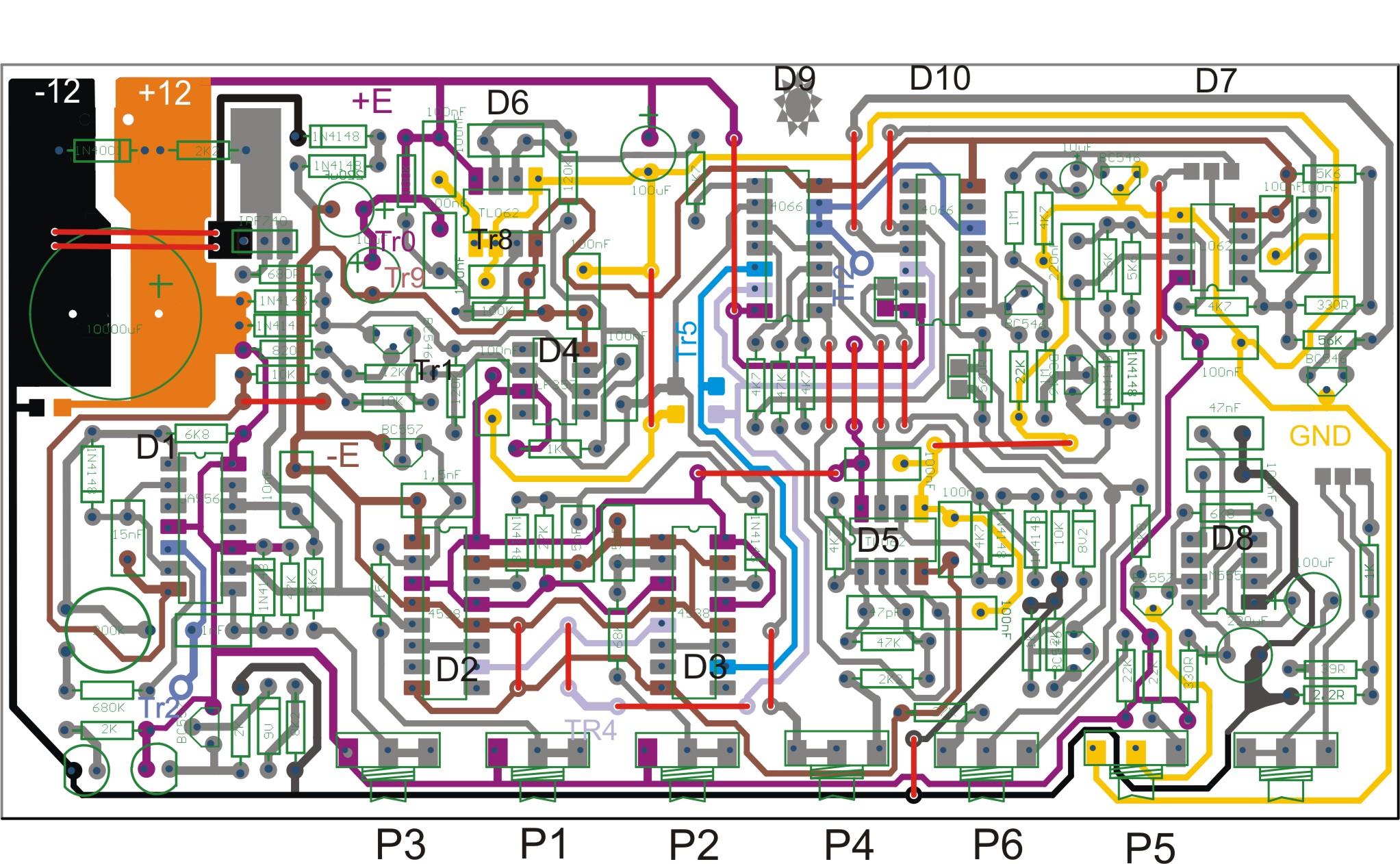

                      ok i make dp2 first(becuase i have not correct 2box pcb)
                        Thanks for Reply saromines ramil
                        The problem still exists if possible Instructs me to Measurement places in this photo
                        If possible, explain to me
                        • Originally posted by koko22 View Post
                          [ATTACH]26963[/ATTACH]
                          where????????
                          • any your comments suggestions on the placement? what to add or to change?
