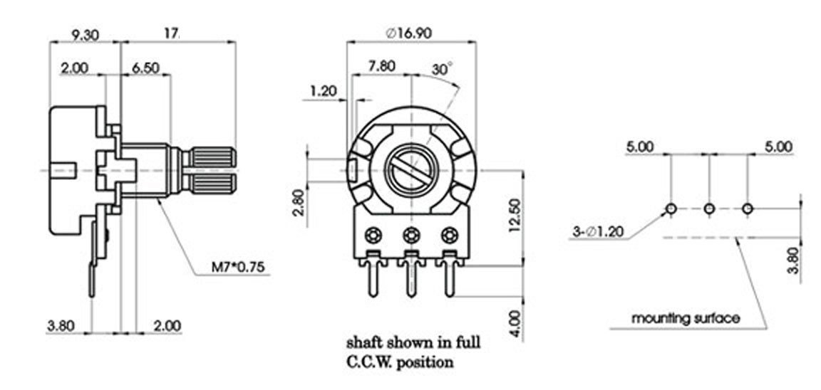

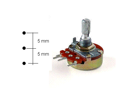

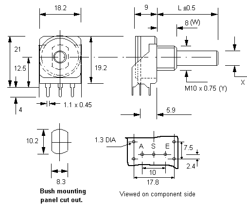

                  • any your suggestions on pots' type? what type you would like to use?

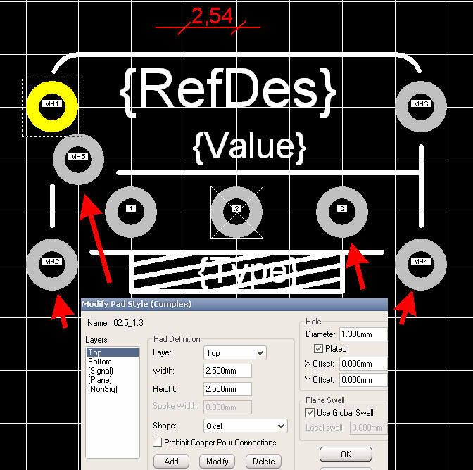

                          • pot pattern with 5 mount holes as I present it like more universal for different types of pots.
