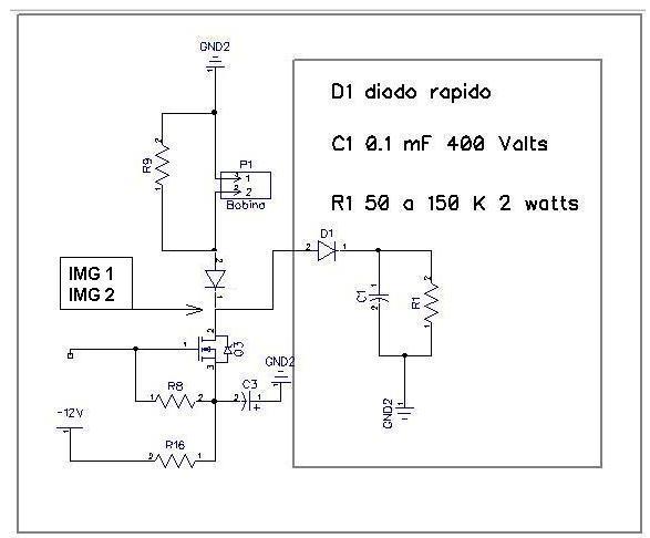

    It can be used in conjunction with the series diode between the MOSFET and the coil.
    Even with the diode series, one can observe high voltages in the MOSFET, with ociloscopio.
    In an experimental detector (not Delta Pulse), series and use diode voltage limiter to prevent noise generated by the zener protection in the IRF740.
    Also decreases the heat generated in the MOSFET.
    As I am using IRF740, R1, is set to cut approximately 380 volts.
    As KT315 says, you can lose performance in some cases. You can always return to the source schema.

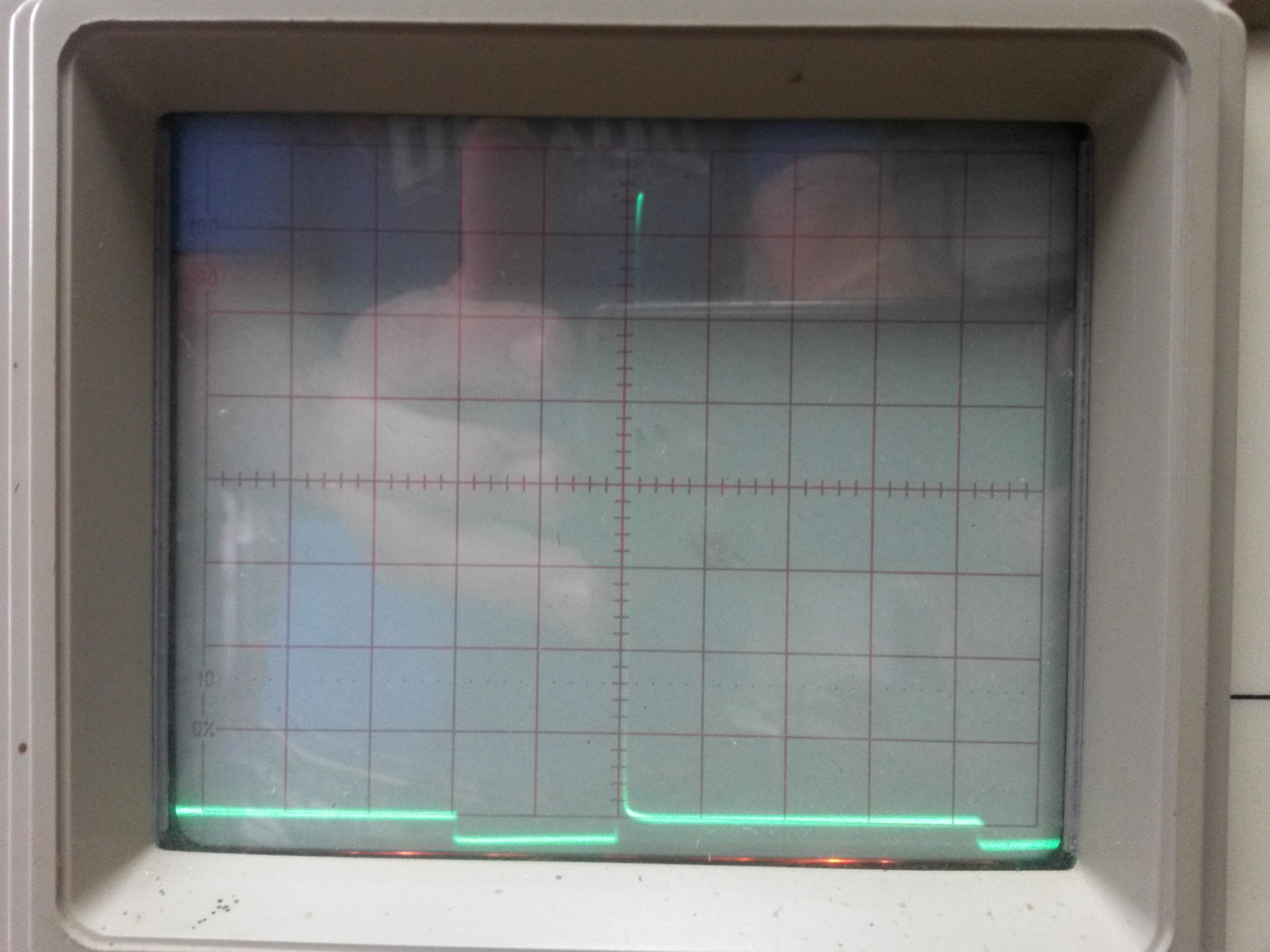

    Jose, the high voltage across the mosfet ? Can you describe this more ?

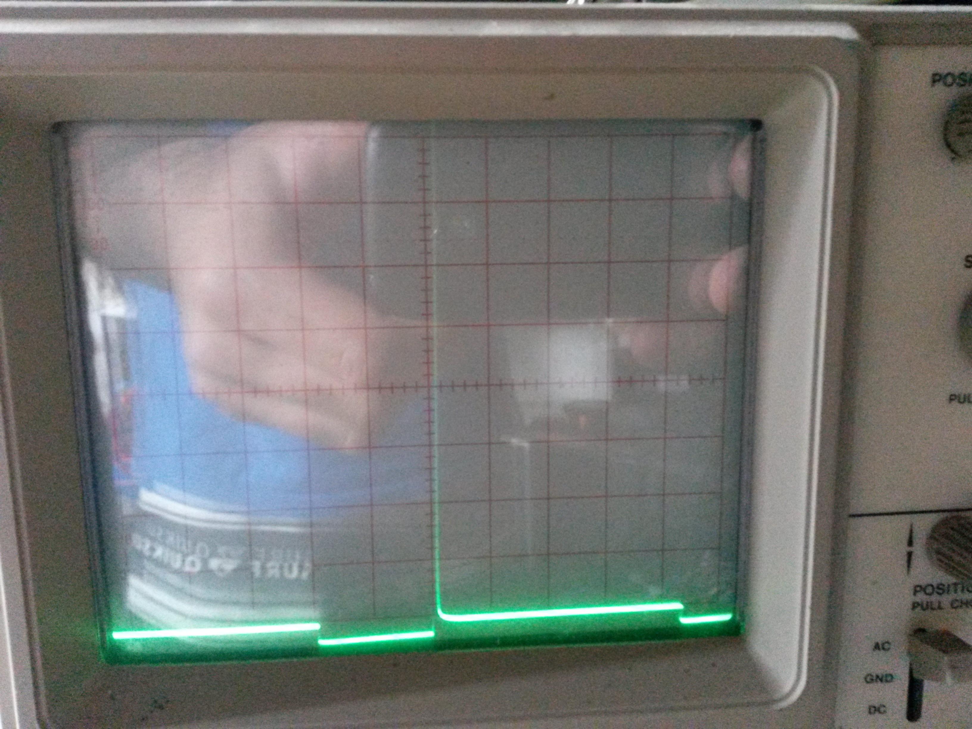

    • Hi Greylourie
      The use of a series diode between the MOSFET and the coil continues to exist high voltages in the MOSFET, as can observed in "IMG 1" picture.
      In "IMG 1" the limiter is disconnected. Each box represents 50V, the peak voltage, out of scale in ociloscopio.
      In "IMG 2" with the limiter enabled, observed the peak voltage, is cut before reaching 400 volts.
      In the "voltage limiter 2" scheme, is observed the point where the ociloscopio was connected, for measurements.
      Jose
        R8 - 10K
        R16 - 1R / 2watt
        C3 - 4700uF/2x4700uF/10000uF 16V
        The diode connected with the drain of the Mosfet can be 200V (example: BYV28-200- this is seen on PIM-2 schematic, also in SD2000),
        though this is opposing of the suggested high voltage STTH1210 (1000V), perhaps this diode is not meant to limit voltage of the mosfet in the delta pulse unified.

          The component values are correct.
          As for diodes, the truth is that I'm using components recovered from old monitors.
          When I see the values, I consult online, and you chose the highest tensions, and 3 ampere current .
          I think it's wise to choose values greater than 500 volts, for DP.
          Jose
