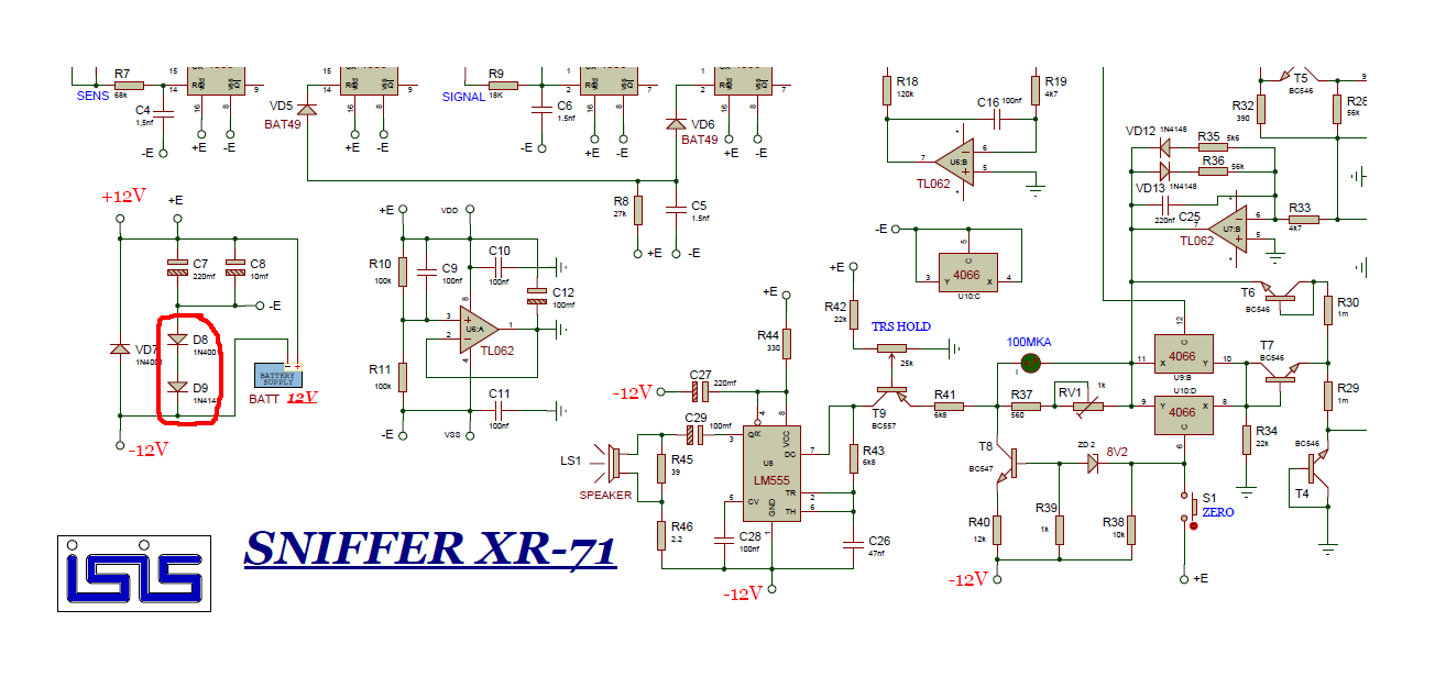

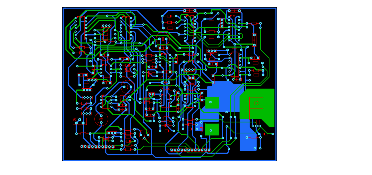

  • VD8 or VD9 or both burnt. in new revision board i changed them on 1N4004 type with more current.
    • thank you very much, I have no schema do you have a PCB image that shows these dides ?
      • look in center of board.
        post pics of board.

                • i also asked photos, i do not need a layout, i have them batch. your board is sniffer xr-71 clone.
                  • on the kit it is written : sniffer xr-71p Ver1.34

                          • is it the right schema, and the right diodes Mr Kt315 ???
                            • right schema
