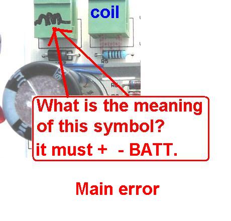

  • Originally posted by sparky View Post
    Change ifr740 to a new one?
    Change d9,d10 to regular 4066 chip?
    Jap.. are you with teknolojlekibi.com?
    Hi sparky
    The main error
    best time

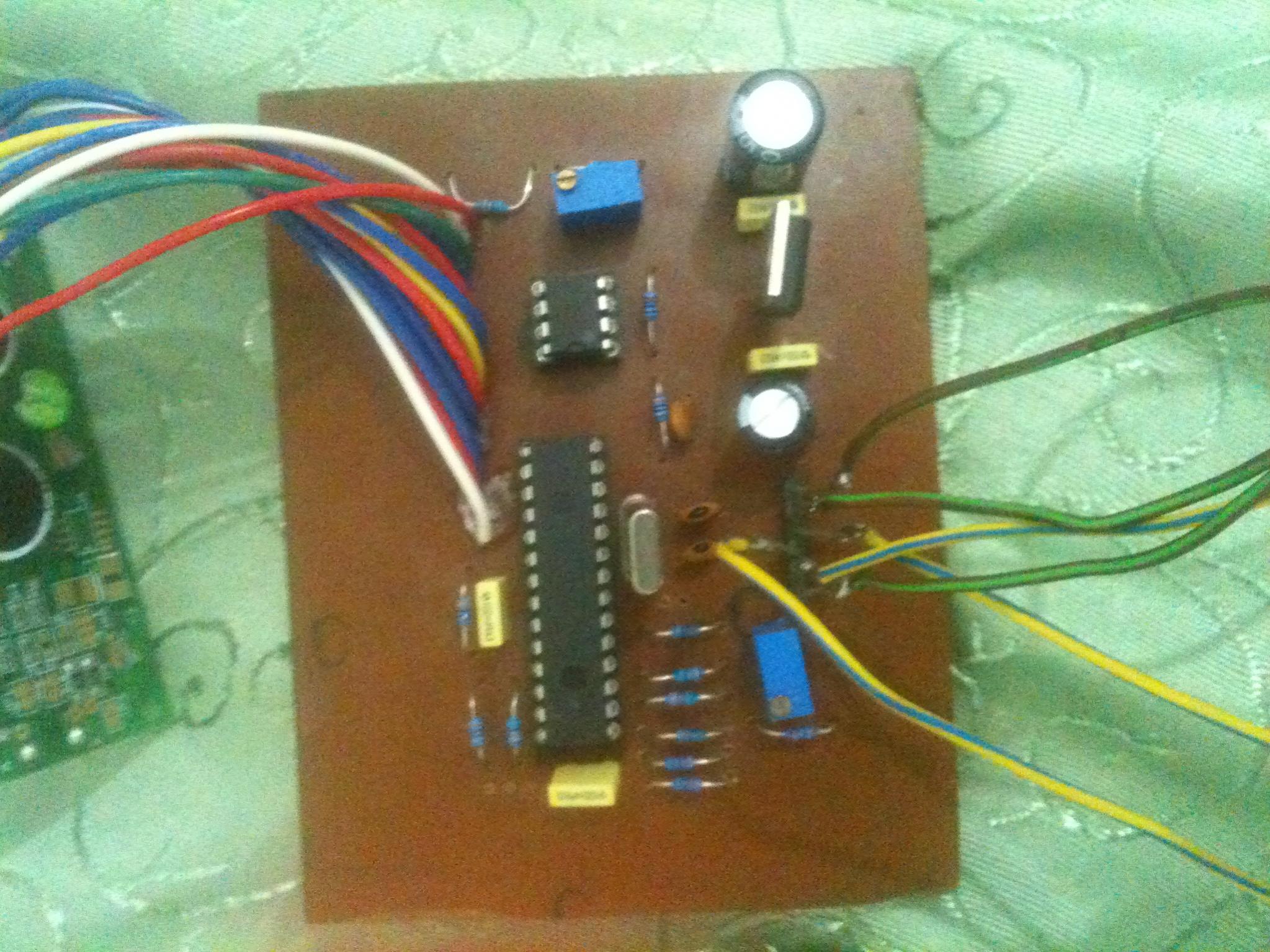

      hi jap
      I built a new pcb I change the position of 7805 there is light on the screen but the pic does not work.
      is what I can find out what is the problem?
      thank you very much
      best time
      pigeon.
      • Hi pigeon
        may the error from conection pin of data.. if lcd conection is OK .then(re programming hex and test)--->if ,,, bad pic .
        best time
        j.
        • Originally posted by jap View Post
          Hi sparky
          The main error
          [ATTACH]21473[/ATTACH]
          best time
          j.
          That was a plug from another project. I hook it up like this. Is this right?
          http://i108.photobucket.com/albums/n...25-12/dppw.jpg
          • Hi sparky
            OK,,it is right,what a results(after Change irf740,d9,10) ?
            best time
            j.

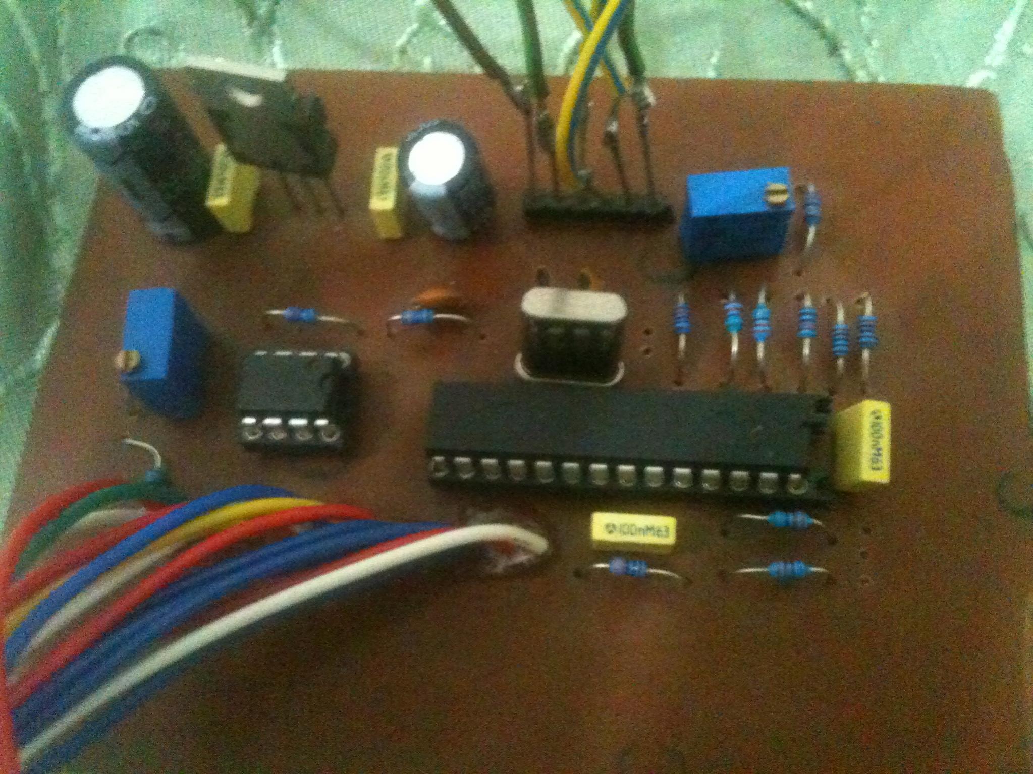

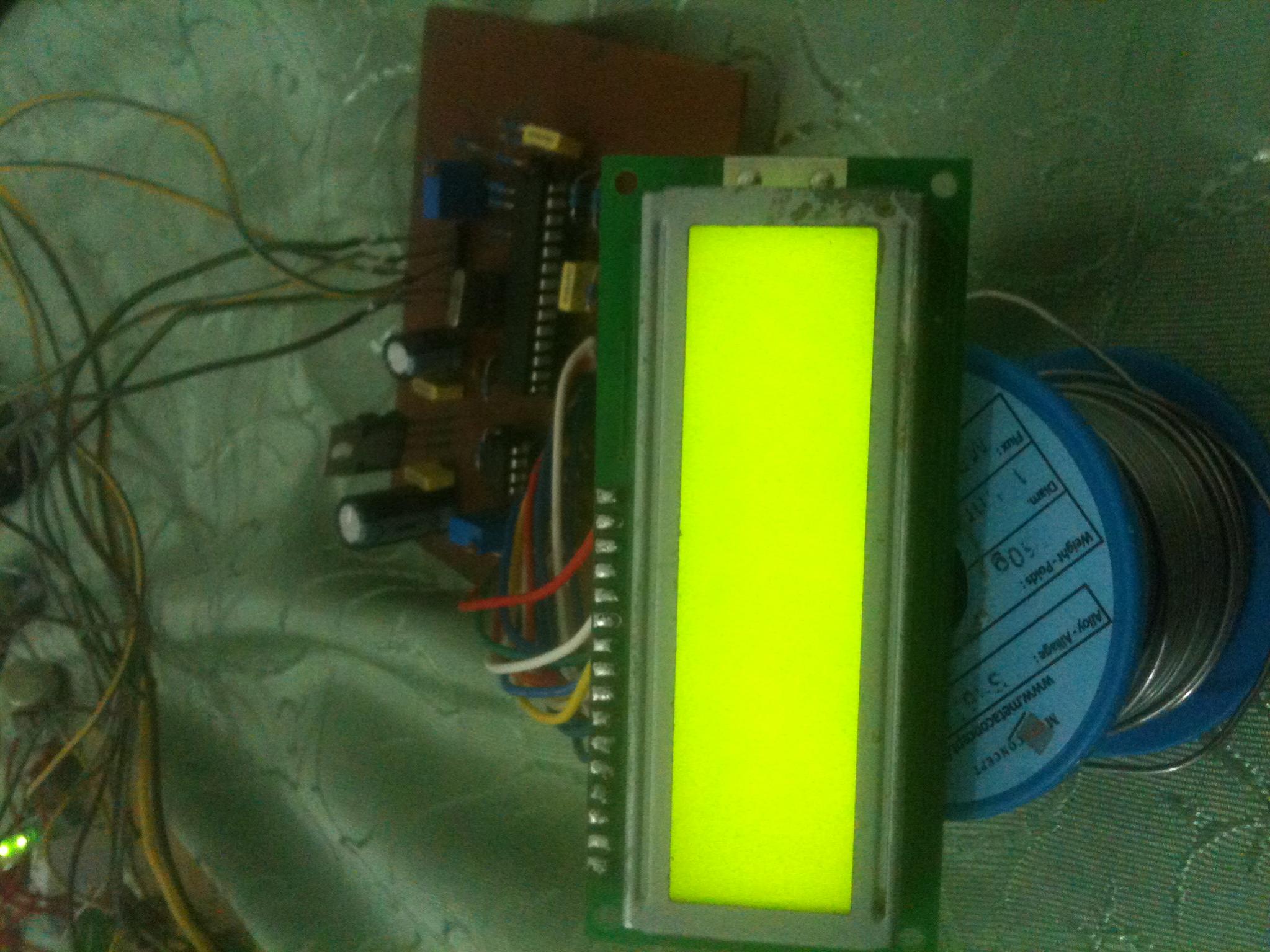

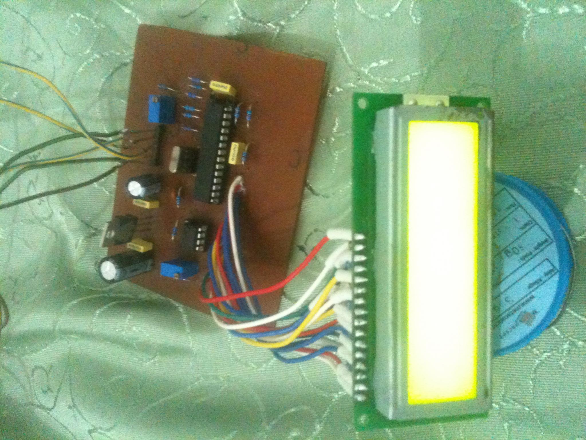

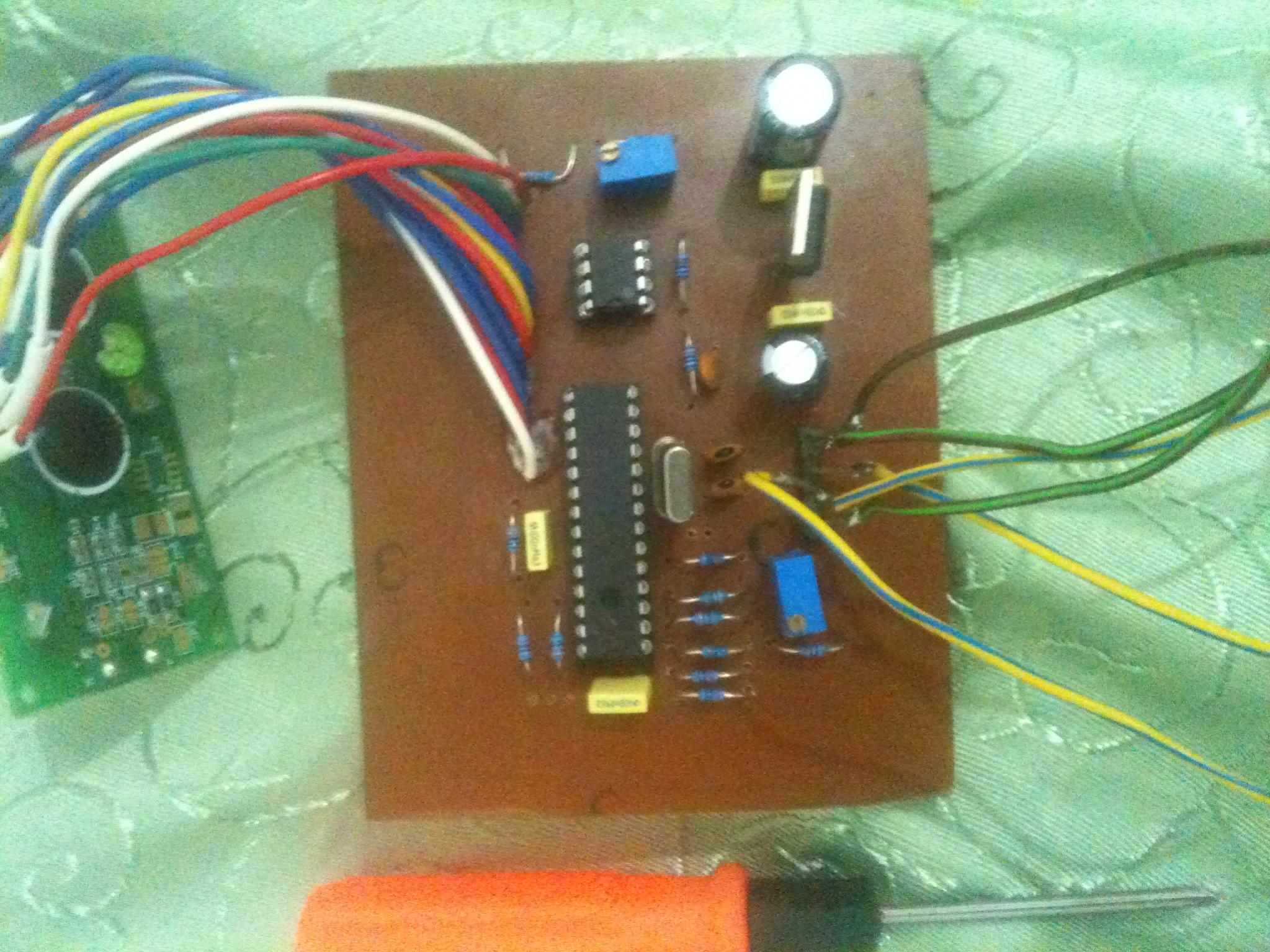

                      • hi jap
                        this the pictures.the problem is that the screen works but it does not display anything.
                        thank you
                        best time
                        pigeon.Click image for larger version
ID:	333609Click image for larger version
ID:	333611Click image for larger version
                        • Hi pigeon
                          What the # of LCD ?
                          best time
                          j.

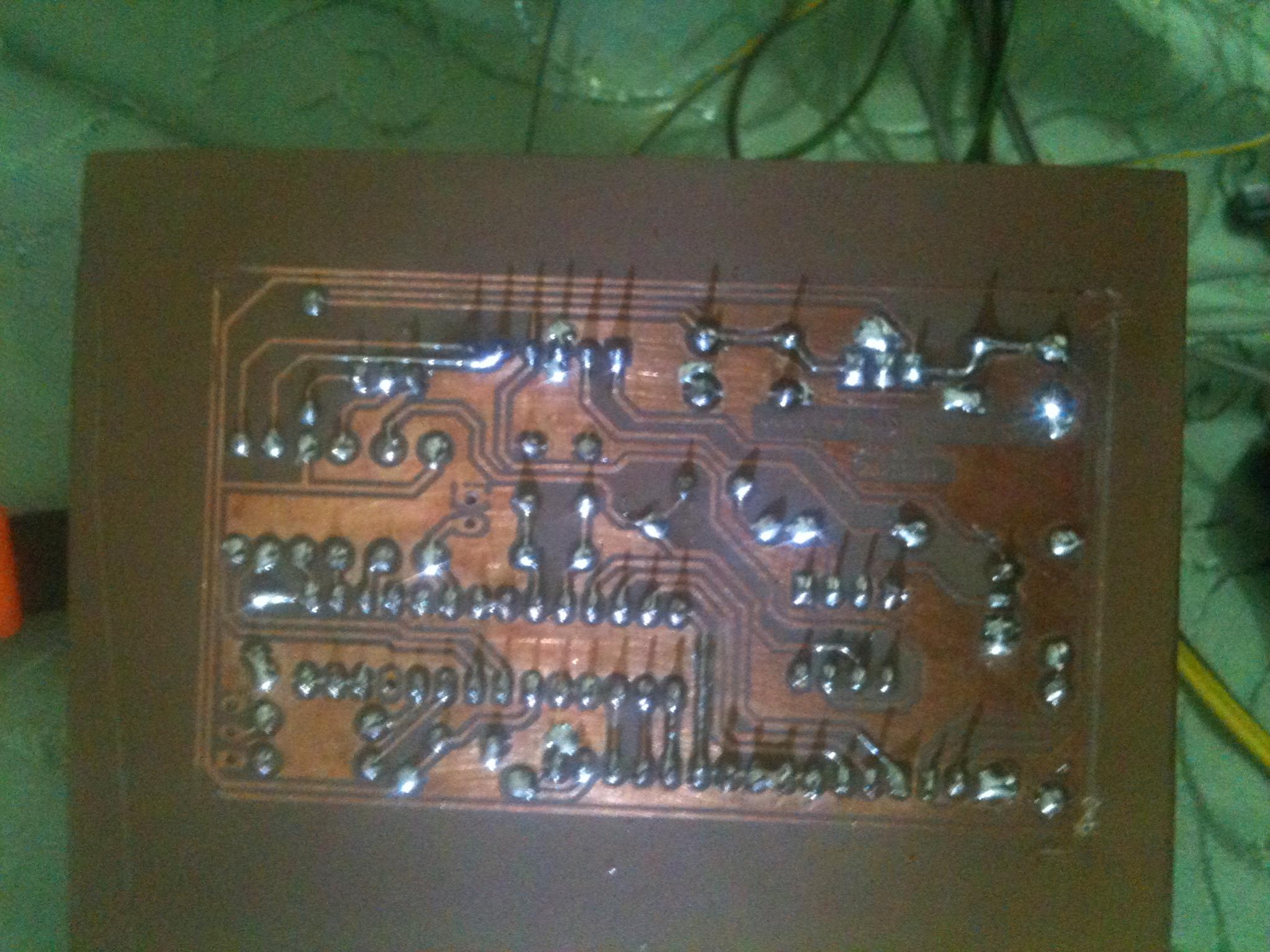

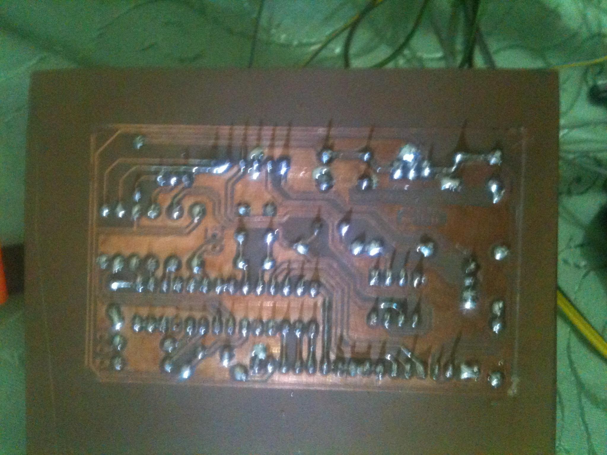

                          • hi jap
ID:	333614Click image for larger version
ID:	333615Click image for larger version
                            • Hi pigeon
                              -What the number and type of LCD ?
                              best time
                              j.
                              • Reduce the brightness. He works according to me. The brightness it you may claim it on LCD VEE foot. Can U upload the schematic too? Please!
