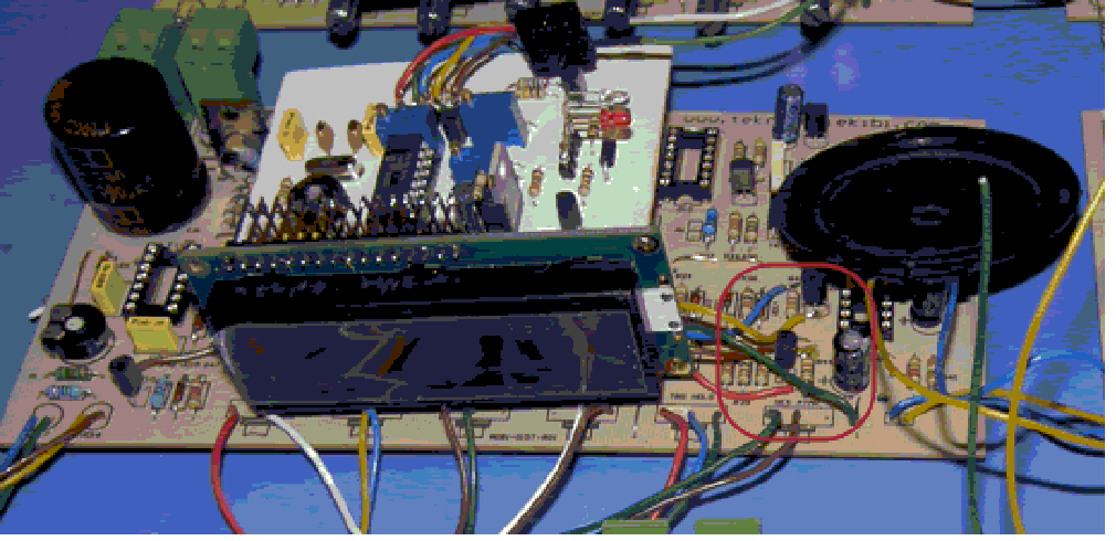

                • LCD problem
                  It LCD at me 25,5V shows. He was good till now. I don't understand. What may be his trouble? Can you help me?
                  Thank you
                  • Originally posted by szucs_g View Post
                    Thank you
                    Clear of the value of voltage is twice multiplier - there is a mistake in the value ​​of resistor compiled in pcb of LCD.
                    best time
                    j.

                      And if the PIC is corrupt?
                        -The PIC works or not works.
                        - If the PIC is corrupt,, Reprogramming the HEX file.
                        best time
                        j.
                        • Hi jap you can help me
                          for the connection of the LCD
                          I send you the PCB and
                          LCD shema
                          thx
                          • Hi jap
                            I found this image it can help you
                            but I not understand
                            please everybody can help me

                              I have reprogrammed but dont work well. The 10k pot must I adjusting for correct volts above the pic?
                              The statusbar move very rapidly to. :-( I dont know what happened it.
                              All connection is right (A,B,C,D,E) and this until time right working...
                              • Originally posted by Nicolas View Post
                                Hi jap
                                Look at this...
