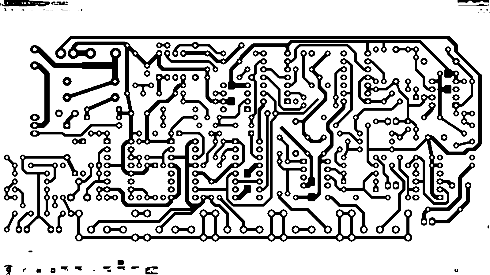

  • hi kt315
    this pcb is correct. this is my best i'm still a beginner
    thank you
    best time
    P.
Name:	pcb delta pulse k315 ok.png

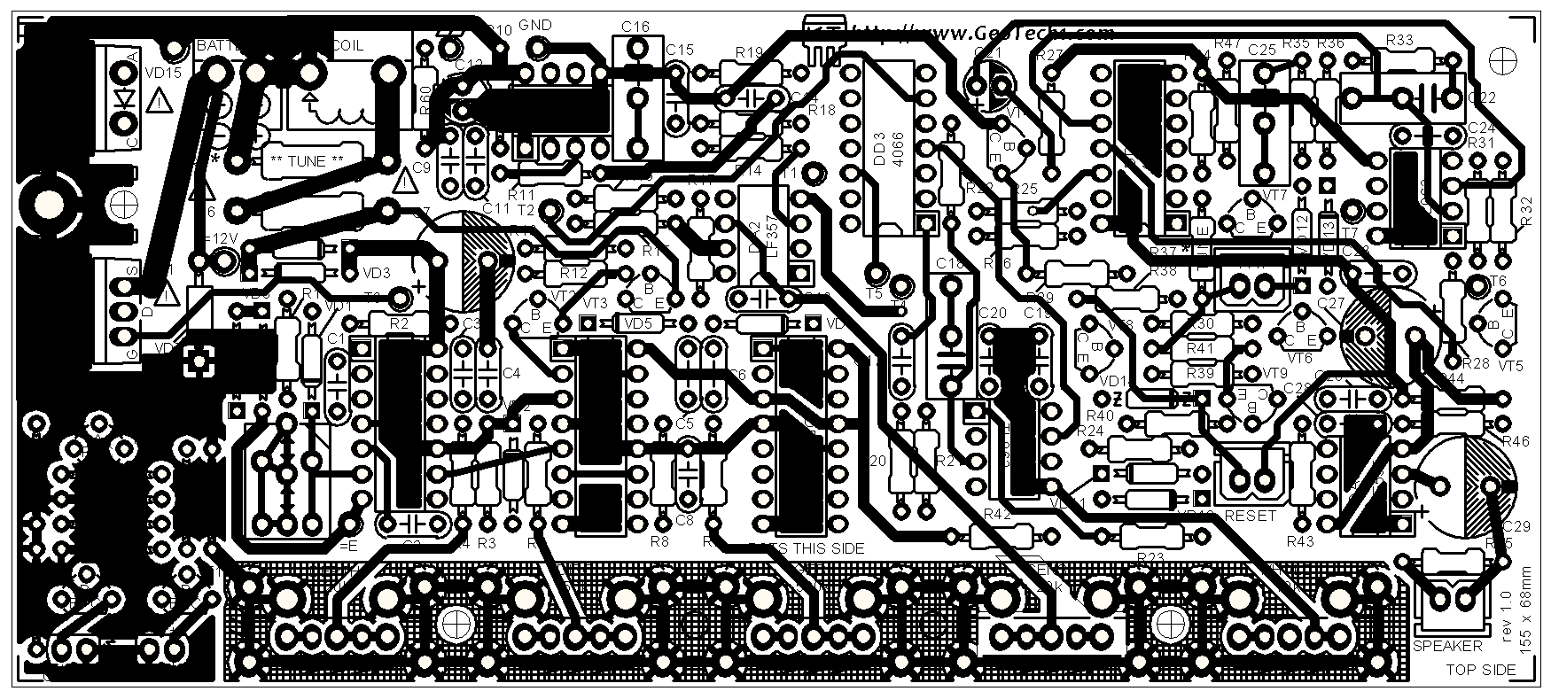

    • GEOTECH SERBIA English version.rar
      • top side
          [ATTACH]27558[/ATTACH]

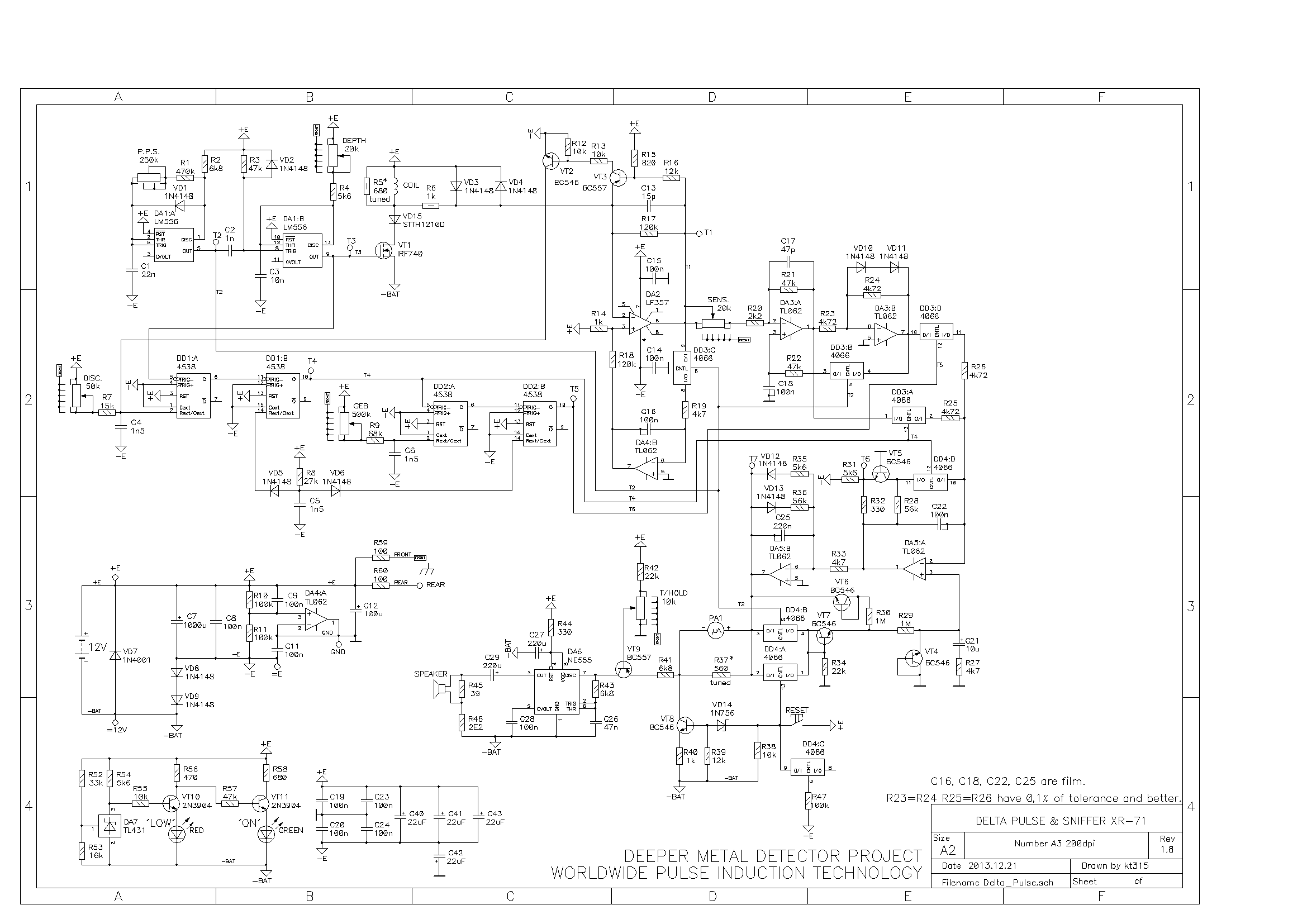

                      revision of the schematic. in P-CAD 2006
                      [ATTACH]27502[/ATTACH]

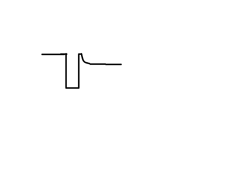

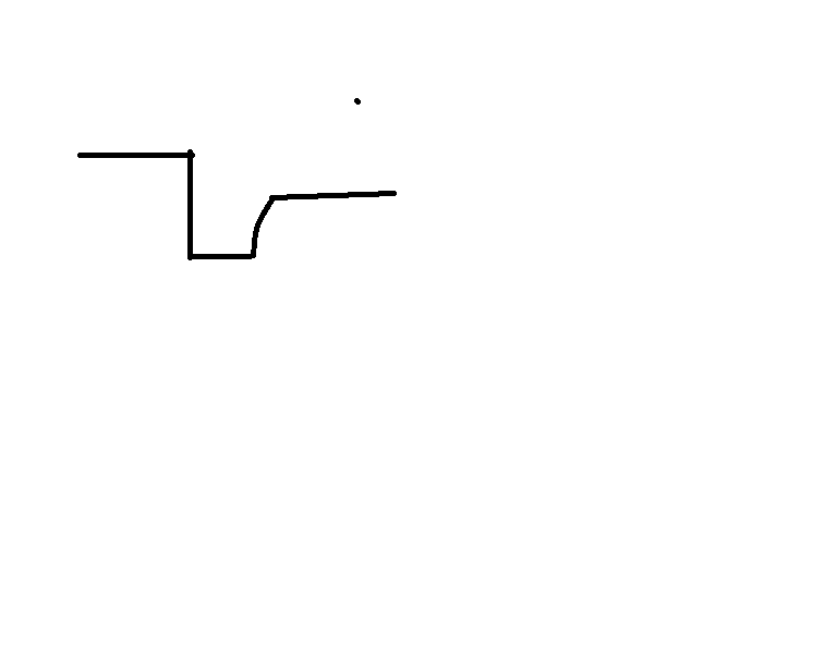

                      • hallo ... which lf357 pin6 signal it correct ? 1. or 2. Click image for larger version
ID:	338697Click image for larger version

                            hallo ... which lf357 pin6 signal it correct ? 1. or 2. [ATTACH]27595[/ATTACH][ATTACH]27596[/ATTACH]
                            do you see what there written on R5????
                            • circuit diagram
