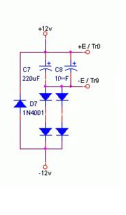

  • i have problem whit vd12 and vd13
    Originally posted by Jose View Post
    Generally these diodes are burned during rehearsals, when we make a short circuit.
    Disconnect the coil and measure the total consumption, the value should be 40 to 50 mA if all is well.
    If burned during power up, the cause could be very high value capacitors C7 and C8.
    Normal for C7 and C8 is 1000 and 10 mF.
    Can utizar other diodes, but it is preferable to find the cause.
    Jose
    • I too have this problem with THE diodes.
      As a solution I use alongside two other diodes with good results..

      • Originally posted by aaksts86 View Post
        tnx .... i fixed problem
        dead 1N4148
        Changed 1N4148 .. but after 30min burned down again :/
        maybe can be replaced with a better diode?
        Which one of the 1N4148 was it that burns? I assume that it was in the timer sub-circuit, but that still leaves two to consider.
        • Originally posted by g.s View Post
          [ATTACH]27499[/ATTACH]
          there must NOT be the problem with the diodes. something wrong you have. thinking SOURCE pin of IRF740 you connected to (-E) point instead of it must connect to
          (-12V)= (-BATTERY).

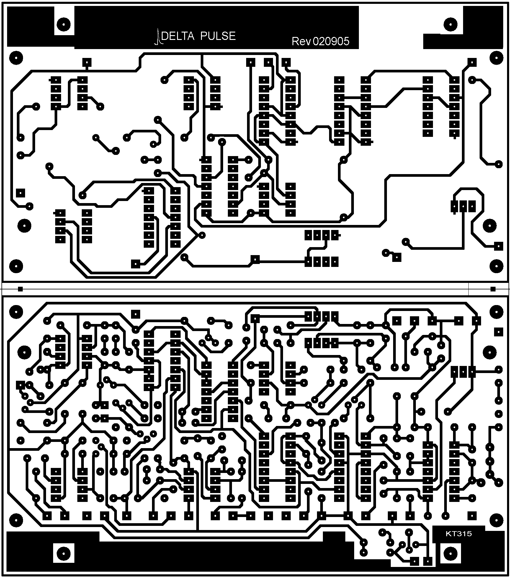

                    • PCB revision
                        PCB revision

                        thank you very much for this new version but where is the pcb file to print.

                          Hello Kt315, some time I rode the Delta Pulse, based PCB posted by you, very good, working perfectly.
                          This new PCB has performance improvements over the other?

                          • hello Baterista, new PCB is based on this bulgarin design you attached. all that I see and have to add I added, all improvements, cooper pours (polygons), optimal tracing, etc. I added tantalum caps on bottom side too people could be learn to solder SMD. I especcially do not do a design in SMD because I noticed very small folks may solder SMD components, while I want to make PCB more adaptive and simple for beginners in electronics.
                            • Mechanical stress is a good reason in favour of through hole design. I also tend to avoid tantalum for it's morally problematic origins - if I can help it.
                                Thanks kt315, this new layout seems very good. I also agree with the "DIP" methodology, for me get SMD components is very difficult.
