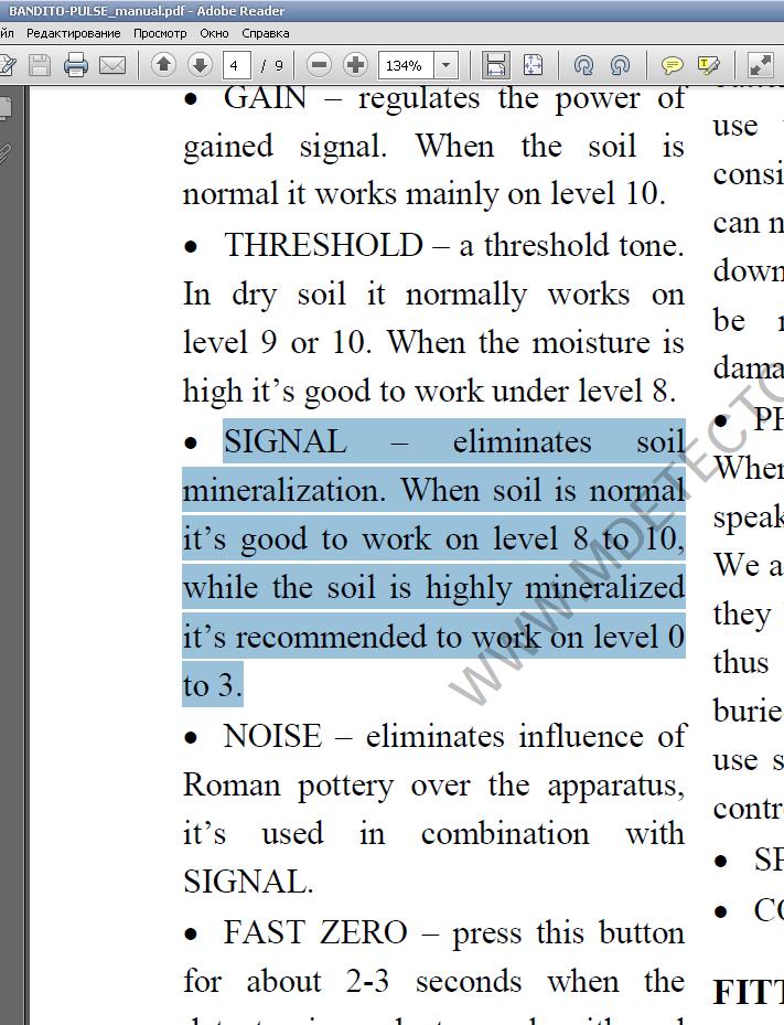

                    What I am most interested in finding is small gold..! if I can locate even small amounts then I can at least clean up with panning. I already own a VLF machine which is great for the odd coin shooting at the beach but it is totally useless on the gold fields..! I experimented about 10 years ago with the older designs and have been keeping a watch full eye on the progress on the net and the forums and feel that now is a good time to revisit.
                    My ultimate aim is to develop a PI which can discriminate between ferrous and non ferrous metals and I have already seen that the PI has the capability to do this and I am willing to work through the current designs available now and to experiment later. When I mentioned stable performance what I was trying to say was that I was looking for a design that provided the SAT with good ground cancellation and the MiniPulse clearly solves both of these issues. I am still trying to understand the Delta Pulse circuit but it seems to me that it also provides a SAT just that I can not work out how it compensates for the ground.
                    I have spent the weekend reading the book "Inside the Metal Detector" by Carl Moreland and George Overton and would highly recommend this book to anyone wishing to develop their own design.
                    I like the George Overton design because it is easy to experiment between dual and single coil configuration, I understand the circuit and it is simple to set up and use so will try this first.
                    I would also welcome some more information regarding the operation principles of the Delta Pulse as I like the performance I have seen so far on youtube just that I am finding it difficult to understand the circuit mainly because I do not have any information regarding the T2, T4 and T5 timing so I will consider to put this into Proteus if need be.
                    For the time being it is my intention to evaluate two or three designs and to eventually convert one of these with MCU and provide some more adjustments by way of a digital encoder and display and to eventually experiment at adding software routines to add discrimination.
                    Q - Regarding the Minipulse design I note that in the book by CM and GO they recommend to use a 4066 instead of JFET's. Do you think the sampling integrator would benefit by replacing the JFET's with a 4066..?
                      dp pulse does not graund balance Ground balance is done the two channels etc.Look a little more forum !
                      bla-bla-bla. and zero of information like always. read the F manuals of DP. look a little more forum YOURSELF.
