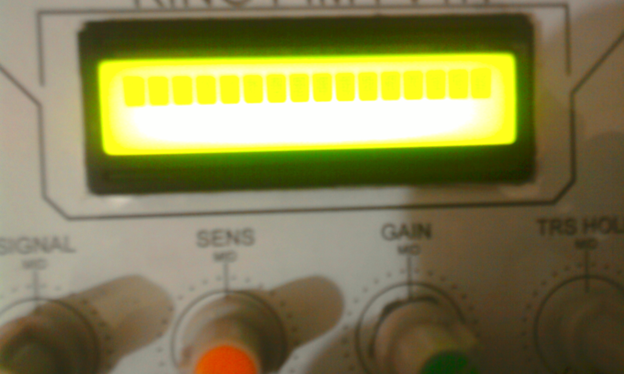

      I thank you Jap the program to another program such Microchip. programming is unrolling correctly but still the same problem
      The display is completely blank no program opens.
      Against by a similatuer ISIS hopefully.
      I try to program three PIC but no reading on LCD.
      I think the Hex file is corrupt.
      I ask someone who owns a file is good if walking with his detector can share.
      Cordially
      Nicolas

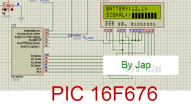

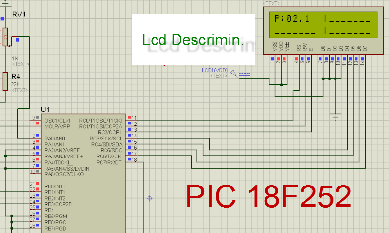

        Programming the PIC 18F252
        I noticed this error
        So I only lighting on LCD but no program
        Note: The PIC used is a 18F252 - I / SP
        becaufe the 18F252 - E / SO does not exist
        What do you think? Error range of PIC.

        One thing you need to watch out for with the 2-line 16 character displays, is that they do not all conform the specification. The green LCDs with 16 pins in one row along the bottom of the PCB, need a +5V supply for the contrast control; whereas the green LCDs with 16 pins in two rows on the side of the PCB, need a -3V supply. With the latter type you can see the characters in the display very very faintly if you connect pin 3 to 0V. This will tell you that it is expecting a negative supply for the contrast control. If you're using a PIC, then a simple solution is to use a spare output port to drive a diode pump, and thus generate the required negative voltage.
        • I had the problem in the dialog of Nicholas and solved it by putting an inexpensive blue screen.weird happened! regards
          • Originally posted by sakis1 View Post
            I don't think the colour of the screen makes any difference. It's the voltage required for the LCD contrast that is important, and I suspect your blue screen LCD requires +5V.

                      Hi everyone
                      We encounter problems in scheduling two types of PIC to LCD
                      PIC 16F676 is the PIC 18F252 is also
                      I tried many times but no good result.
                      And I do not think the problem is related to the type or color of the LCD
                      the problem is due or Hex file.
                      Dear friend If somebody has managed to worked their Delta Pulse with the two types of program
                      If we can help when sharing files uncorrupted and some trick noticed and notes for correct operation.
                      cordially
                      Nicolas

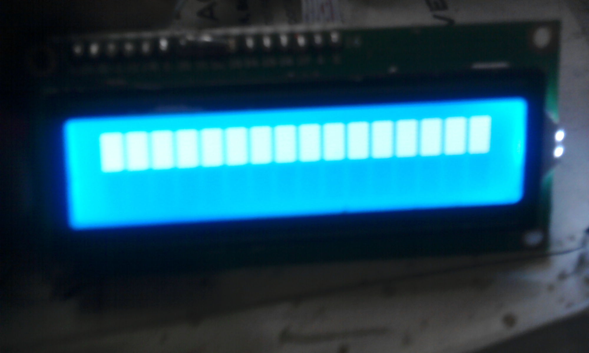

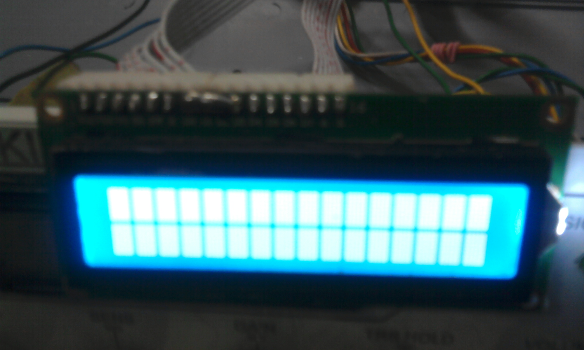

                      • LCD contrast
                        • The fact that you can see the blocks on the screen shows that the correct voltage is being applied for the LCD contrast (pin 3).
                          What happens if you adjust the pot? Are there any characters displayed on the LCD?

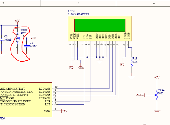

                          • Would you mind showing the full schematic please ?
                            thanks.
                              Hi
                              Sorry No character displayed on the LCD.
                              thanks
                                thanks.
                                Hi
                                Look it
