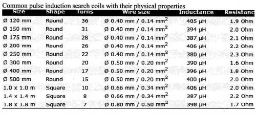

      • Good evening, please , could you provide me with the data so I can build the best 35cm coil for the Delta Pulse I bought from you? I'm currently using my VLF detector at Roman sites and have made some nice finds, but I'd like to go deeper.
        Thanks in advance.​
        hello
        NO DATA was getting from two Bulgarians, they were silent on whole detailed information. just two naked schematics and later layout, that was all we got from the guys.
        so build 500 uH coil of any sorta. must work.
