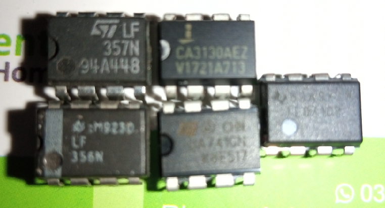

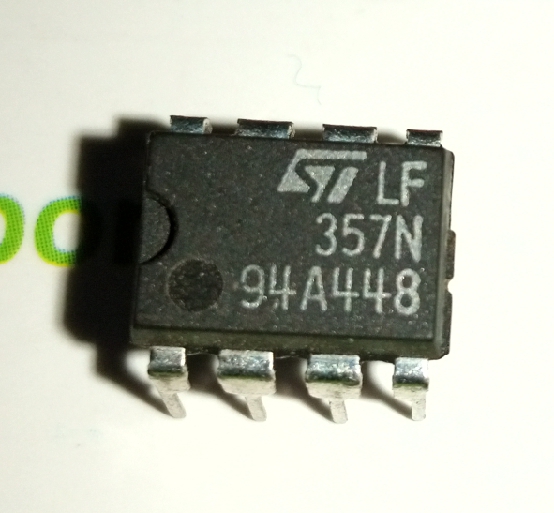

          • Dbanner Here are new 356, 741, 3130 and 357 chips and my old 071 Chip. 3130 is unable to detect anything. The 741 didn't work at all. The 356 worked same as my old 071. With this 357 the tone has become sharper and it's responding to fast moving Target and a very slight improvement in depth. I will put this 357 to oscope soon will share details. Click image for larger version
ID:	356137 Click image for larger version
