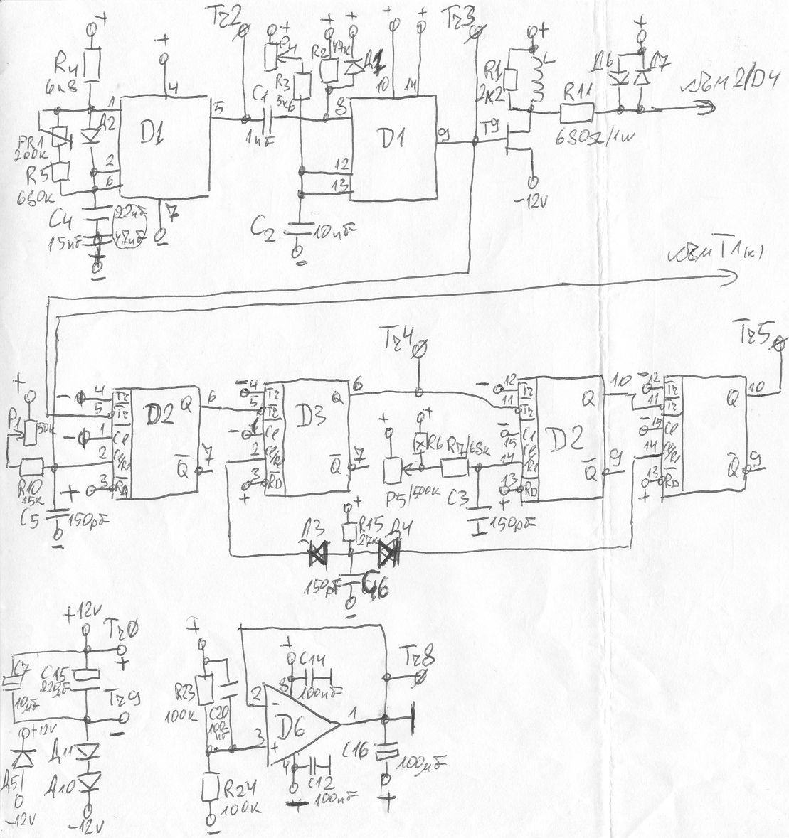

                    Delta Pulse does not needed in additional advertising. Delta Pulse is the perfect working deeper impulse detector released and checked in
                    thousands copies worldwide.
                    This scheme –Delta Pulse is actually German ,, Sniffer XR 71’’. I was forced to make 19 changes to this scheme , to make it work normally, steadily , without nerve-forming behavioral abnormalities…
                    I have removed the unstable work of VCO – NE 555 , I added a buffer ,because instead of a loudspeaker I use piezo from a German phone-wired, from secondary raw materials (scrap) . The sound from piezo is deafening , VCO there is no irritating hysteresis anymore . I realized partial (incomplete ) elimination of the ground effect , consistent (pursuant ) with damping curves of the targets that interest me .
                    By the way , did you not notice,that the integrator does not work normally? I add 2 diodes 1N4148 and resistor 39 killoom, connected in a circuit diode ,,OR ‘’. This makes the detector work much , much better .

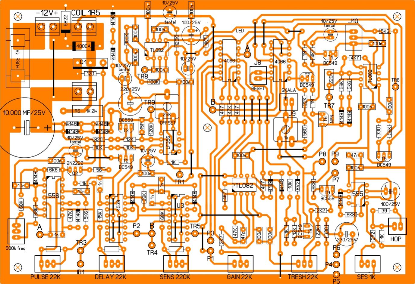

                      • https://www.geotech1.com/forums/atta...4&d=1551150251
                        Please give information, what is the J10 line in this picture?
                        • J10. something the tail of the dog. probably needed thing but does nothing. just hanging to-out out-to up-down down-up.
                          it is a pot TUNE. tune what? ask the modificator for what. yet one threshold pot althought there is one threshold pot.
                          so you see just a dog with the two tails.
