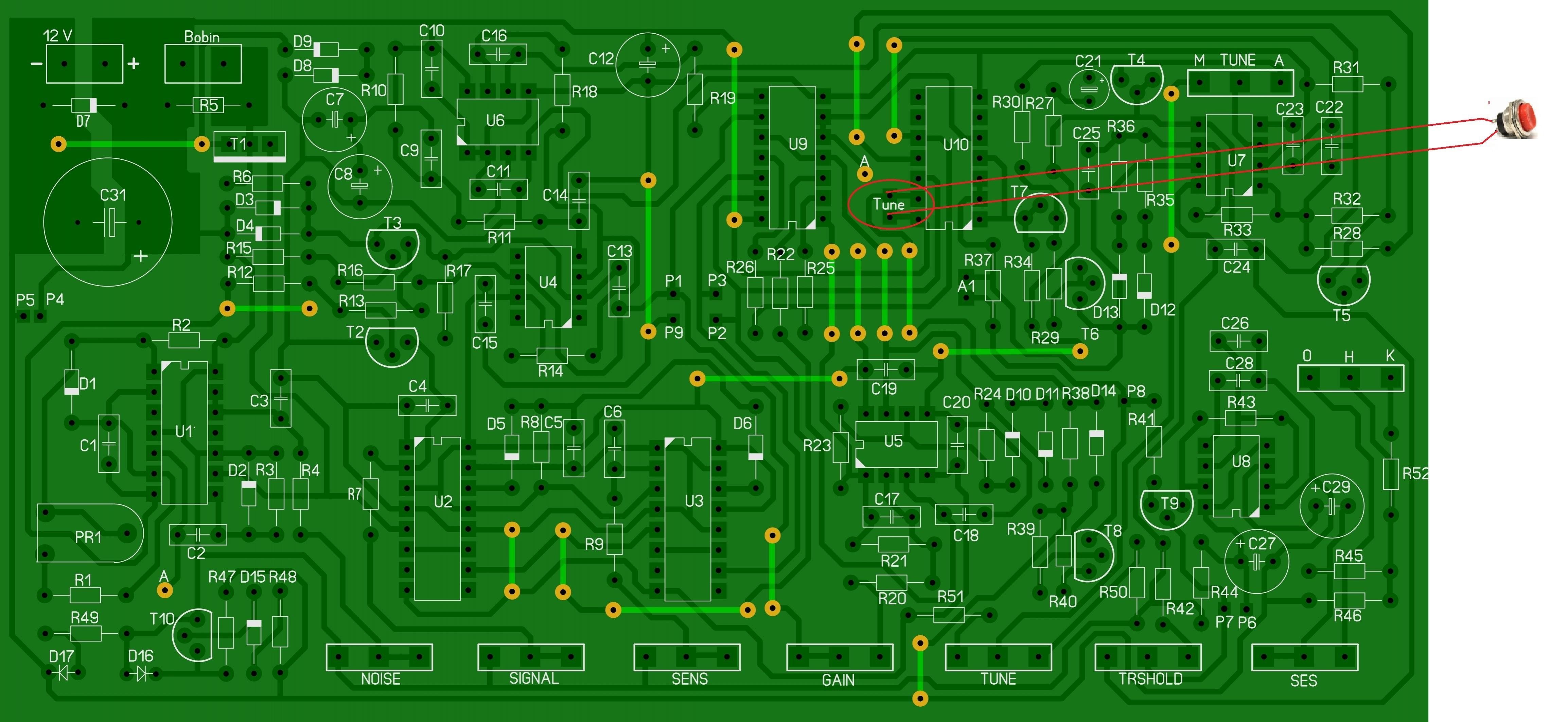

      • lots of closed lines on your board on bottom. i see only problems with your layout.
        • thank you for all. do you think i'm using a wrong pcb?please correct me

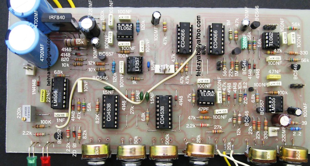

                      • hi for all.
                        I have just finished to build the Delta Pulse2 unfortunately it did't work there's no sound i have only green led lighted .all componenets are tested .please can any one help me to find what would be the problem ?thank you in advance.

                          • new board rev3.1
                            top+top silk
                            • many thanks mr k315.but i haven't pcb for this board. please tell me what is wrong in my pcb? thank you again
                              • your pcb is turkish layout. you have to ask turkish just cause this type of board is unknown for me.
                                check signals in all test points, for first step.
