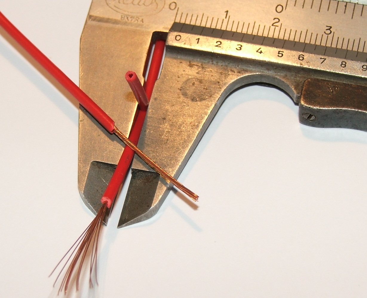

        i can adjust my DP2 in best ( and i will CONTINUE to improve it )
        first i use wire copper , 0.7mm 495Uh and 0.5 mm 450Uh and my result for same coin increase ( 23cm to 30 cm )
        but today i use the wire like under pic , and improve my depth detection in air to 35cm , get best result for me , it is good .
        if i want make 1m*1m coil with this coil , can say me the number of turn it ?
        so i will increase my damping res to 1.5k maybe it is better .

            • sens pot is not on max position. may be 7...8.
              threshhold is in middle position or near middle position, tune it at start. remember DP has advanced autotuning (SAT - SELF AUTO TUNING), so futher
              do not touch thresh because not need.
              thresh perhabs seems working something strange... but further as you will more learn you will fell that thresh pot is unwanted... perhabs
