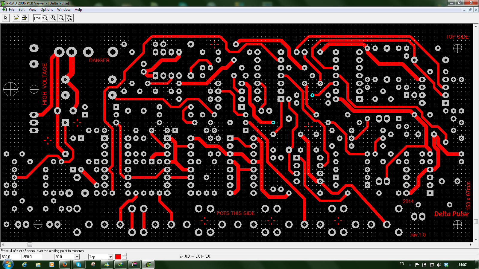

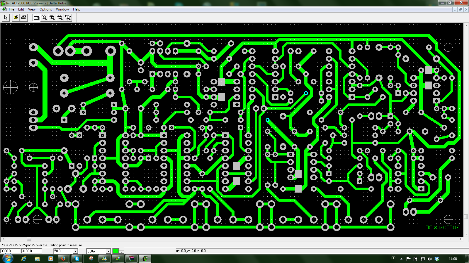

                    • hi nicolas
                      can i use #2324 for this new DP design ,
                      again thank you kt315.
                      when i finish the second i put my result.
                      EDIT:
                      oh , yes i can use it
                      just tell me about the RX values .
                      regard

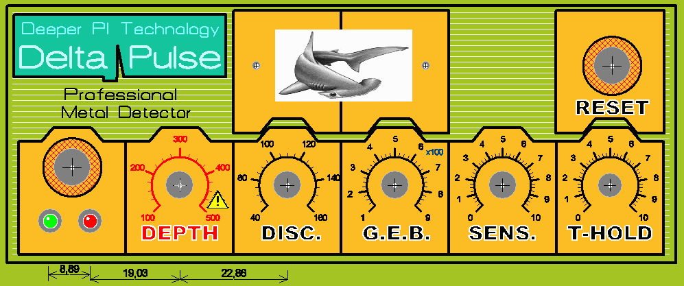

                      • can anybody write a due bottom size diameter of the knob?
                        http://www.ebay.com/itm/5-x-Grey-Kno...d#ht_762wt_894
                        i mean you would measured the precise size, in 0,1mm of accuracy, do not write that it is 15mm.
                          hi nicolas
                          EDIT:
                          regard
                          Yes you can use it
                          The value RX depend to type of LCD. Use pot 10k to calculate the exact Value
                          Look for Pulse 2 DP 2 in forum. I dont know where it
