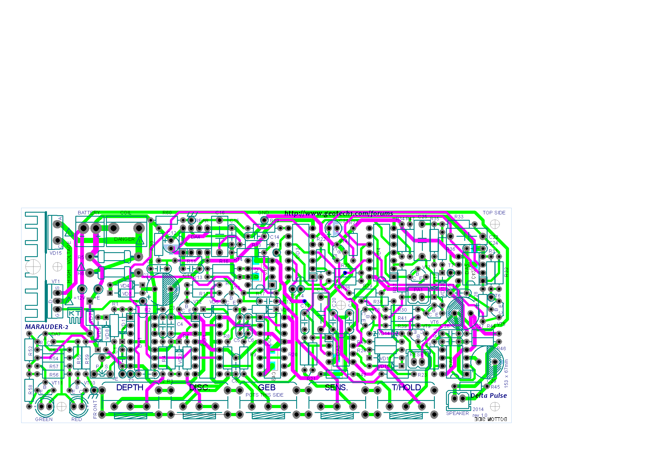

      i use ne556 instead of lm556, i have 80mks and perid of this on ne556-5 is 2.5mks ( not 10ms)
      and i get in ne556-9 350hz but the it is 17mks not 100-500mks
      so ne556 have more DIFFERENCE to lm556 ???
      • no difference. they both are same.
        increase C1 and/or R1 value
        increase C3 and/or R4.
        VERY seems your nominals of componets ARE WRONG and you DO NOT MEASURE ALL COMPONENTS BEFORE SOLDERING
          thanks my delta pulse work but i need to find best adjustment Mr Kt315,for all Tp points .
          my coil is 21m 0.7wire 495mkh.
          • all adjusments will be get automatically. DP was projected for fully dumbs, for a kitchen home worker female. DP has only one (ONE) pot for adjusment - P.P.S.
            tune 120Hz for US standart electrical net and 100Hz for EU standart electrical net, this decreases the interference.
              ok i will set pps on 120 hz.
              • hi dear KT315
                i finish that detector and work very good.
                but i make turkey board , please put it here for me your design (on board and under board, your pcb my means )
                thanks again and best wishes.
                • hi Mohandes, have you P-CAD 2006 installed? I could put a file in it.
                    hi
                    i have P-CAD2002 ,if can not open please put here pdf file( original size of pcb ) and another explain.
                    regards.

                    • here .PCB file. I cant say it will open in P-CAD 2002 or not...
                          many thanks
                          i will make another
                          hmmm , i think you make difference dp2 , and I hope it is work . ( are you make it and test it ???)
                          about the DVD all banks are boycott so i should going to in EXCHANGE STORE to pay you, i will again try.
                          best wishes
                            hi, it is strangely. version at pic
                            [ATTACH]27286[/ATTACH]
                            Yes thank you Kt315
                            I managed to open it. A true outline
                            I wish you good luck
                              hi all
                              i finish dp2
                              please say me the connection lcd to main board

                              Hi Mohandes I recommend you to use the other type schema for descrimination

                              • Good evening..
                                I have designed pcb individually all departments separately for experimentation. believe that this is easier for an improvement and research..
                                if desired to publish ??..
