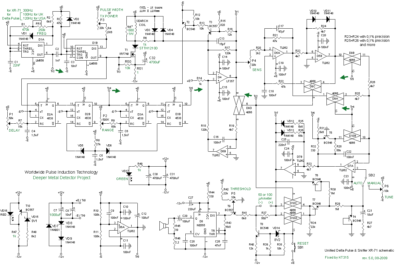

                          • schematic was been fixed according last offers
