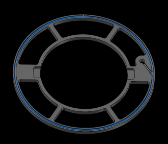

    In the end, after testing, I built a 12" coil and I'm happy with the result.
    To protect the coil I have seen that aluminum is used, the shielding should not be completely closed if there are no problems, am I right or does it have no influence on a coil of these characteristics?
    Is there anything to keep in mind before closing the coil and applying epoxy?

    • while you do coil for DP you must think you can use the coil in future, on another type of detectors. with more short MAIN DELAY.
      so you must do right from start FASTEST coil, not trash one for your garbage basket.
      so i NEVER suggest to do coil with foil. i also do not SUGGEST applying epoxy. you have to do fat AIR jacket between the winding and epoxy.
      how? take a rope, wind it around, after wind scotch tape, in two layer, against spilling of epoxy in the rope. you will get air gap in 3-4 mm.

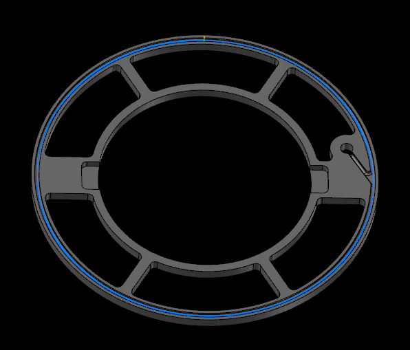

      • It's okay, I understand.

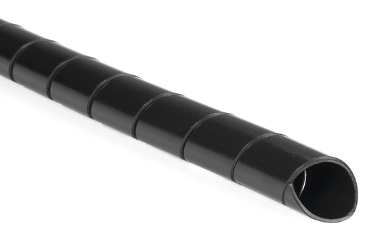

        I had thought about putting a helical cap on it.
        And then it occurred to me not to fill the coil with epoxy, to solidify it completely and make a slot to insert the helical cable and seal it with thermal silicone.
        The blue line is the cable with the helical sheath, this way I avoid filling the entire coil with epoxy and close the 4mm slot that the cable has with silicone.
        The coil material is nylon.​The coil is manufactured on a CNC machine in one piece with a slot for the cable.With a thickness of 10mm it has a weight without cable of 220 grams.
