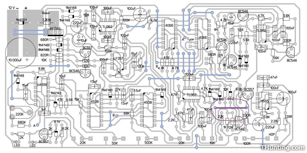

                    • Your PCB is correct? Why there is a negative patch element
                      • KT315
                        • Originally posted by liudengyuan View Post
                          what element you mean? my PCB's are always correct. no obligatoriness to be worry.

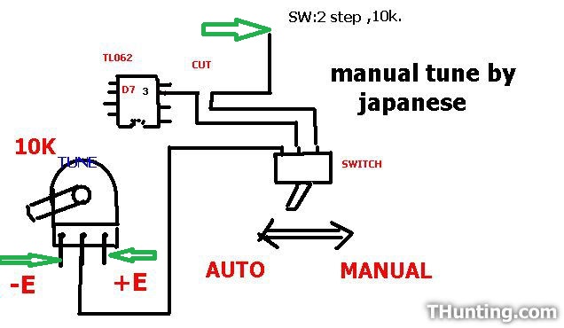

                            hi all
                            I want to make the tune for delta pulse.
                            what is the location of arrows?
                            thank you for help
                            • make. your right. but what you hope to get? in my opinion i do not see something effective in your 'manual tune'.
                              • make
