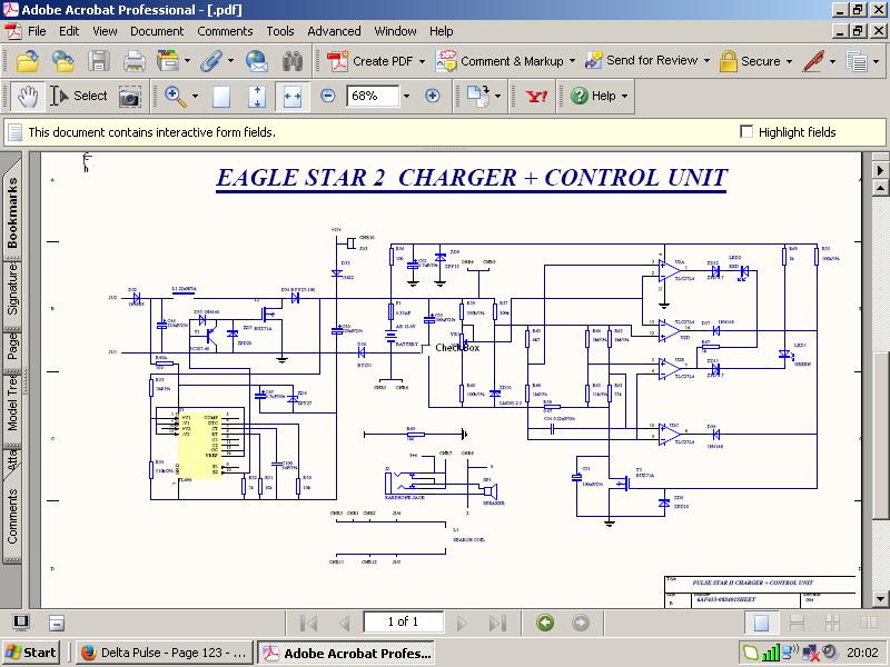

Delta Pulse
ID:	345715 how there is no scheme PS- 2 !

      • Hello! I made Delta Pulse detector(I used KT315 designed board), made test coil(12 cm diameter and 36 turns of 0.4 mm wire). I got constant sound from speaker, but no reply to metal objects, when i connect oscilloscope to the testpoint T1 in schematic(output of the preamp), I can see there reaction to metal objects. I also checked T3, T4 and T5 with oscilloscope, these were ok. What should I get at T6 and T7 and what should I check?
          • did you buy the pcb from me?
            • No, but it was made using your files.
              • on a spot R37 R41 you have to see a level slight low than zero with some low freq noise.
                then bring a metal and you have to see encrease of the level above zero volt.
                              Now the detector is working, there was just a stupid mistake- one IC wasn't installed properly.
