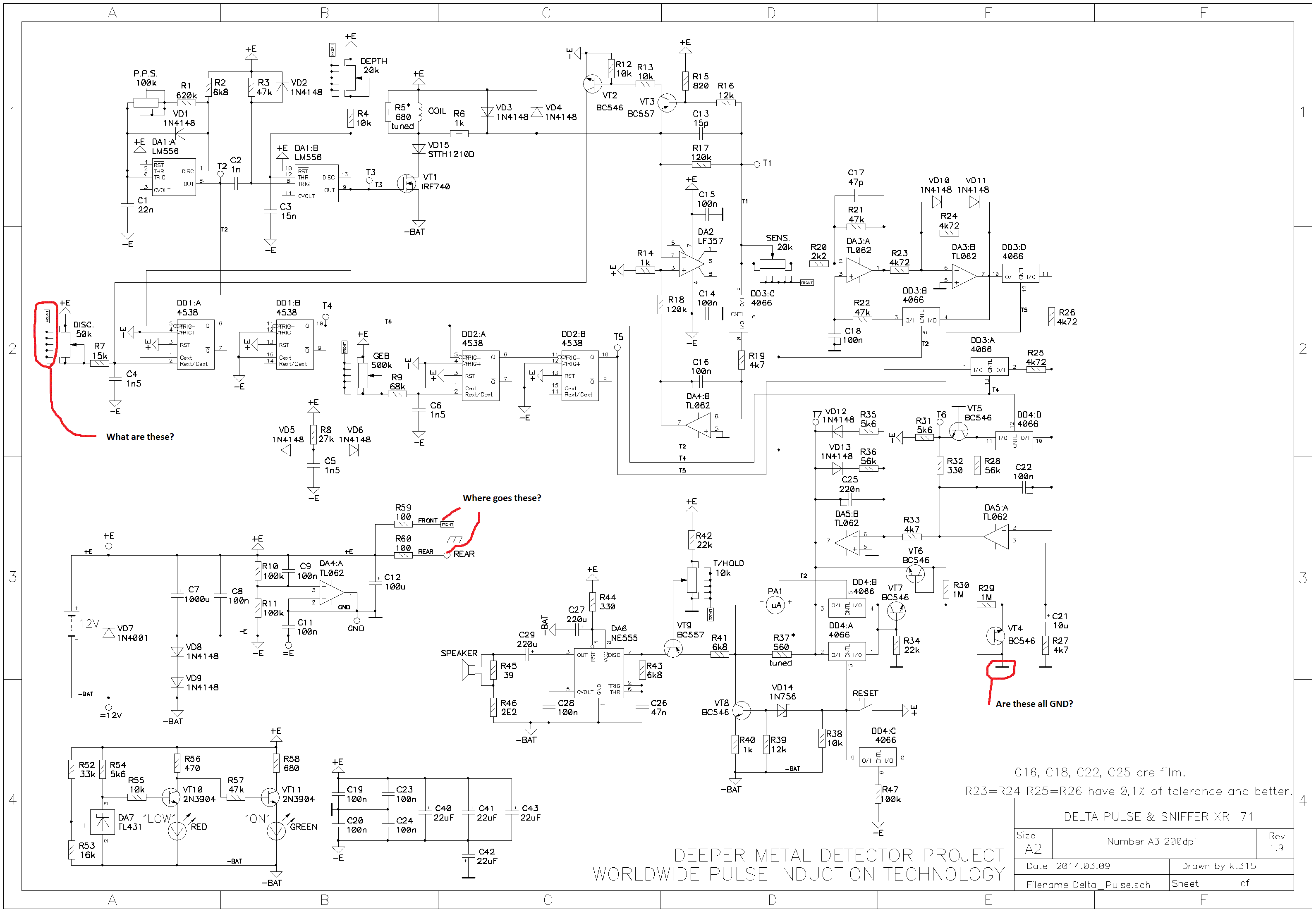

                  Hello, I have few questions about Delta pulse schematic(they are in picture).
                  • 2A - some kinda 'universal set place for many types of pots'. ignore them, it was need for P-CADing. those pins are mounting holes at pcb for the pots.
                    3C - points for to connect the wire to housing shielding layers.
