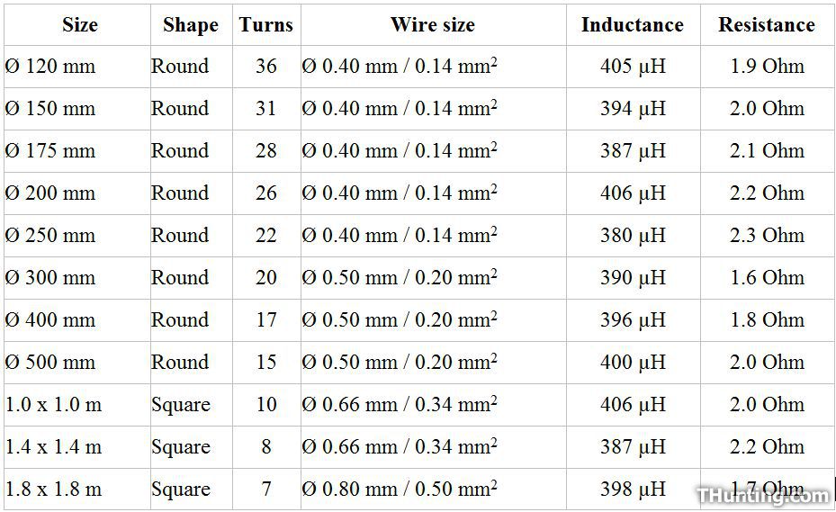

                  • Here is a table for 1mx1m coil, as the coil gets bigger the size of the wire gets bigger, but the number of turns reduces.
                      Thanks 6666... it is very useful for me.
