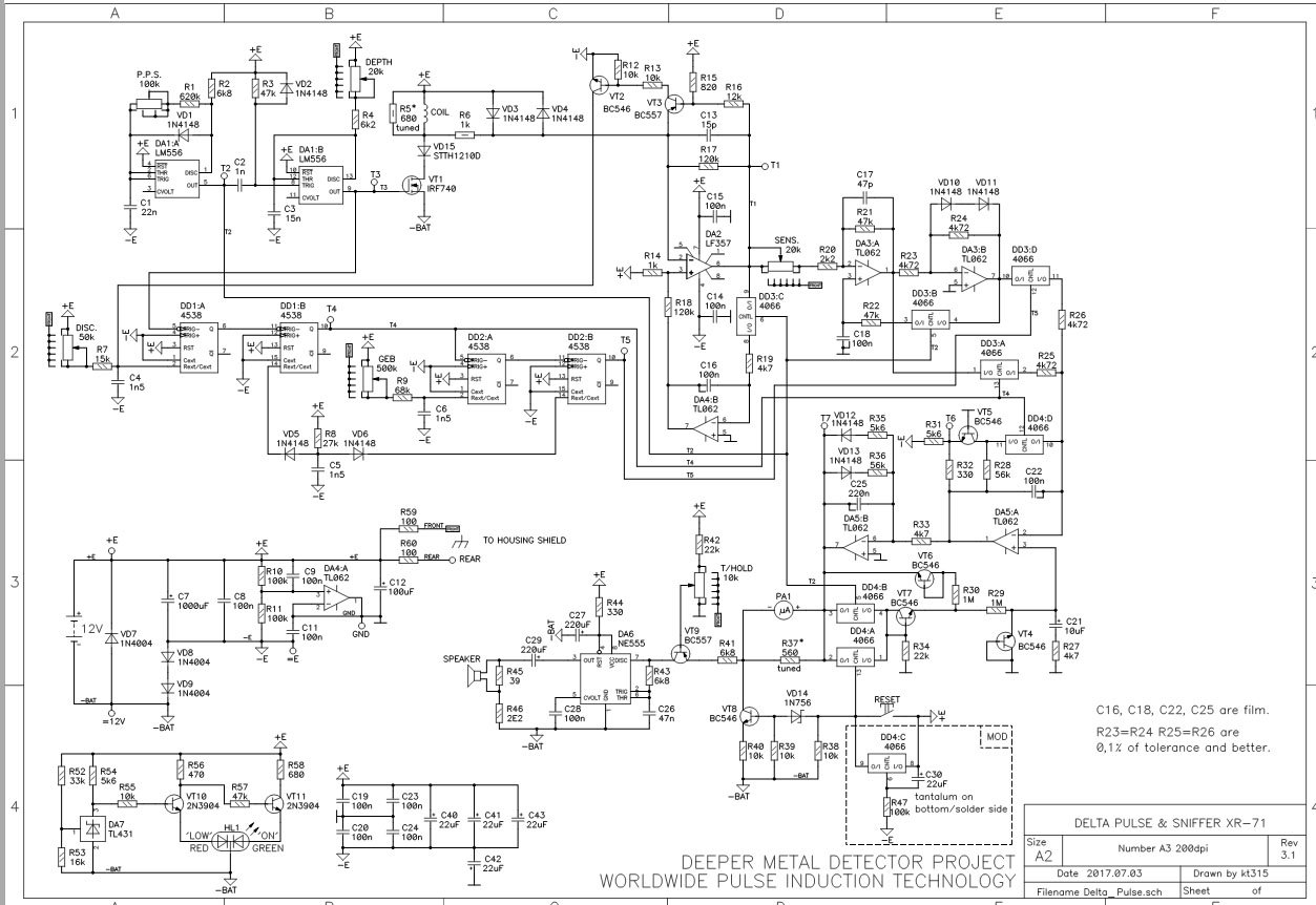

  • thank you very much mr kt315.please can you give me the (shematics +pcb for new board that you post .it seems to me easier tham i'm working on.
    • This is the second time that Ibuilt this board but it didn't work it cost so much in vain.
      • see clipped 'delta' impulse on output of opamp, LF357, by o-scope.

                maybe you need connect a coil?

                  • thank you mr k315.but when i connect a coil irf 840 getting very hot .what is wrong?
                    • no voltage supply on IC's. diodes VD8 VD9 burned.
                      • schema new

                            schema new
                            [ATTACH]40006[/ATTACH]
                            What's new in the scheme? Two LEDs are united in one double. I do not see another new one.
                            • the schematic is same left. new -
                              -- you can set 2 LEDs or bicolor one
                              -- sockets were changed on another 'pops screw style' type http://www.ebay.com/itm/50pcs-2pins-...gAAOSwpLNX~Lut
                              -- grid poligons, cause was hard to desolder in some places
                              -- transistors' position in voltage indicator was fixed
                              -- general optimization
