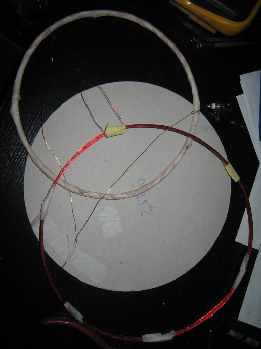

    thanks ivconic,
    I did same coil like you, i wound 30 wind. on 20 cm , o.4mm wire, but not equal performances. i tried a 18cm coil with 40 wind, 0,6 mm ; same depth but very good sensibility and good sound with small coins. If i remember, resistance is about 3,8 ohm for 20 cm coil, i haven't inductance meter but i project to build one...
    5 cents euros : ~15 cm
    50 cents euros : ~20 cm
    2 euros : ~25cm

          ... and my previous deltapulse coils... ... because no great depth like ivconic..

            • With 20...25 cm coil you must detect a 2Euro coin at 30 cm and a soda can (330ml) at 70..75 cm with good stability. But DP is an excellent low frequency metal detector for large objects. For small coins there are other PI detectors better than DP.

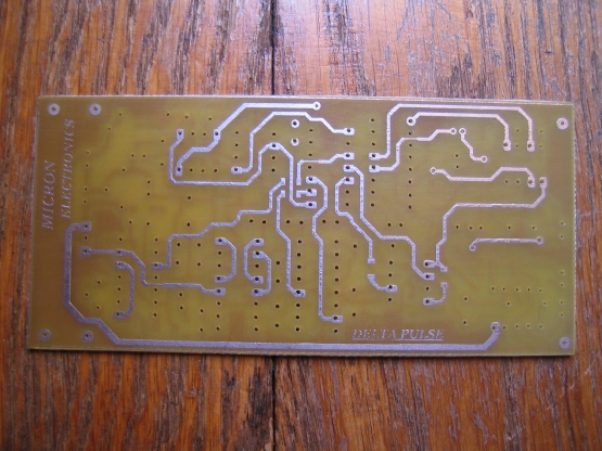

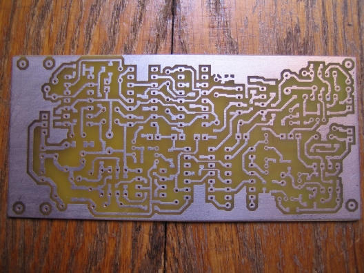

              BTW you made very good pcb's

                thanks géo,
                not far from my home I have several stores of components, I have the choice. I make manufacture the pcb on the Web for a few euros (about 13 euros). I do not do sufficient circuit to buy materiel. it is more economic to make them realize by somebody else. I do not have to test my deltapulse yet on the ground. I have make the tests of detection at home, and there is many metal a little everywhere. Perhaps that I will have better result outside...

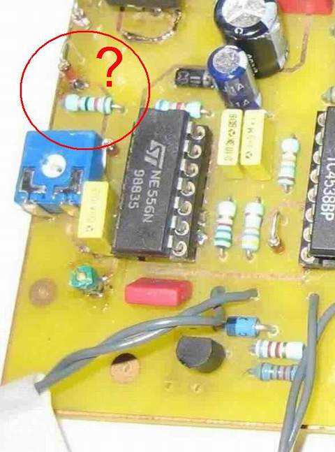

                    DAN129, what is value of this resistor you put on your DP?
                    I can see quite different colors than expected!?
                    regards!

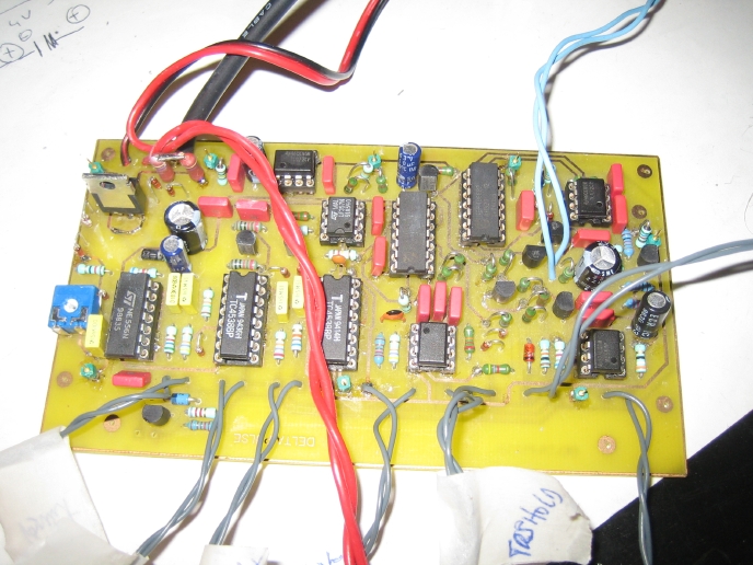

                      Hi Ivconic, Geo or anyone that can help.
                      First of all, happy new year to everyone.
                      I had re-checked mi delta pulse circuit, and all seems to be working, but still no sound.
                      A measure fequency, it running from 400 to 650 hz.
                      A measure EMF, it get strong signal when i raise noise potentiometer.
                      When i disconect the power you can heard a fading and short sound.
                      Some times when you apply power to the unit, you can heard a fast cliking tone that is going down for a couple of seconds, until stops cliking very slowly.
                      For me it seems that the circuit is working, but it has something wrong with capacitors.
                      For example, almost all mi electrolitics capacitors are for 16 volts, specially C27 (220uF, 16 volts) I took a look to the pictures of other DP circuits, and i compared the size with mine, wich looks phisicaly small than the others projects.
                      Sorry, but i not very skilly on electronics.
                      In advance many thanks
                      Nelson
                        regards!
                        hi ivconic,
                        I tested increased frequency of the DP by modifying R1 or PR1. With PR1(200k)+R1(680k) you can turn PR1 to have F = approximately 99 to 150 Hz roughly. If one decreases the value of R1, one increases the work frequency of the deltapulse. The problem it is that the coil of detection starts to whirr. I dont' remenber the value i soldered, i'am at office. bye

                          verify these values of component. while turning PR1 you should vary between 90 and 150 Hz. Perhaps the problem does not come from there, but starts already with this checking. with such a raised frequency, the coil should whirr
                          PR1 = 200 k or 220 k
                          R1 = 680 k
                          C1 = 15 nf
                          R2 = 6,8 k
                          NE556, i don't use LM556
                          • R1=???
                            :confused:
                            "With PR1(200k)+R1(680k)..."
                            I know this. On your picture R1 does not look as 680K.....not even close?
                            Not even Kohms....but in ohms??? Or picture is not clear enough....blur?
                            Anyway, regards!

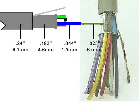

                              Thanks Ivconic for advice on building PSII universal coil,
                              I found this wire quite cheap (US $0.50/foot). It is 12 conductor wire. Do you think it will be suitable?
                              One more question: what to do with the aluminium shield wire? Is it to be connected to one of the terminal wires?
                              Thank you again,
                              Bob
                              • Yes!
                                Yes! To ground. In this case GND is +pole....althought there is digital ground on pcb....i am wandering about it? I never used f.cage,since my previous devices worked on low freq. and i made only large coils so far...
                                It is good question! Where to connect shield??? On +pole or to digital ground?
                                Any ideas?
                                Geo?
                                :confused:
