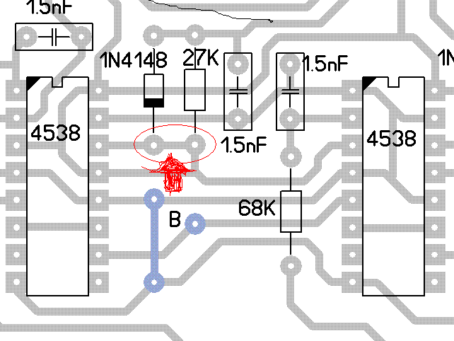

          • small error
            Dear Friends
            I find a small error on delta pulse part replacement diagram that I send
            please careuful about this and correct. there must not connection beetwen 1n4148 and 27 k I attached picture.
            Somebody make error when copying from original.
            you can see original files at http://www.savefile.com/files/1018088
            and http://www.teknolojiekibi.com/yeni/index.php?topic=4.0
            Best Wishes
            Erol

              • I DIULDED PALT PULSE ONE SIDE
                Hi all
                i builded it but i have problem.
                first i say that i dont have osiloscop and i cant see frequency .
                and while that i turn on the design coming sound like siren after 20" then silent and then siren and .....
                of course whithout coil.
                i want know that my design is right or wrong.
                by thank.
                i am sorry for bad english
                • hi
                  I faced same thing with you I solved it,but I dont remember how.
                  I said my friend wrong connection above post And he said his delta workinng
                  now. 1 euro about 35 cm.
                  But my delta worked 1 time but İt is not working after I changed coil.
                  I can not find problem.
                  But this design is working.
                  Always 1n4148 burning near IRF840.
                  I find 2 transistör burned
                  but not working now
                  Best Wishes
                  Erol
