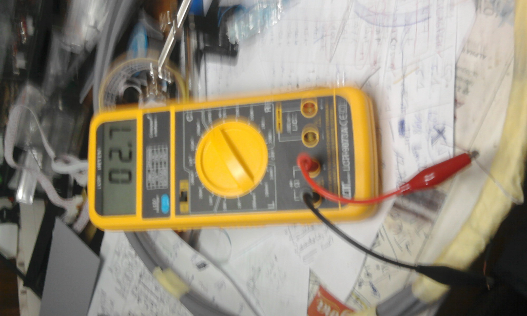

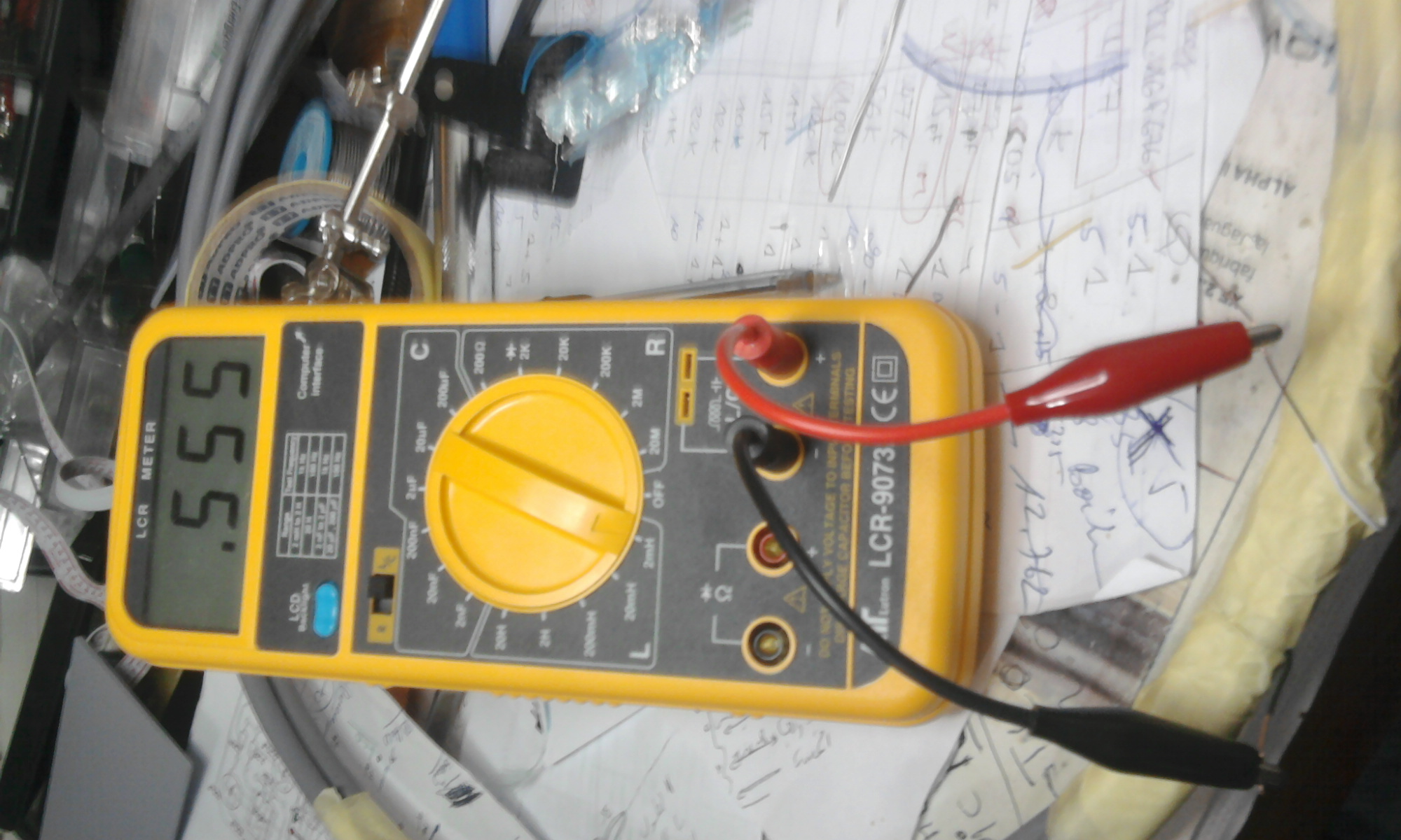

    I used cable 8x0.5 mm, 3trx8 = 24 tr , R=2.7 H= 0.555 mH
    It work good now.
    What do you think? of this result box coca cola detected at 25 cm
    What is the nobre to turn for framework 1x1m with this type of cable?
    Thx for your help and knowledge

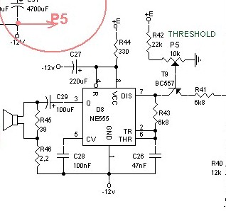

                    • Hi Jap
                      I use a 0.8 ohm 1w speaker but the sound is low
                      I can change it with another 0.8 Ohm 0.5W
                      or I have a problem somewhere
                      I need your help
                      Cordially
                      Nicola
                      • Hi Nicolas
                        -Leave the speaker 8 OHM as it is because it is better.
                        -Be sure that your speaker is connected between the two pin 3-2 in J2(IN DP2).
                        -Be sure VOL=100 OHM=1K POT,R46=2.2 OHM
                        -To be safe change C27,C29.
                        best time
                        j.

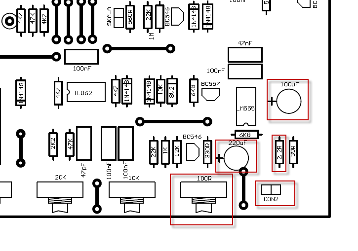

                          Hi Jap
                          My connection is correct and my component
                          electrolytic capacitor 100uF and 220uF 50V the R46 = 2.2K
                          I use this PCB
                          But I have this problem
                          • Hi Nicolas
                            -Tested and check T9,D8
                            -Tested all the components and value in its place ,like r44=330 ohm,,And so on.
                            best time
                            j.

                            • Originally posted by jap View Post
                              Hi Nicolas
                              best time
                              j.
                              [ATTACH]21908[/ATTACH]
                              Hi Jap
                              I tested all no note all values ​​are correct
                              I have not managed to locate the problem
                              But with the headset is good it works
                              I think only replace the Cap 220uF 50v by another 35V
                              Thank you same as
                              • Hello everyone
                                because these days I have time to spare I decided to help a bit in making KT315 PCB PCB work the first time and do not forgive if I did something stupid. I hope to finish the kit today and if you have any objections please say to make it right. I think KT315 will criticize me a lot because I play his mounting interfaceClick image for larger version
